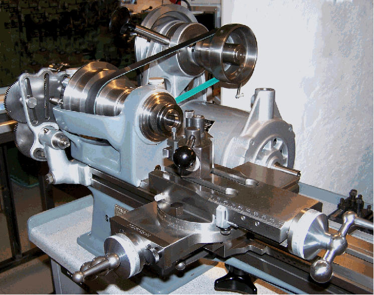

Pictures of the beautifully-engineered power-feed and screwcutting attachment that drove the top slide - an accessory available for most of the plain-turning Model 70 and Model 102 lathes.
Schaublin 102: the 3-slot bracket carrying the changewheels was bolted into a T-slot running down the front of the bed. In this picture the universally-joined shaft to the top slide is not fitted.
Schaublin 102--changewheel bracket in place
102 with screwcutting/power-feed attachment removed
102 changewheels in a compound train on their mounting bracket
The complete changewheel set
Schaublin 70 with one version of the makers screwcutting and power-feed attachment in place
