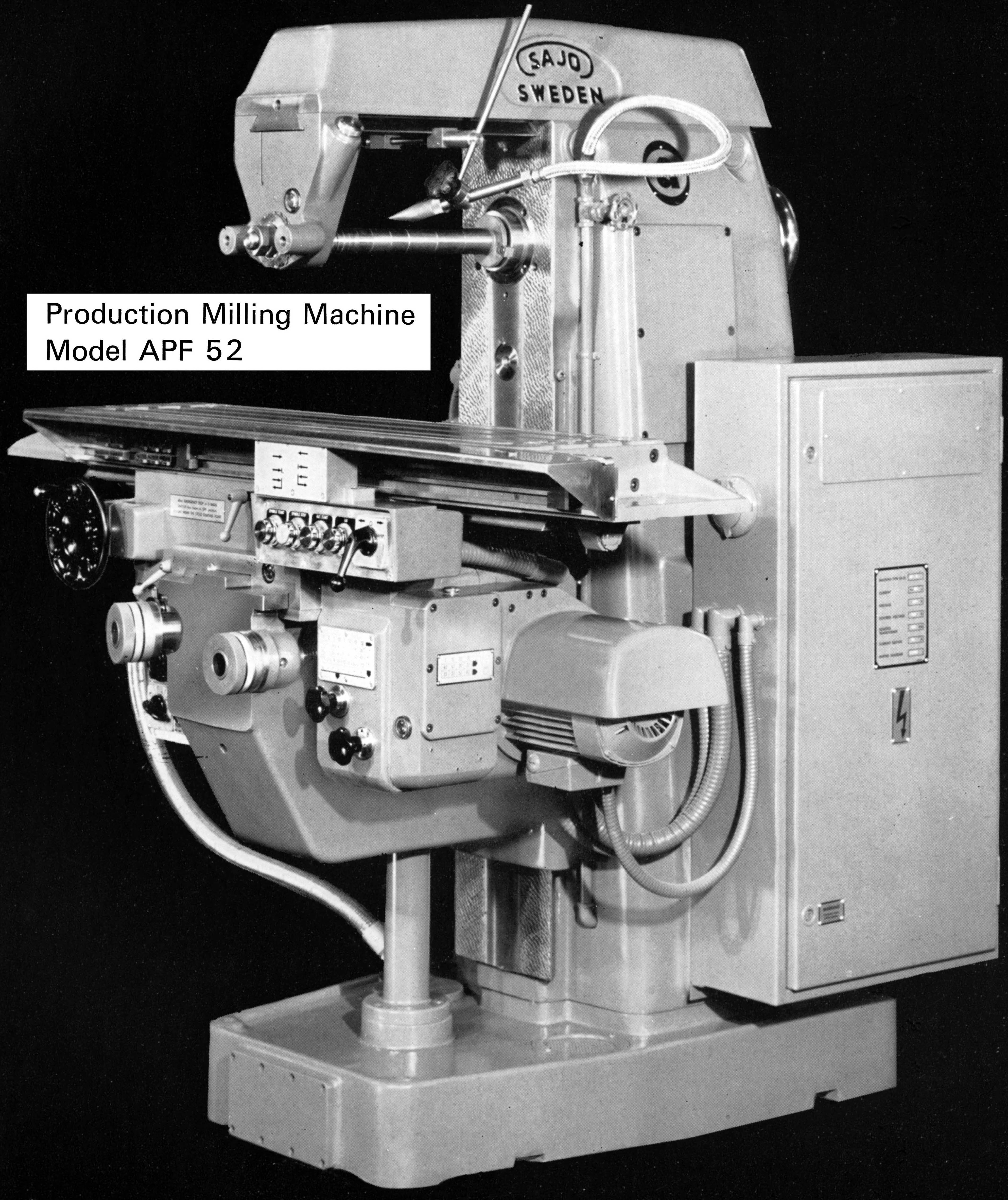

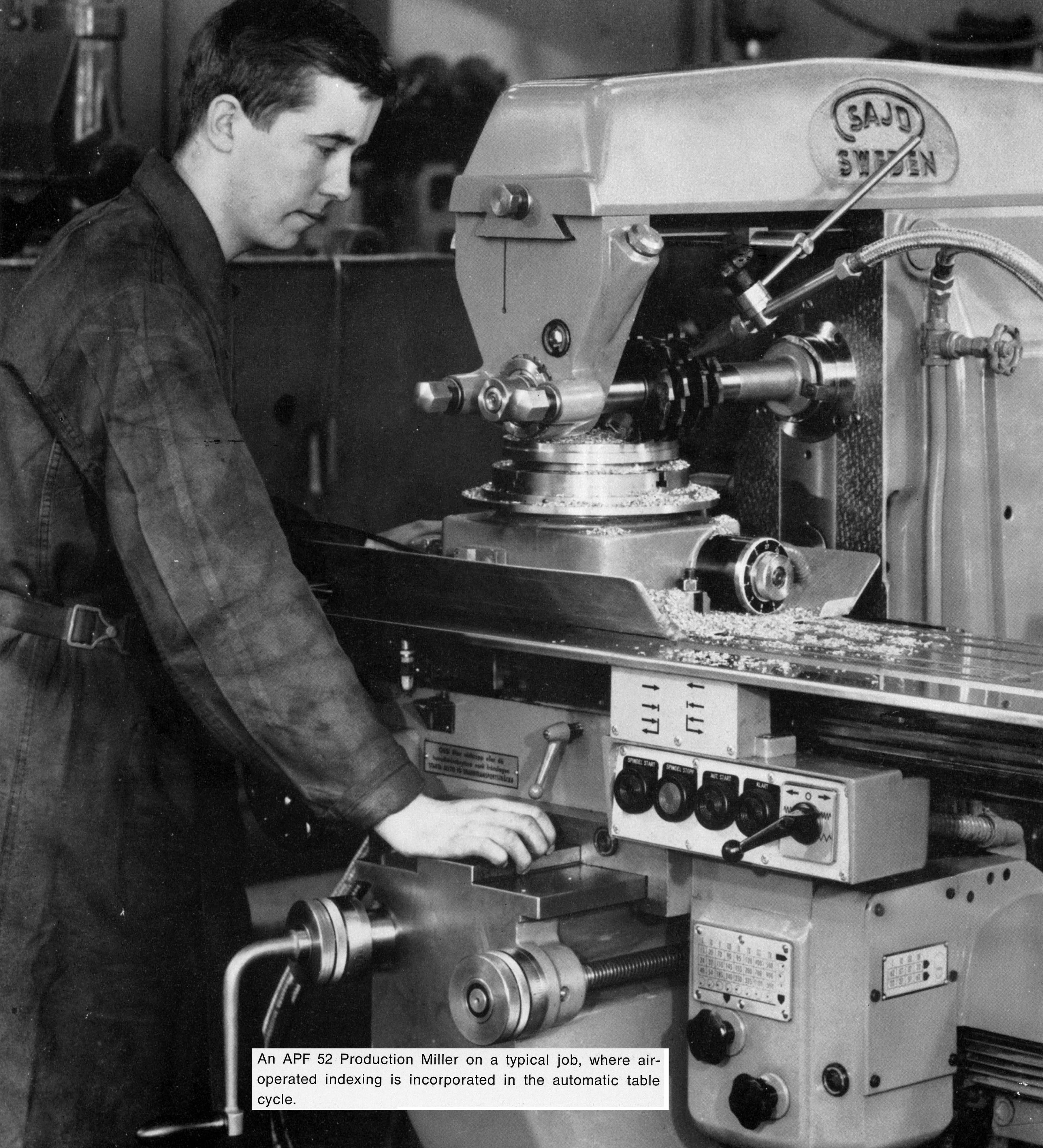

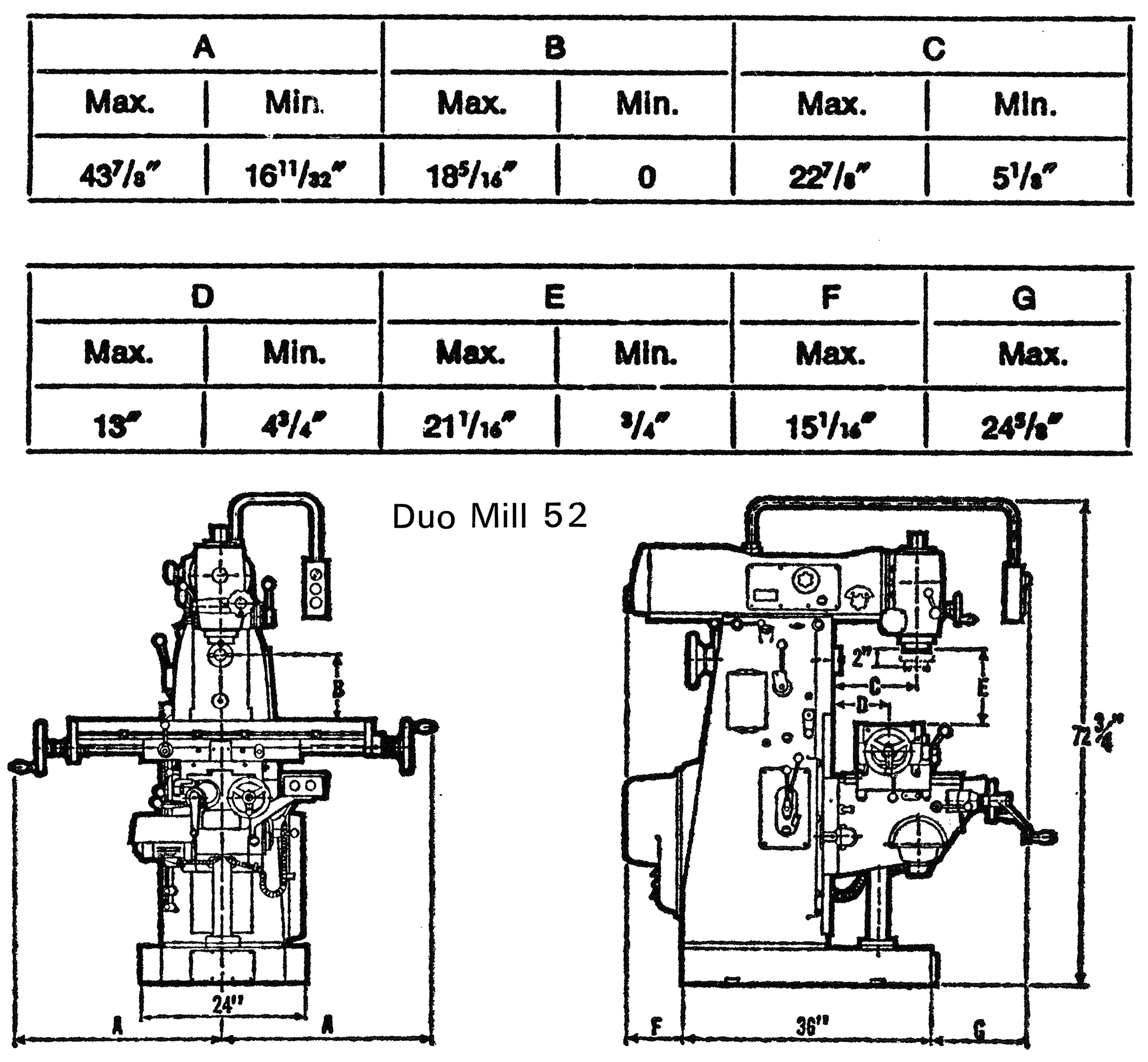

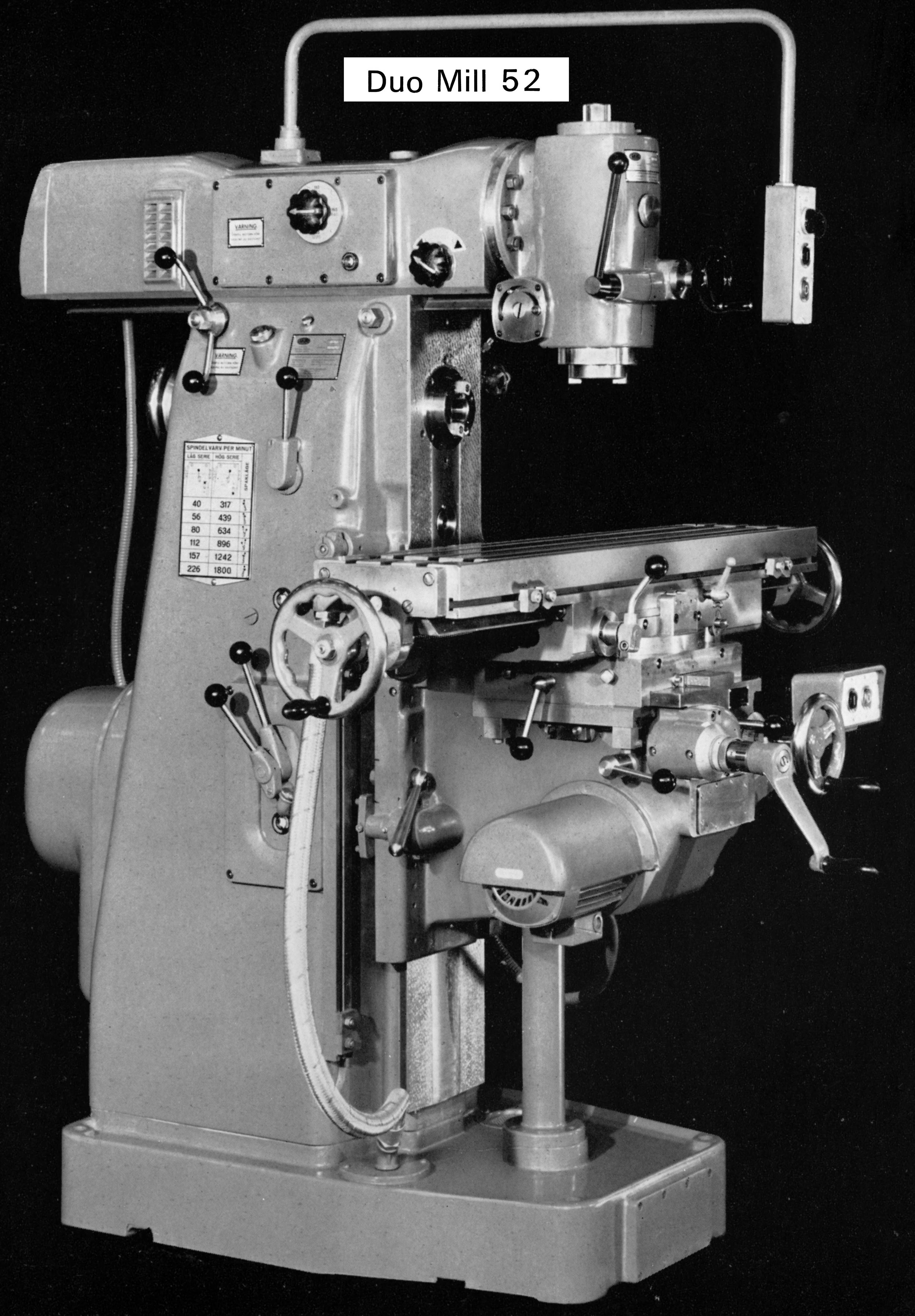

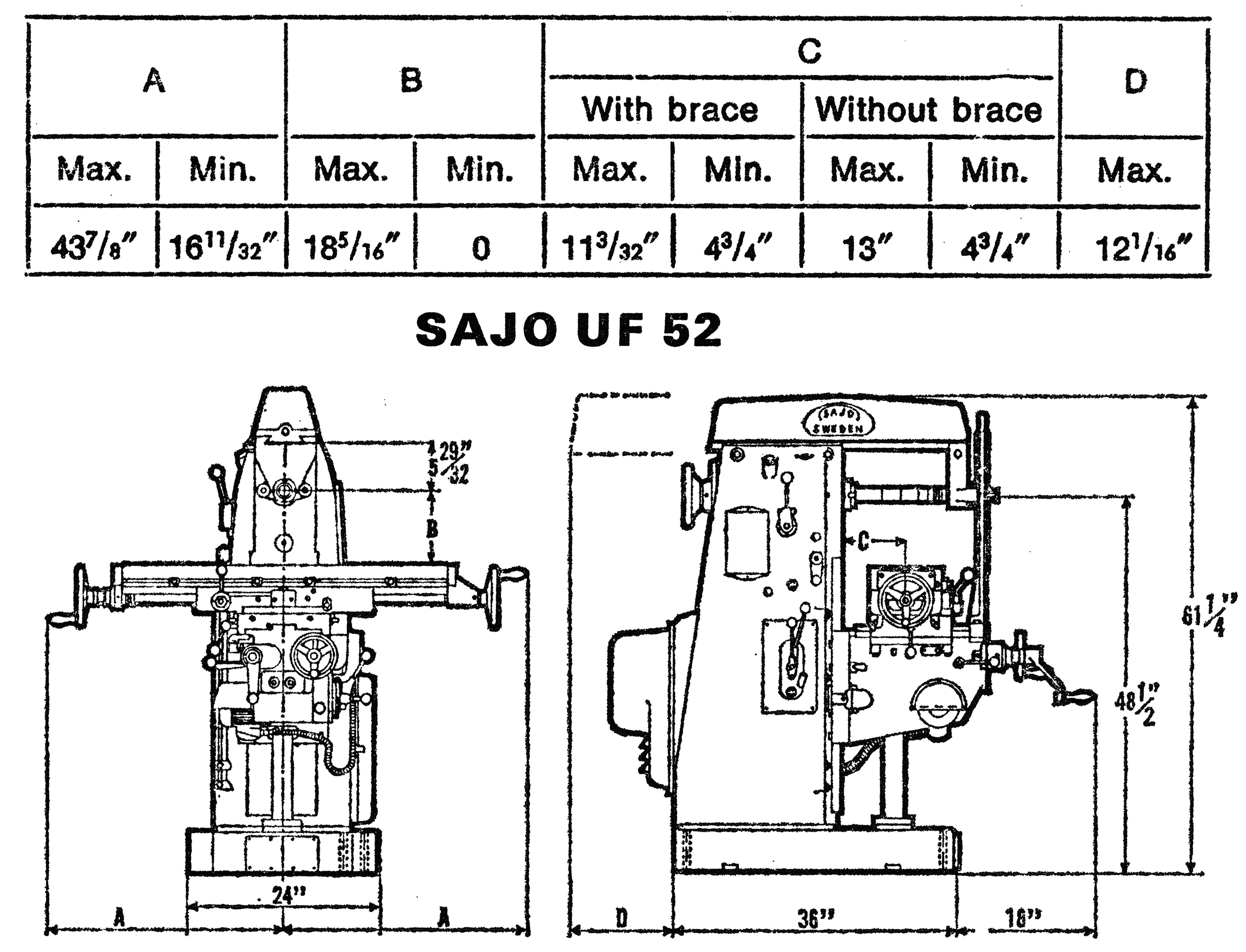

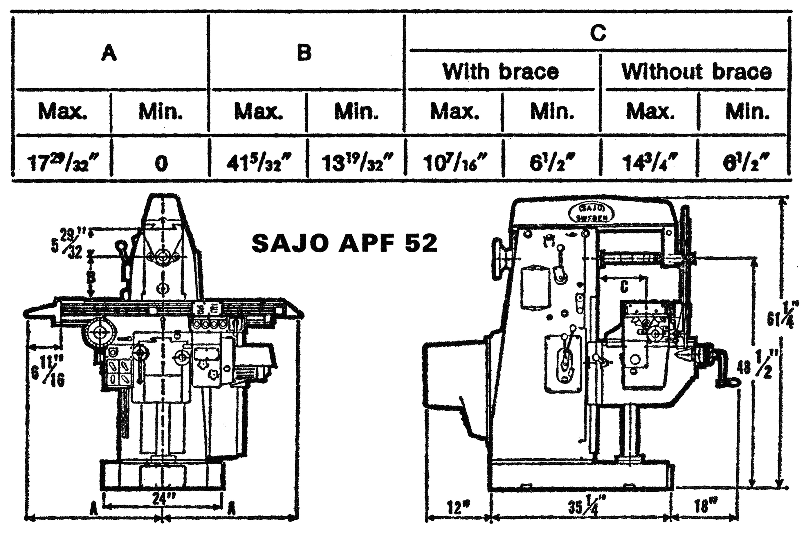

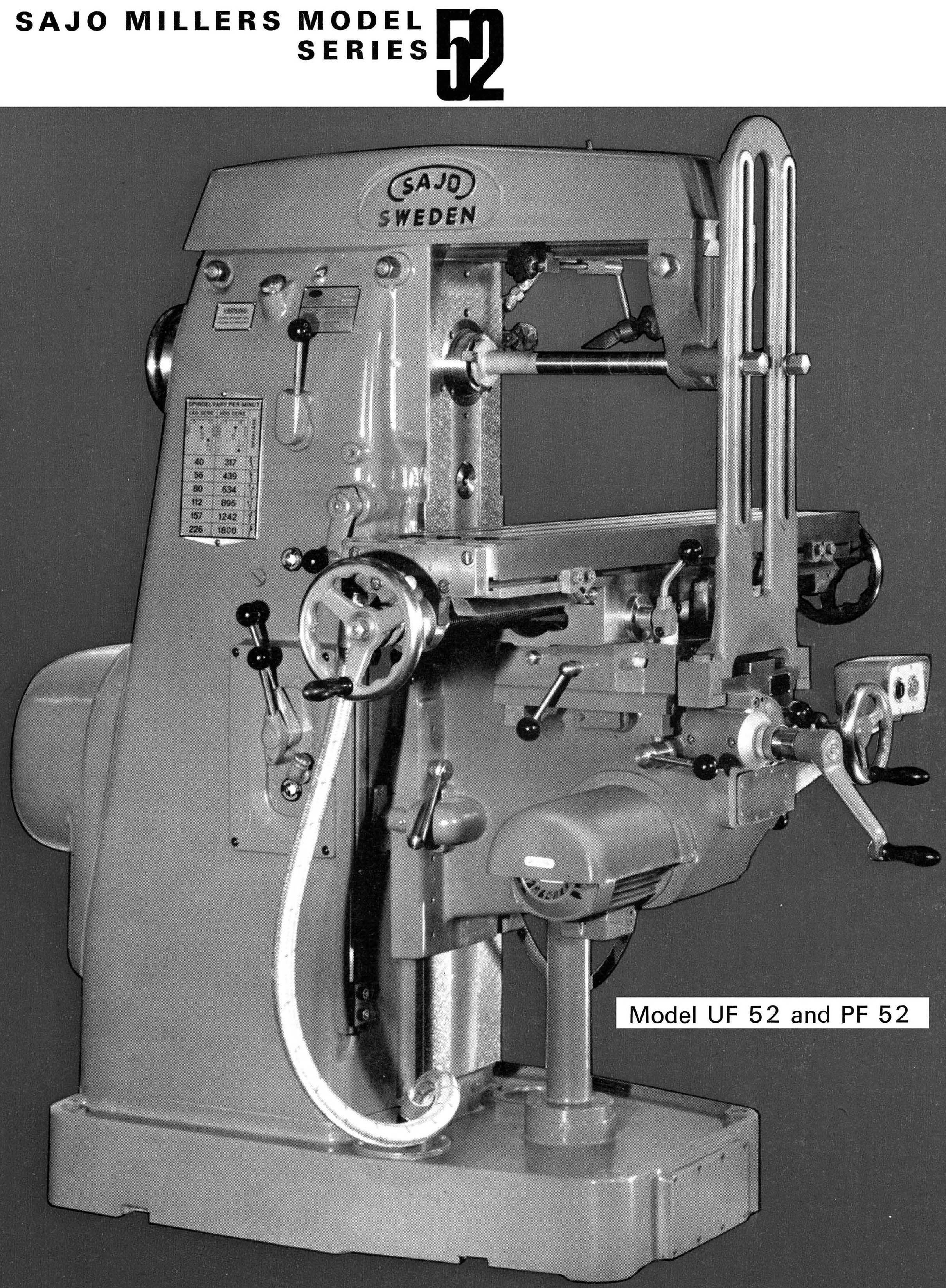

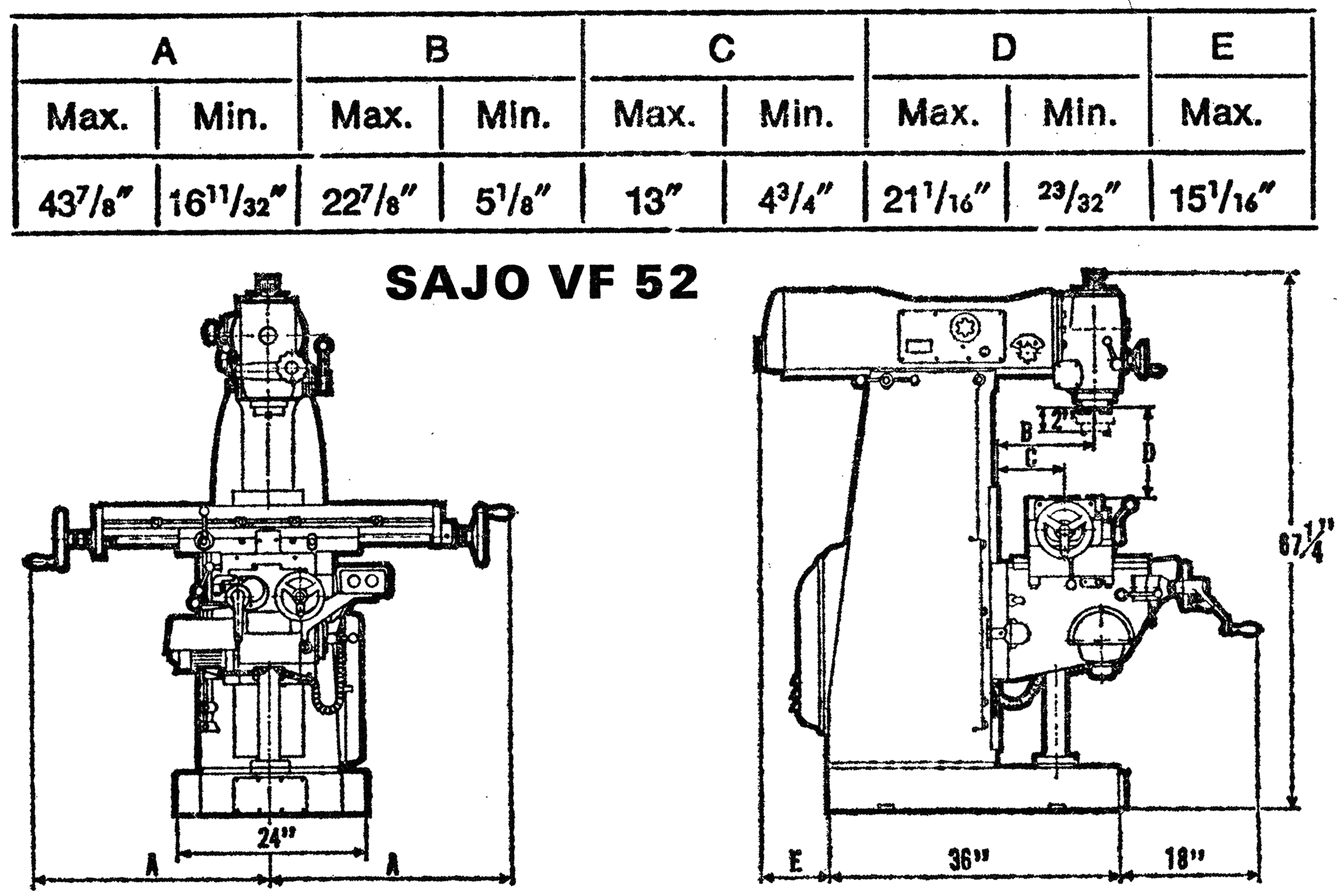

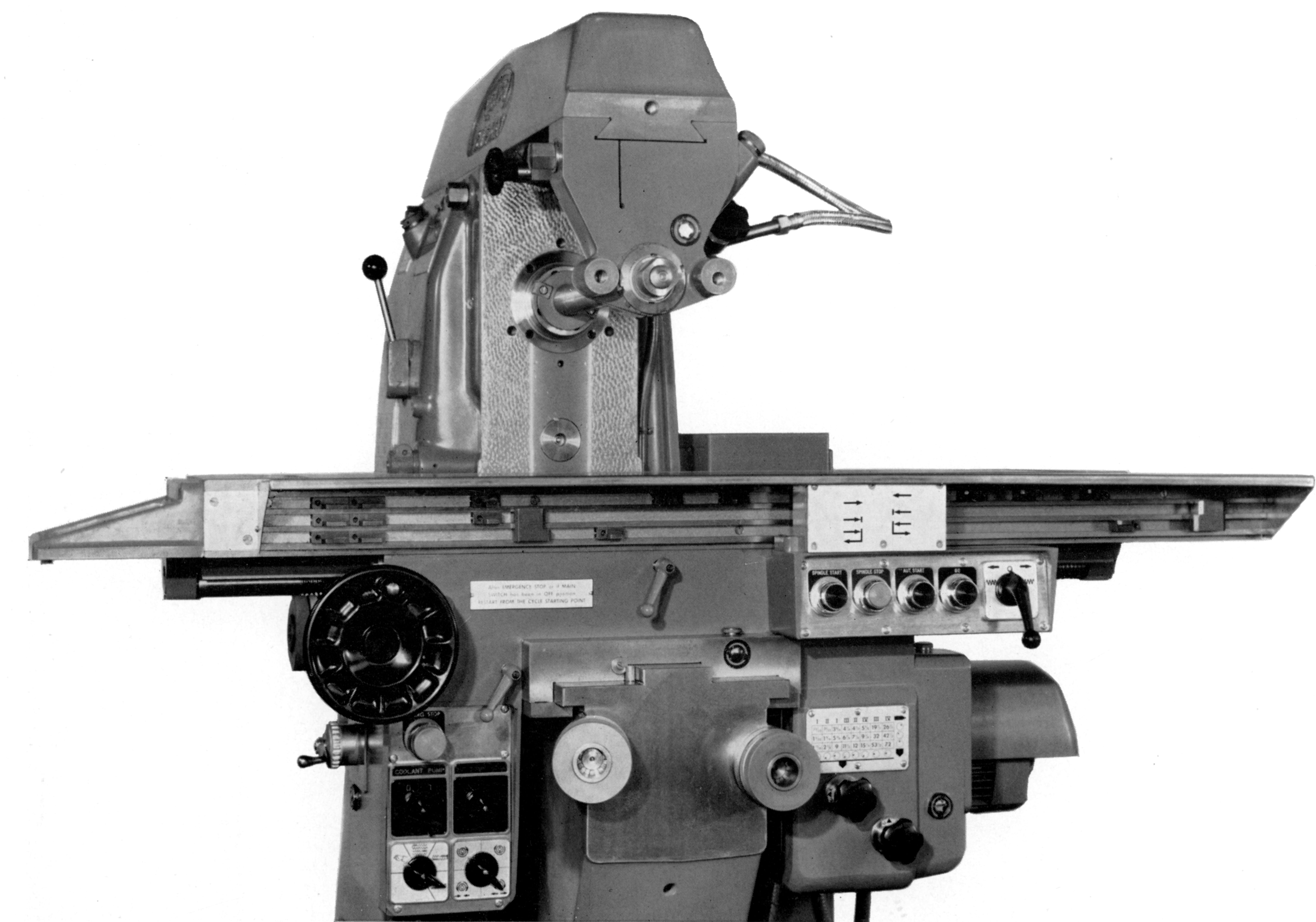

Manufactured during the 1960s, The Sajo 52 was offered as the Model PF52, a  Plain Horizontal; the Model PF52, a Universal" machine with a table that could be swing on its vertical axis by up to 45° on each side of central; the Production Model DPF52 with automatic table cycles on its longitudinal feed; the Duo Mill 52, a horizontal and vertical machine that retained the horizontal spindle but was also fitted with a self-powered overarm for vertical work and the Model VF52, a machine stripped of its horizontal capacity and fitted with just the  1200 r.p.m.

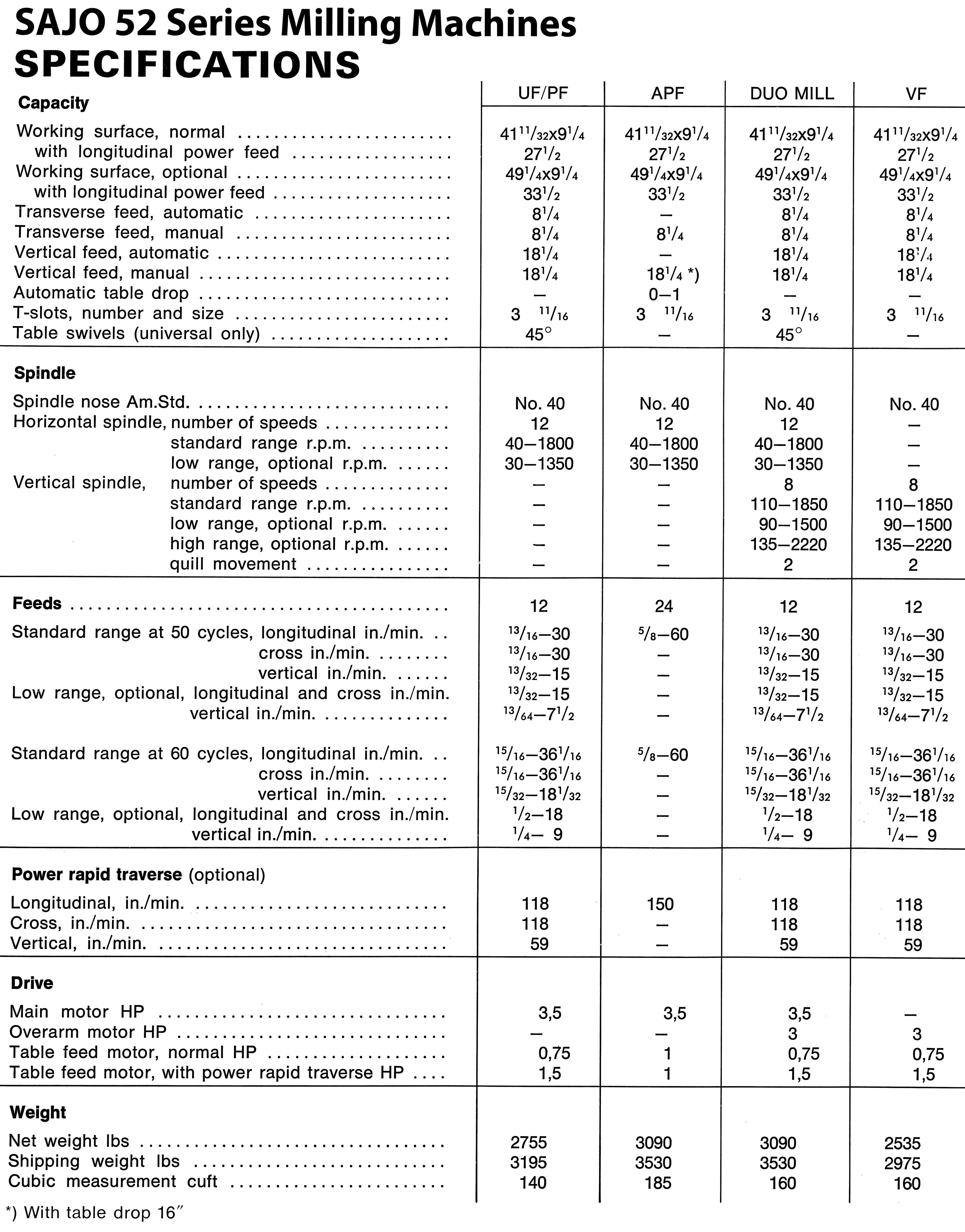

A full specification sheet can be found lower down the page.

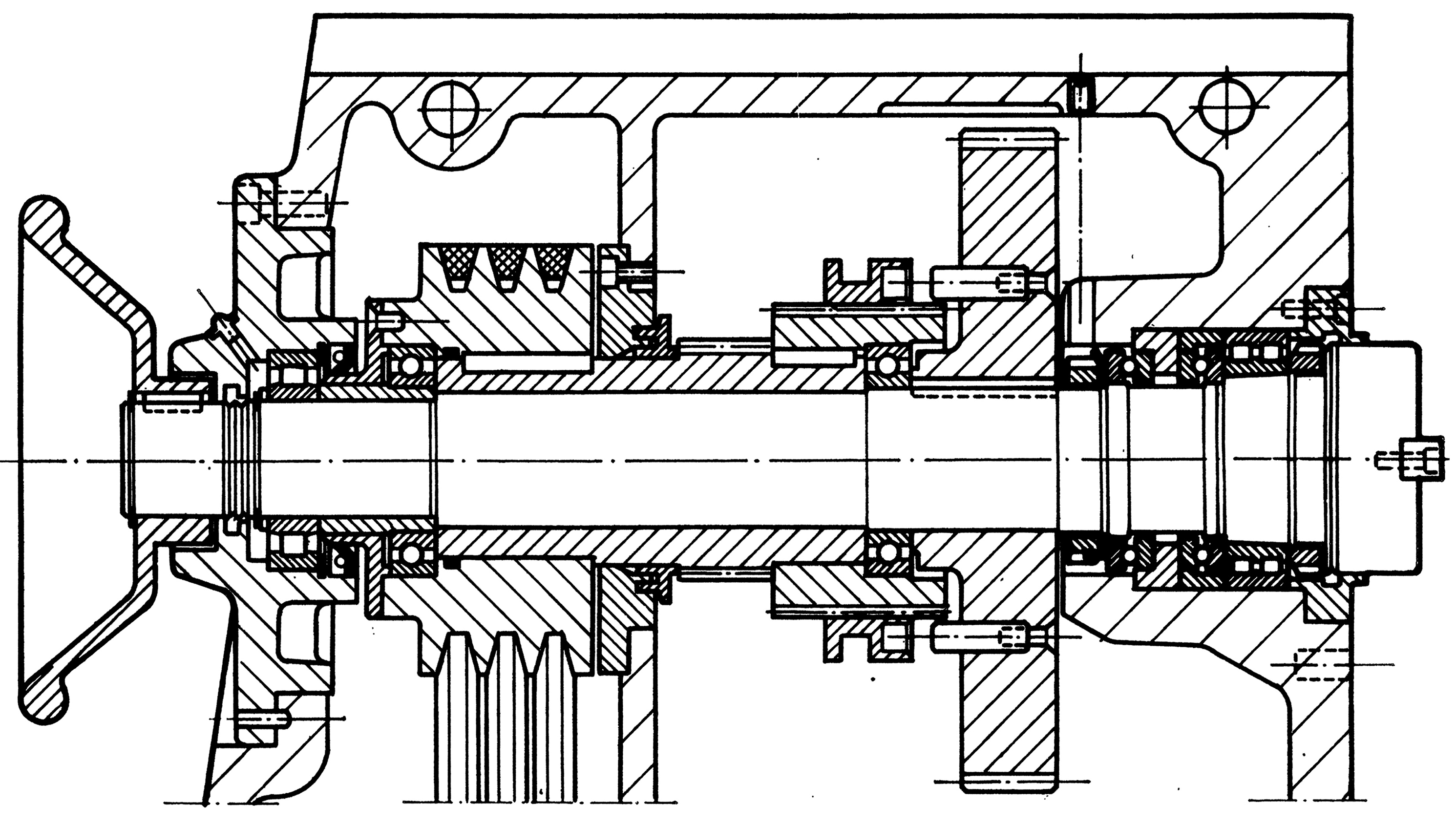

Section through the horizontal spindle

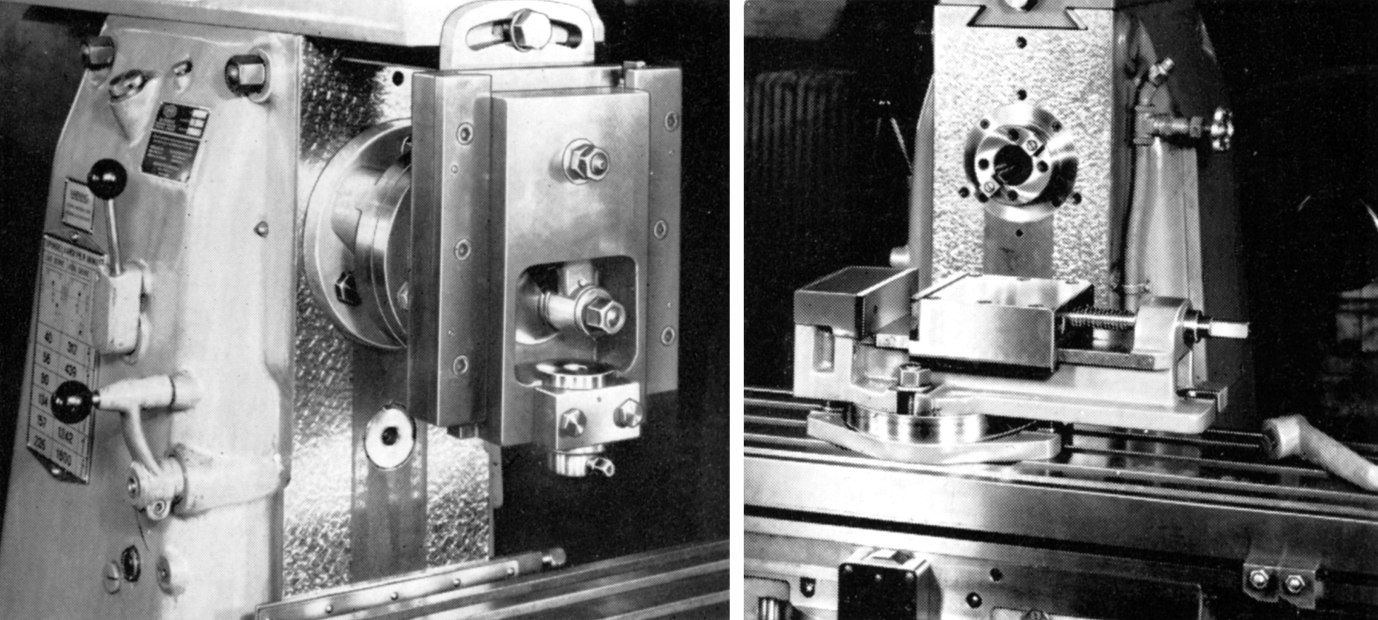

Slotting Head
Swivel-base machine vice

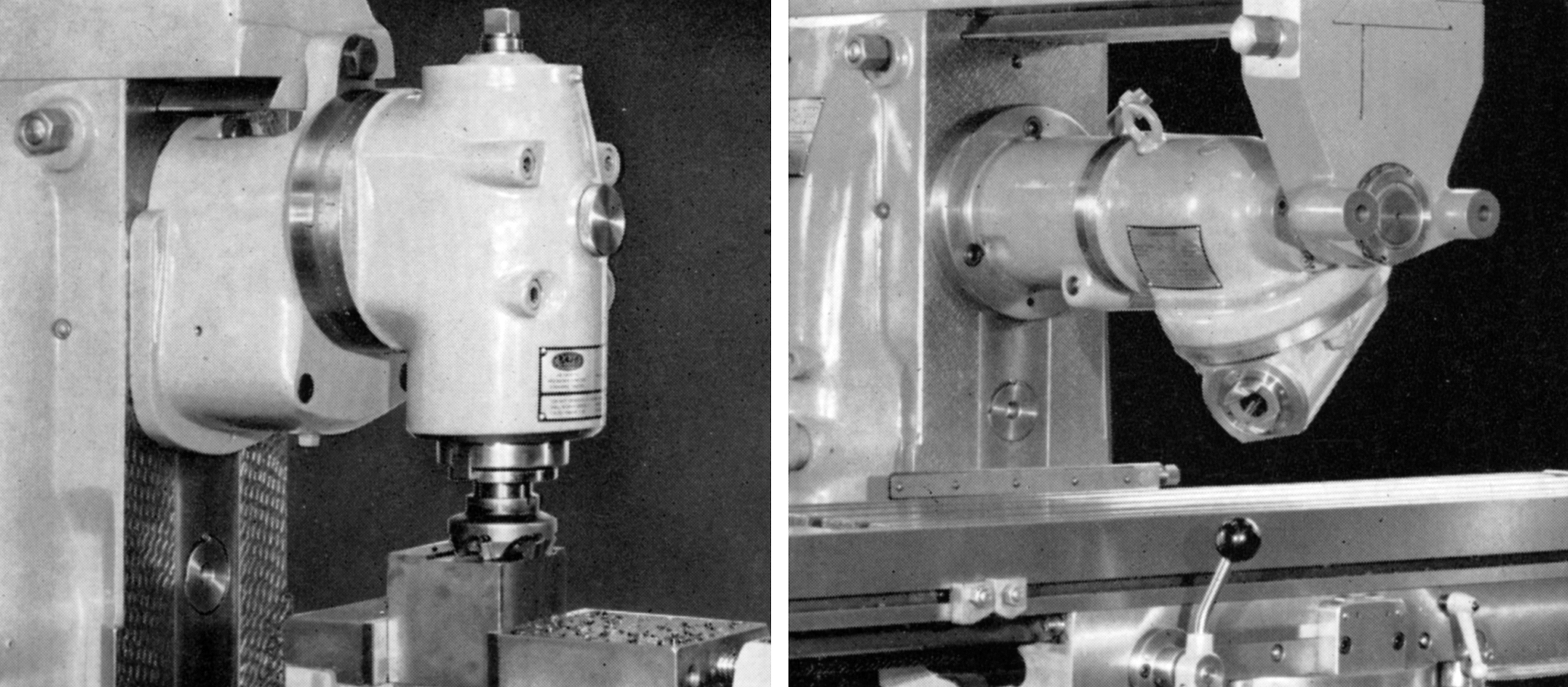

Vertical  that bolted directly to the horizontal spindle. Step-up internal gearing increased
speeds to make them more suitable for the use of small end mills and slot drills
Double-swivel vertical head supported by the end drop bracket

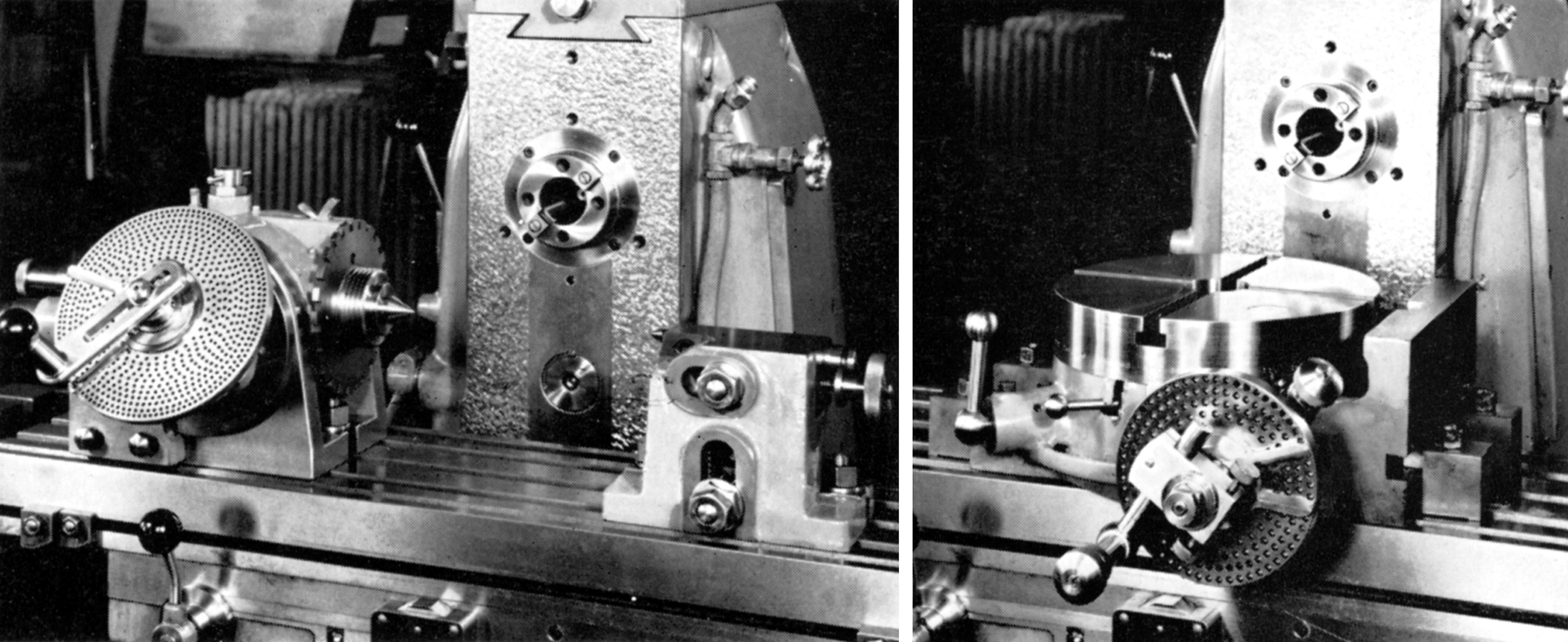

Dividing head with tailstock
Rotary table on an angle-plate base with indexing plate
