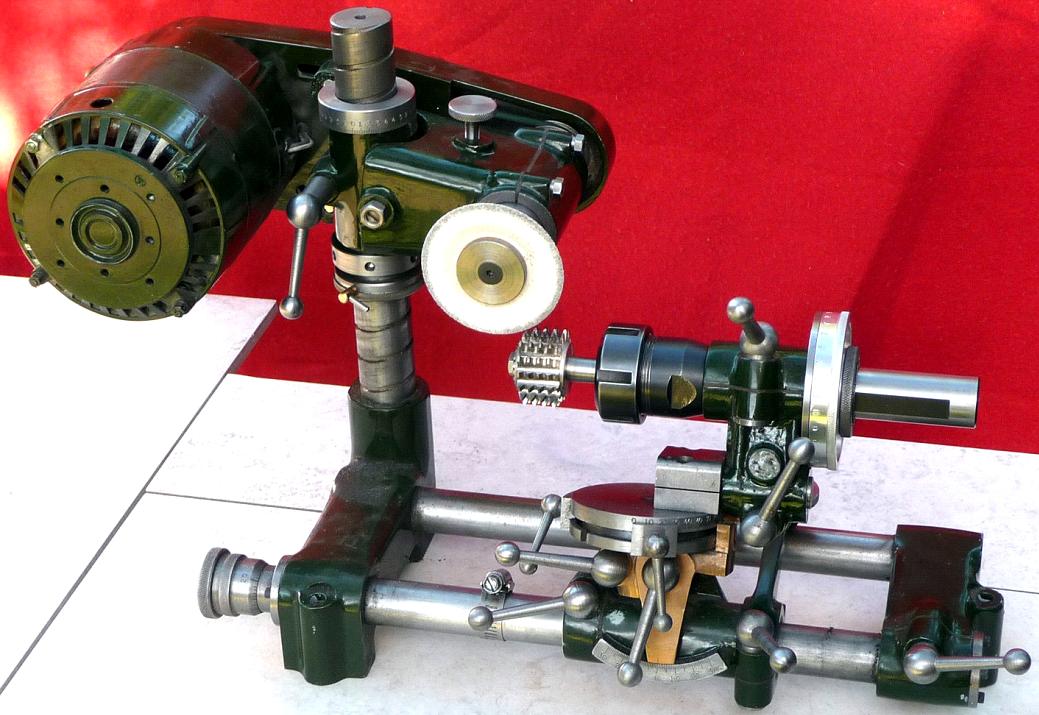

Since this adaptation was made, the owner has realised that there was, in fact, no need to mount the spindle vertically - hobs can be sharpened with the grinding spindle set horizontally as Prof. Chaddock intended (photographs at the bottom of the page illustrate this procedure) However, the threaded collar for fine vertical adjustment is still very useful - and is also shown below. The essence of the original modification was a horizontal shaft that allowed the grinding spindle to be set vertically. The shaft was held a mount slipped over the vertical column with 20 t.p.i threaded collar beneath to allow a fine vertical adjustment. The cut was put on by a rocking-lever adjustment screw that contacted the fixed raiser 1" shaft - which is why the work arbor mount was turned right over. To allow this setting, the adjustment knob on the rotation setting plunger had been taken right back. Note the high-tech carriage stop on the bed rail - a jubilee clip….
Head-mounting bracket and, beneath, the threaded collar to allow for fine vertical adjustment
Sharpened hob from a Swiss Mikron gear hobber
Since the vertical adaptation was made, the owner has realised that there was, in fact, no need to mount the spindle vertically - hobs can be sharpened with the grinding spindle set horizontally as Prof. Chaddock intended, above.
