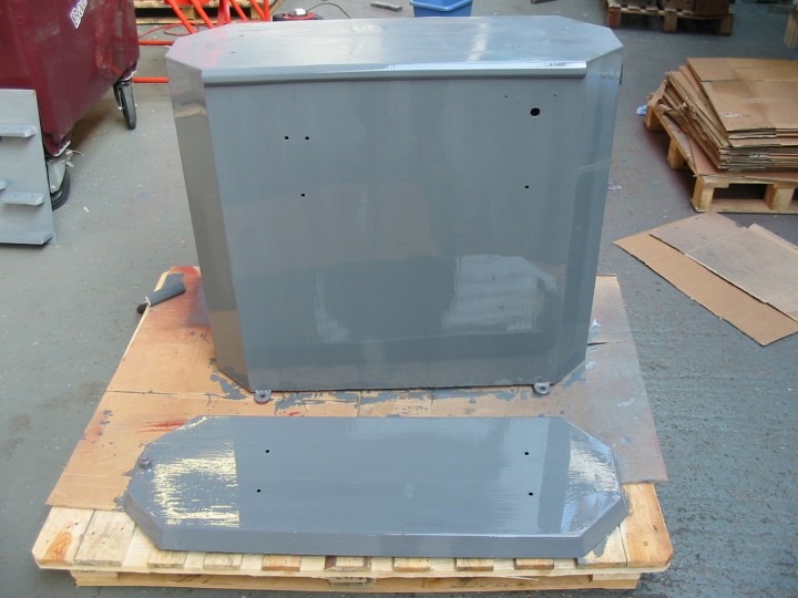

Remember this? It was the state of the base stand and tray when it arrived. After having a go with wire brushes and wet and dry paper I soon realised it was going to take forever doing it this way, and also there were many areas I wouldn't be able to get to. As such, it seemed that sandblasting was going to be the fastest and best way to remove the rust and old paint. . |
I had a friend who used to blast but was unfortunately no longer in the business, but he recommended another local source for this, and as the guy was working just 10 miles away I packed the dis-assembled stand and tray in the back of the landrover and trundled off to see him. This was the result. It cost £100 but I think was worth it. Even all the inside surfaces and corners, as well as underneath the base were blasted, so there are no lingering traces of rust tucked away in hidden corners. |
The next stage was priming prior to using the proper Myford enamel paint to finish it. The Myford enamel (made by Trimite) is very tough as well as being chip and solvent resistant, so depite being expensive - around £20 for a tiny 100ml pot, and I needed a few - it's well worth using this, and the finish is superb. I had to give all the parts a through cleaning first with an air blast and then vacuum to remove any last traces of the blast media, followed by a solvent wipe over all surfaces which were then allowed to flash off before applying primer. I was lucky that I had the use of an empty warehouse at work to use when spraying, although it had to be done over the weekend, so everything was prepped on a Saturday for painting on the Sunday. Painting it inside with the benefit of plenty of space, a proper compressor and LPHV spray gun made things much easier. The primer was a standard red oxide from a rattle-can, and it was given 2-3 coats all over and on all the inside surfaces. |
Once the primer was on and dry it was time for the enamel to go on. For spraying it was thinned down about 2.5:1 with white spirit (it's an oil based paint) to get the right consistency, and then applied. Everything was given 2 coats, although the drying time between coats was quite long. On the underside of the tray and top of the stand I actually put on an extra single undiluted coat with a brush, as once this was bolted together it wouldn't be easy to access for cleaning, and I wanted it well protected. | ||||

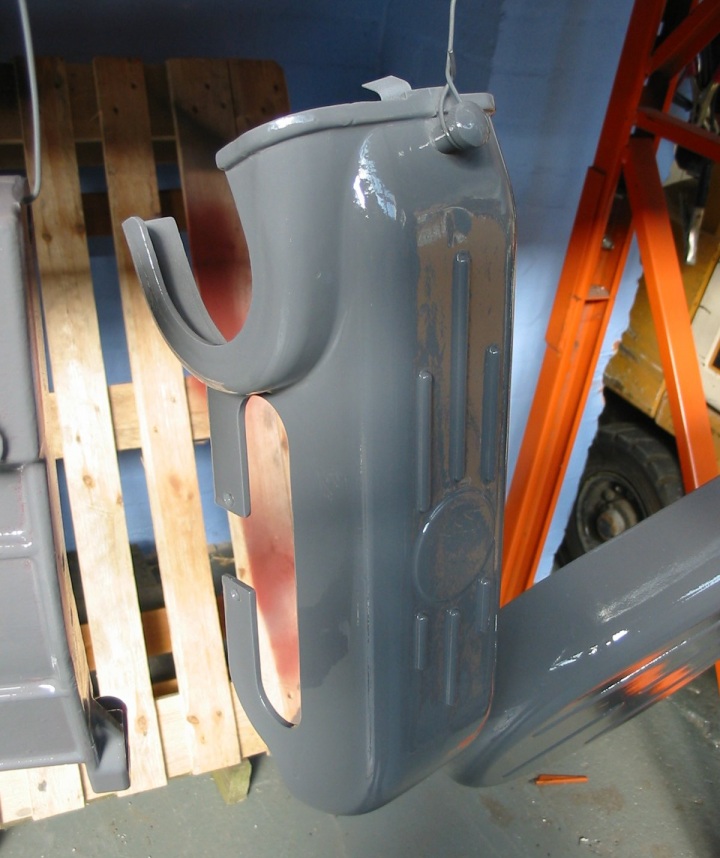

As I mentioned above, when prepping the parts some needed more work than others. As you can see, the headstock needed stripping back to the cast iron as did other parts, while some that were only lightly scuffed or chipped just needed degreasing and a light rub with wet and dry over the original paint to key the surface. On these, a little bit of body putty filler was used to fill shallow chips then sanded down to match the rest of the surface. These parts were just given a coat of primer filler over the already keyed original paint surface, whilst the other parts stripped right back were given 2 coats of red oxide primer over the bare metal. Some even had both. | ||||
Next step once the primers were dry was a little rub over to remove any minor imperfections, then onto spraying the top enamel coat. I could hang the parts from some the edge of some handy racking in the warehouse, which meant that the access all around the part for spraying was good. I applied 2 coats on the parts, although I had to wait around 8 hours for the first one to dry, as the solvent evaporation was quite slow. |

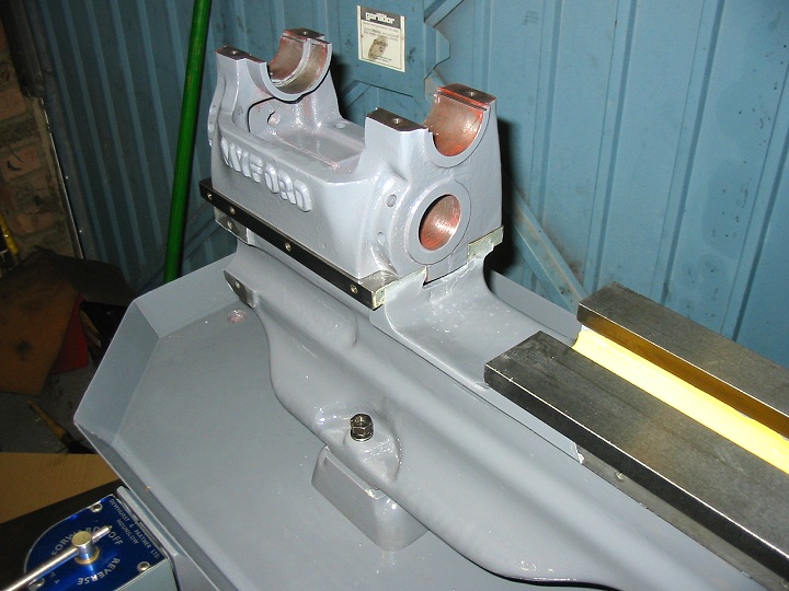

Next up was the Bed. After the re-grind this took a lot of rubbing down and fine putty filling where the paint had been chipped and worn over the years. Unfortunately the digi-cam batteries died during the rubdown and prep work, so no photos of that stage available, but the finished item is below. The ways and other mounting points were masked off to avoid overspray. | ||||
Once the main parts had been painted and allowed to dry and cure for a week, then the base parts could be re-assembled on to the stand. | ||||
