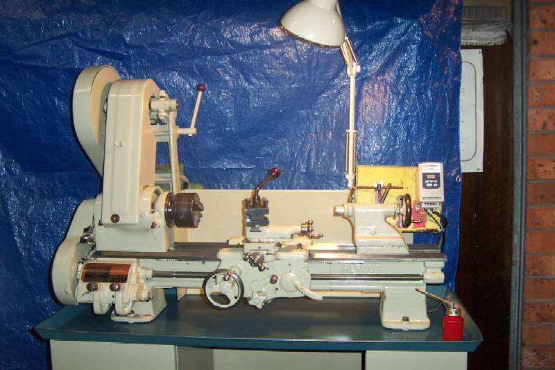

Argh. Sorry to ask for help like this, but I'm in a bit of a hole.
As you know, I bought a metric roller bearing Hercus (ARM) from a machine reconditioners. In pieces.
The deal was this: rather than take the pallet of bits away, I would pay to have the machine rebuilt, repainted, assembled and aligned. They said delivery would be a week, I said there was no hurry, take your time, do it properly, I'll take it in six weeks. I paid cash up front and sat back to await developments.
Two problems: one, I am way too trusting of people; two, they's been in the horse tradin' business for ayn awful long tayime.
The lathe's arrived, with the original 415V motor instead of the dual voltage replacement paid for, and none of the extra tooling that had been promised.
I went and got the motor. Got laughed at when I asked for the tools - "Not at that price!"
Last night I bored the new pulley to fit, made new motor mounts, and fitted the inverter. Motor is fine, even though underpowered (1/2 horse). I was happy just to get it running before bedtime.
I took today off work and spent all day in the workshop. I started at the headstock and worked my way along.
What became immediately apparent, was that the pallet load of parts had been thrown together at the last minute, and then painted. In that order. (Note - since writing this, the subassemblies seen in the original pics were painted as they were, then assembled.)

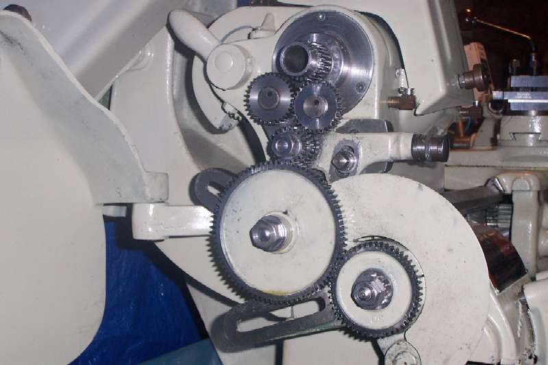

It took an hour or so to wire brush all the paint and old grease and swarf out of the back gears, they now work albeit with a tooth rattle. They don't seem to have got a lot of use.
It took three hours to pull down the tumbler reverse and banjo, and wire brush, clean and adjust all the bits. I used a diamond ezy-lap sharpener to knock off the worst of the high spots and reshape a few teeth that needed it. Could you believe they spray painted the lathe with the change wheels and leadscrew in place? FFS.

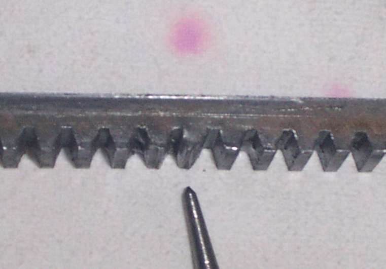

I got a torch and examined the rack at the marked points - at each point there was a malformed tooth, presumably from bits of shit being jammed in accidentally or on purpose.

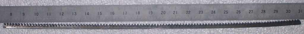

I took the rack off for a better look. The rack is bent downward around six inches from the headstock end. It also has a slight curve throughout its length, and straightens out about nine inches from the tailstock end.
One of the teeth has actually been bent sideways, this is where the saddle was jamming up and stalling under self act. The only thing I can think of is that at some stage someone ran it in low backgear with the half nuts engaged, and poked something into the saddle pinion to see what would happen.

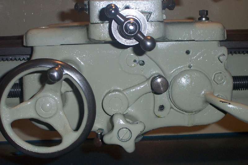

Given the state of the rest of the lathe - the paint is coming off in patches where they sprayed over the top of grease and swarf - I'm thinking it would be in my best interests to strip the saddle right down. I've never pulled apart a saddle with power feeds though. Is it something I can intelligently work my way through, or do I need the manual?
Are there any non-obvious oiling points? I replaced the yarn packing in the tumbler reverse pins, I'm inclined to leave the rest. Dirty oil is leaking out from the right places, so they must be working.
How does the saddle clutch star wheel work? Do you need to give it a good tighten to engage the feed, or is a light touch required? Is it normal for it to turn whenever the leadscrew is going, even if the star wheel has been turned anticlockwise?

Well, it didn't spoil my weekend, but not a lot of progress was made either. I took the rack and original motor back to J&N on Monday and spoke to John. He initially was quite defensive - even with the rack in front of him he was telling me that I bought a second hand machine and couldn't expect it to be in new condition. When I said I only expected it to be usable he called me a perfectionist. In the end he said leave it overnight and he'd straighten it. After a bit more haggling he also said he'd file the damaged teeth.
April 9 2002
I picked it up the next day and it was pretty much straight and the teeth reasonable. Someone needs to tell them about soft jaws for vices though, there's nice diamond patterns pressed into it near the bends. That's the last time I've been to J&N Engineering and the last time I intend to go there.
More email:
Just letting you know that I got the rack back today, still a few high spots but a smooth file took care of those. Put it on and it works well, only a couple of places where the uneven teeth cause a little pause in travel, not where I'd usually be using it.

Seems to work OK but is noisy and chews a lot of power. Given the state of the rest of the rebuild I think it needs to be stripped, cleaned and put back together properly. Is this something you can do by methodical means, or does it require technical docs and special knowhow to get it back together?

I decided to bite the bullet and have a look at the saddle. I took out the oil drain plug and nothing came out. That was funny, I'd been pumping enough in... a small mirror showed a solid plug of greasy swarf up the hole. Similar inspection of the oil inlet revealed the level hadn't gone down in several days.
