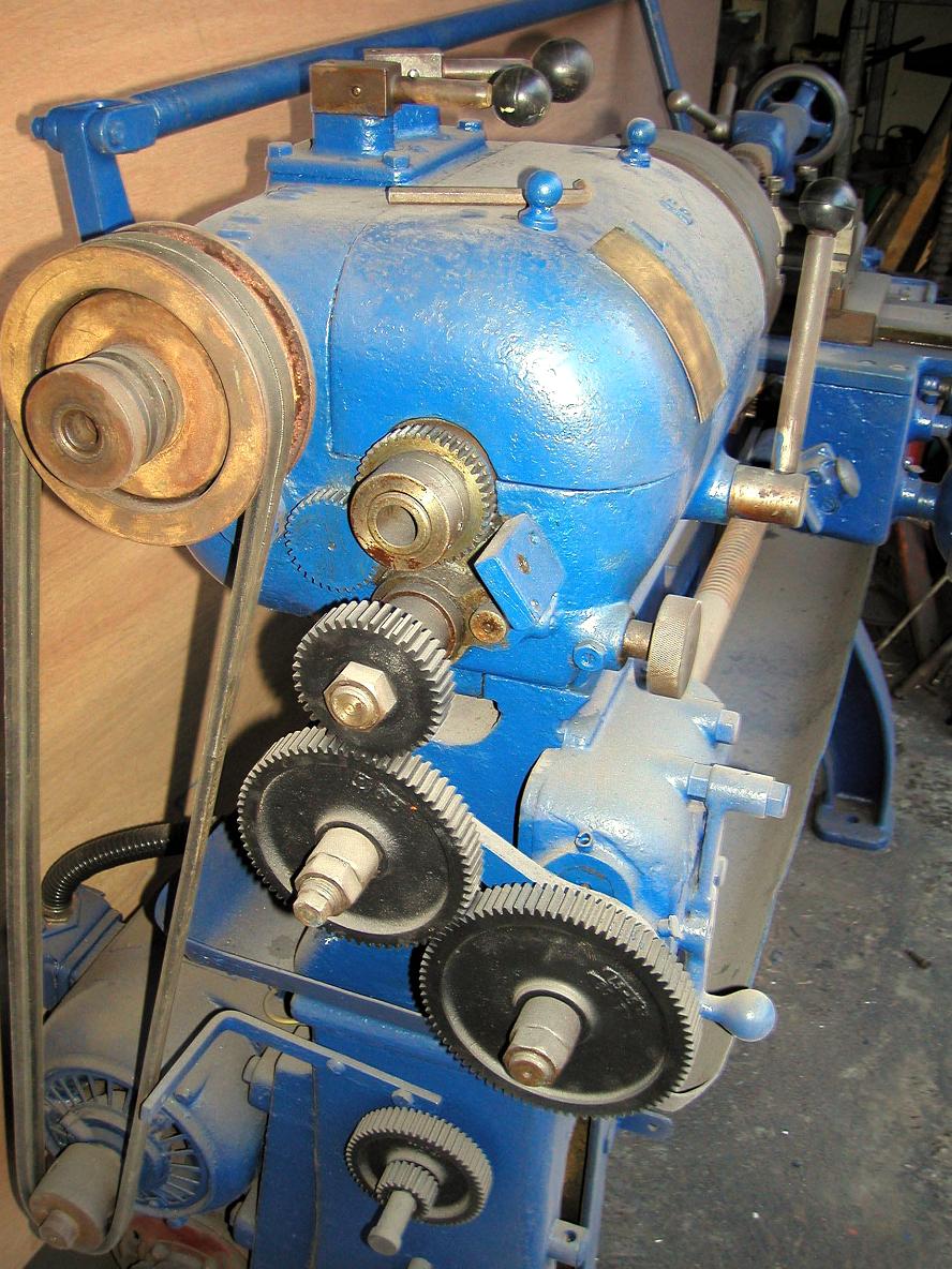

With the changewheel cover removed its single mounting lug can be seen just below and in front of the headstock spindle. The 3-speed leadscrew gearbox allowed a very simple non-compound gear train to be used even for fine feeds.

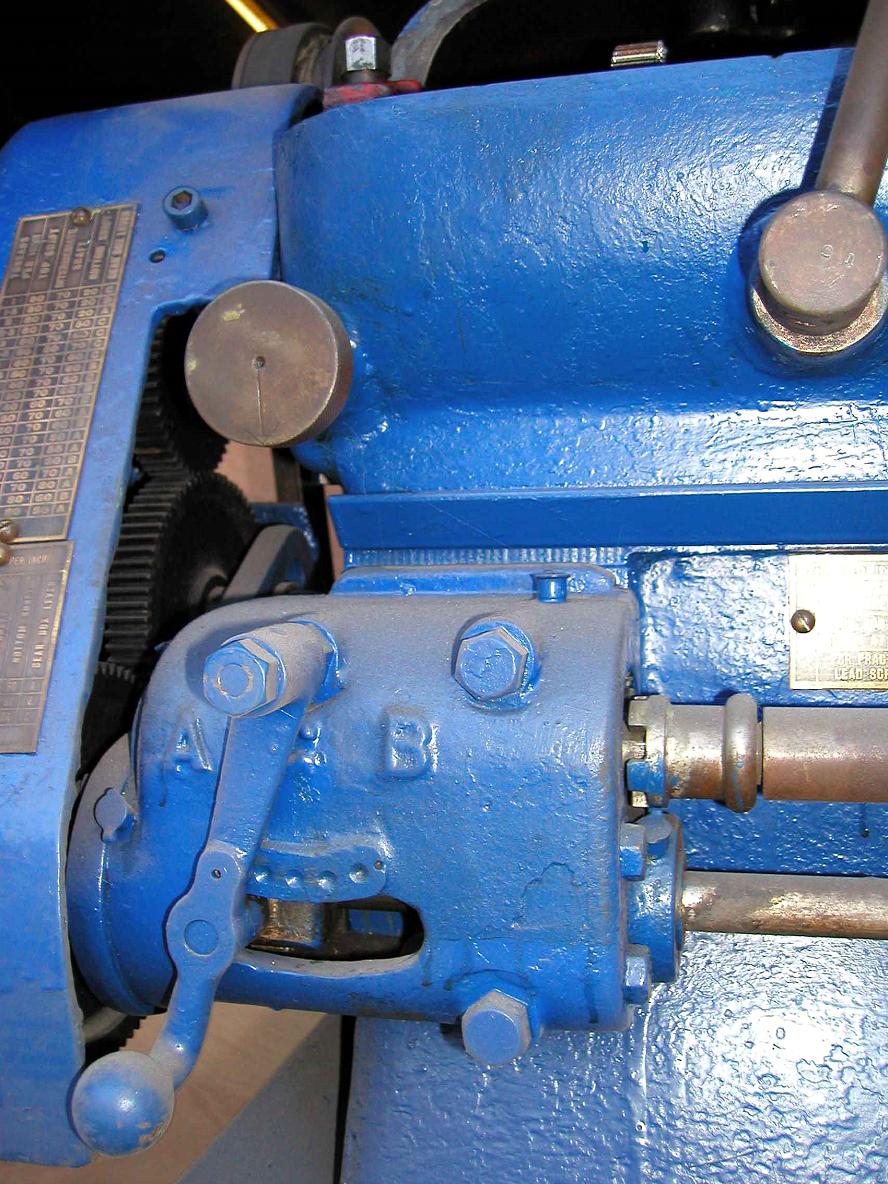

Simple 3-speed screwcutting and feeds' gearbox

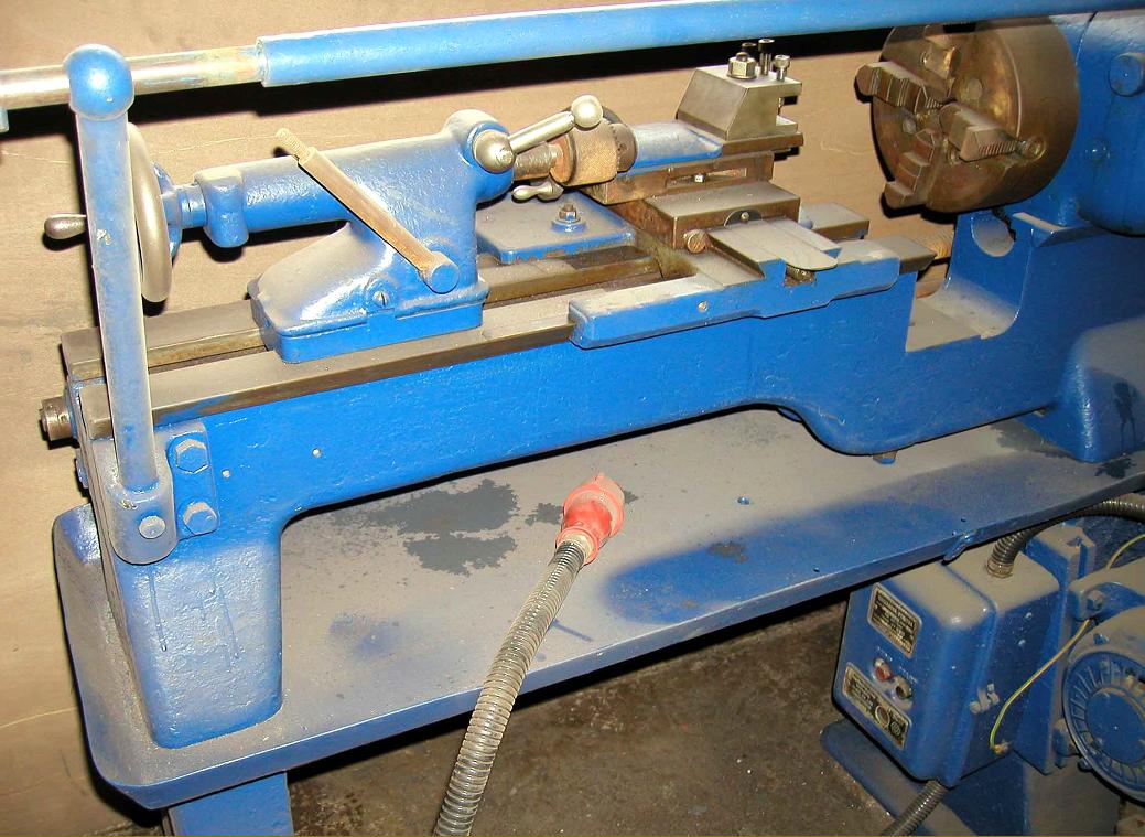

The clutch-operating arm was connected to a full-length operating bar that slid through a bracket supported in a bracket at the tailstock end of the bed.

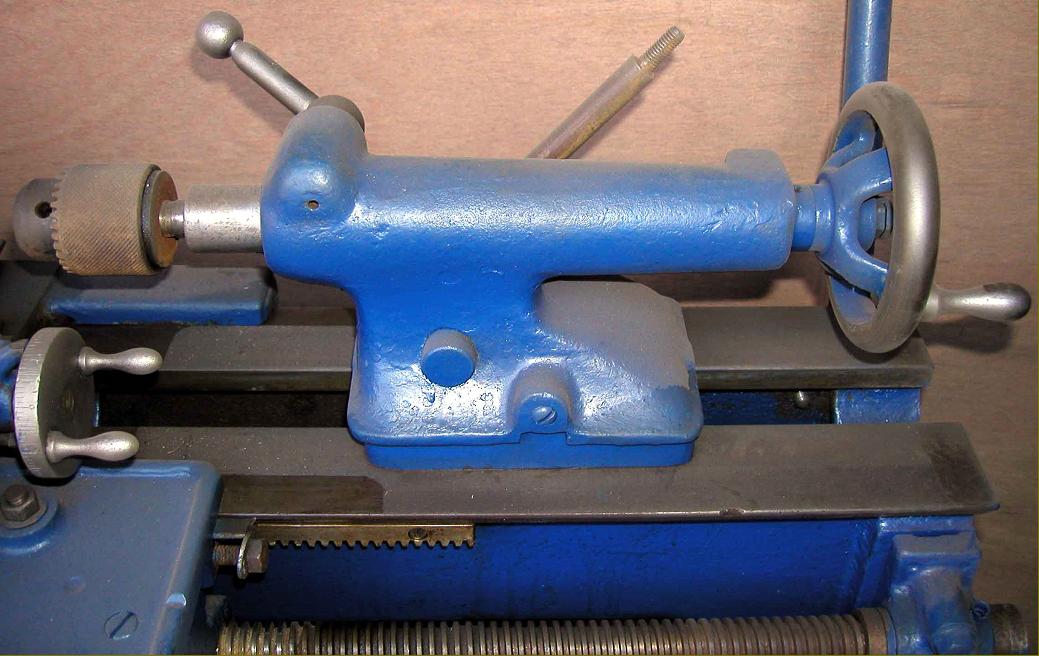

On early lathes the tailstock barrel clamp was positioned horizontally over the top of the casting.  The bracket bolted to the end of the bed supported the end of the clutch-operating bar.
