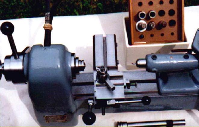

Gilman lathe set up as a second-operation lathe with lever-feed controls

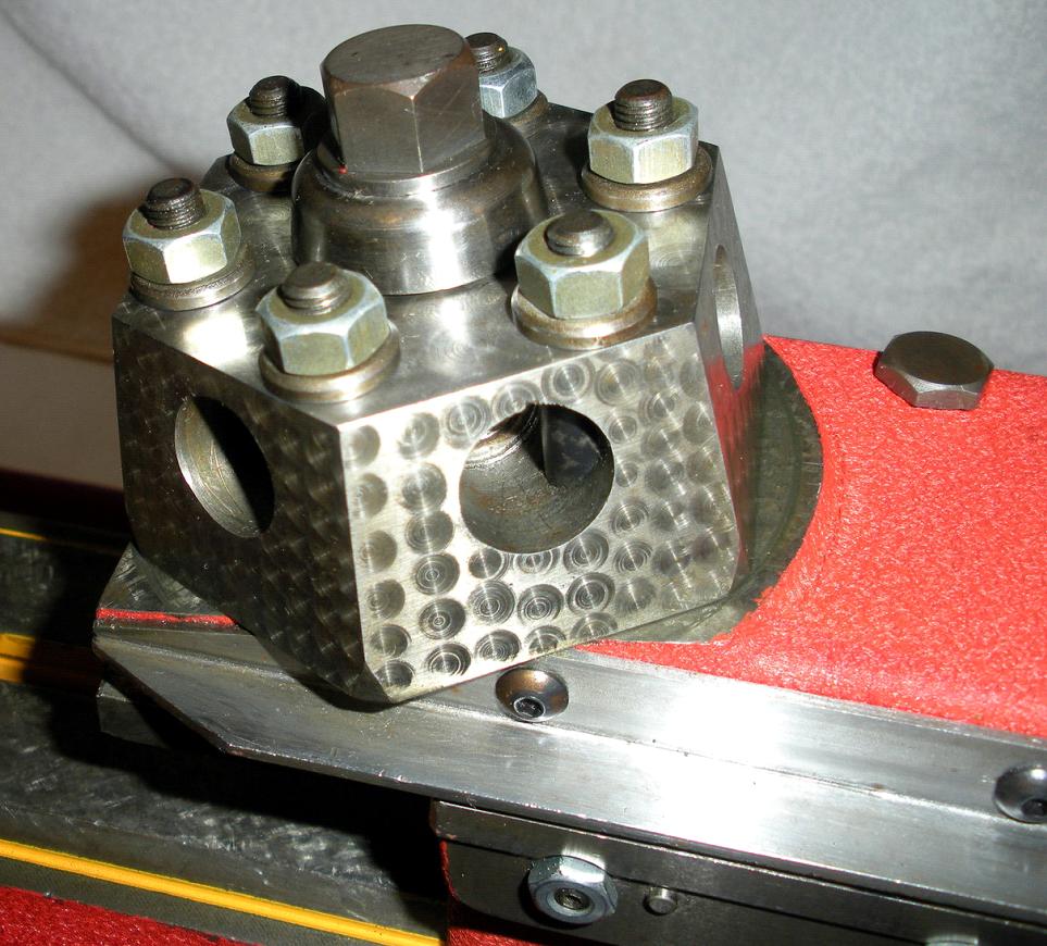

Tiny 6-station turret assembly

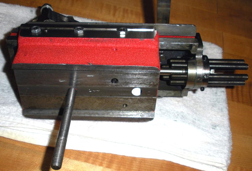

Turret indexing mechansim
