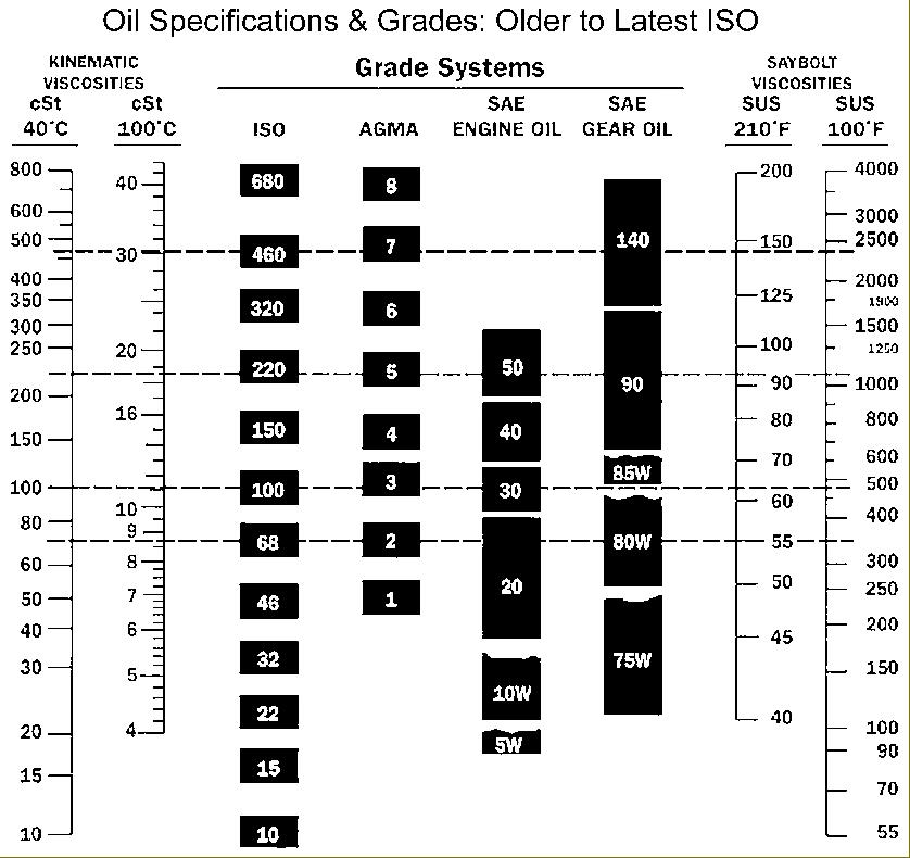

According to a cross-reference sheet (it can be found here), Shell Tellus 27 (old numbering system) has been replaced by Shell Tellus 37 (new ISO numbering system) with Shell Tellus 32 (ISO) being an acceptable replacement - these being mineral-based, high- performance hydraulic oils. However, in reality, any quality hydraulic oil that has the correct viscosity should be fine - a popular choice being Tellus 46, an R&O (sometimes shown as "RO"), a Rust & Oxidation inhibited hydraulic "recirculating" oil with Anti-Wear additives. The ISO classification for these oils is HL
AW stands for anti-wear - RO hydraulic oils with an anti-wear additive package, the ISO classification for these being HM.
MV means a multi-viscosity oil, with other abbreviations being:  MG (multi-grade), MW (multi-weight) and HVI. All these oils contain what are known as "viscosity index improvers", their job being to alter the rate of change in viscosity as the temperature rises and falls. The ISO classification is HR for viscosity index improved oils of the RO type and HV for viscosity index improved oils of the AW type.
ISO Numbering System: these refer (e.g. 22, 46, etc) to the viscosity grade (VG), 22 and 46 being ISO "standard" grades. The numbers refer to the oil's kinematic viscosity in centistokes at 40 degrees Celsius - plus or minus 10 percent. e.g. an ISO VG46 oil has a viscosity of between 41.4 and 50.6 centistokes at 40C.
