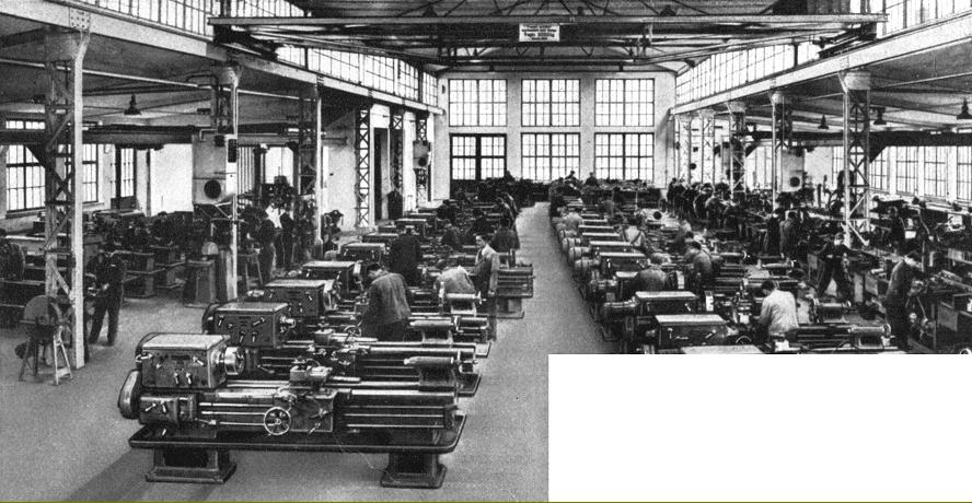

Eugen Weisser Factory - probably in the late 1940s
