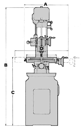

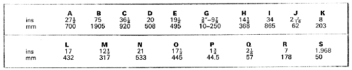

DIMENSIONS
Mini Jig Borer Home Page
Dimensions Mk. 1 Machines
T-slot dimensions Mk. 1
Dimensions Mk. 2 Machines
Above: dimensions for the Mk. 2 Downham Jig Borer

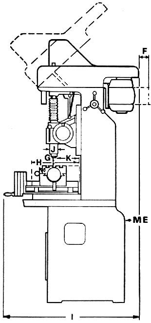

Table T slots and a plan elevation of machine's stand dimensions Mk. 2 and Mk. 3 Models
Above: dimensions for the Mk. 3 Downham Jig Borer
Table T slots and a plan elevation of machine's stand dimensions Mk. 2 and 3
