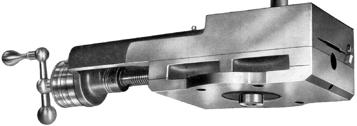

Both top and cross slides were adjusted with taper gib strips, carried ball thrust bearings on their feed screws and had clearly engraved zeroing micrometer dials with narrow knurled grip rings. The handles were traditional "balanced-ball type" which, whilst handsome, might have been considered rather hard on the operator's hands on a machine of this size.
Cross-feed screw with the ball-thrust bearings visible at each end of the supporting bracket
