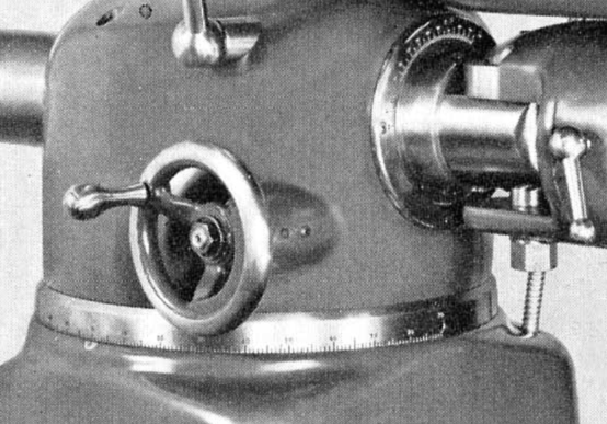

  Almost the full width of the main column, the turret head was rotated by worm-and wheel gearing
