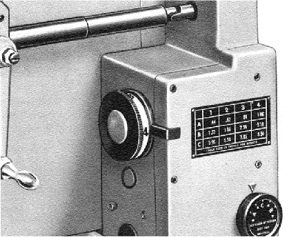

A well designed optional power feed attachment was also available; this reduced the longitudinal travel to 15.375" but gave 12 rates of power feed from 0.44" through 0.62", 0.85", 1.06", 1.32", 1.86", 2.55", 3.18", 3.96", 5.58", 7.65" to 9.54" per minute with automatic knock-off and protection by an overload clutch; feed rates were changed by rotary selectors on the side of a column-mounted table-feed gearbox that drove, though a universal shaft, to a reversing and engagement gearbox fastened to the knee underneath the table.  A rotary dial on the reversing box selected left or right movement whilst a lever enabled the drive to be flicked in and out of mesh. The table feed screws were ground finished, ran through ball races in the supporting end brackets and were fitted with large, satin-chrome finished micrometer dials.

Simple and clear rotary controls were used to change the table feed rates.
