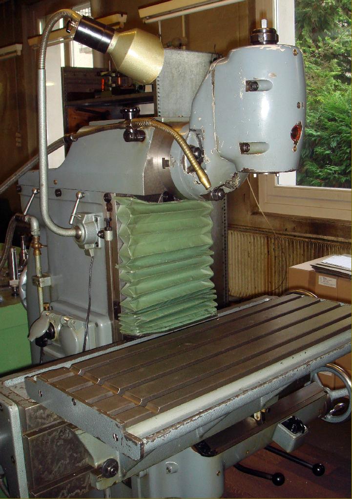

An early example of the type, an U-1 badged as a Perrin Freres s.a. Moutier
