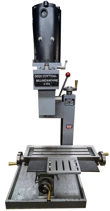

A beautifully restored Childs vertical ram-type milling machine. This was of unusual design for so small a machine with all the major parts made from rectangular castings. The vertical column was off-set to the right of the table's lateral centre line - giving a rather unbalanced appearance - with the "knee" sliding up and down the left-hand face under the control of a vertical screw.
The vertical column is off-set to the right of the tables centre line with the "knee" running up and down its left-hand face.

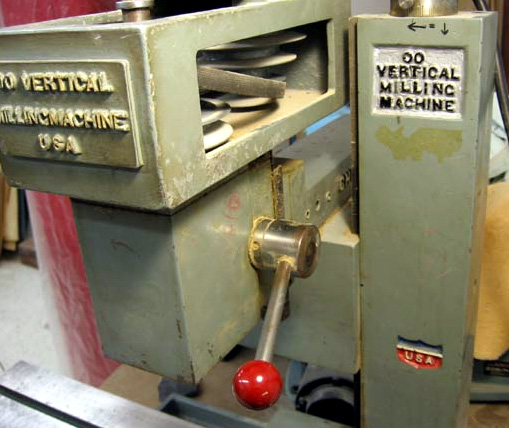

Maker's name cast into the horizontal ram of the vertical miller
The shorter but wider table version of the Childs Model 0000 vertical miller.
Made in cast iron and weighing around 275 lbs, the Childs Model 0000 Mk.2 ram-head vertical milling machine was, for its size, surprisingly rigid. It sat on a base of 16" x 15" with a handy and deep lip to act as coolant and chip tray. The 3.75" x 16" table three T-slots on the top a single one on the front face and longitudinal travel of usually 9" but, as a factory option, this could be extended by one inch. Cross travel was 3.25" with - again as an option - an extra inch available.
The head could be extended in and out through a range of 8.5", tilted  90° each side of vertical and held a quill (under the control of a quick-feed lever) with a travel of 2 inches. Fitted with - surprisingly - a No.2 instead of the expected No.1 Morse taper and a 3/8" x 16 t.p.i. Drawbar - the spindle ran in Timken 6306 deep-groove ball races with the facility to preload them..
