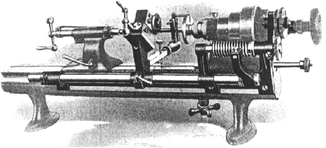

Waltham lathe fitted with "Chase" Master-Thread screwcutting This picture shows clearly the well-proportioned items used on the Waltham to perform this early type of screwcutting. The bed was turned so that the T slot ran down the back of the bed; in the slot were three adjustable supports two of which carried the Master Thread (also known as a hob or leader) - whilst at the headstock end the third bracket supported an arm that carried additional gearing to extend the threading range. A "half-nut", held in the base of an adjustable tool-slide, pressed on the thread and transmitted its form to the workpiece. The interconnection of the cutter holder and the half nut allowed the nut to be lifted out of engagement and the cutting tool returned by hand to the start of the thread without stopping or reversing the lathe; a little additional depth of cut could then be applied by the tool slide, the half-nut rested back on the master thread - and the cut restarted. Whilst this system produced absolutely accurate threads, and was especially suited to delicate operations on thin-wall tubes used to construct such items as microscopes, the length of thread that could be cut, and the number of threads per inch or mm, depended upon the availability of the appropriate thread master. In order to reduce the spindle speed for screwcutting, or larger faceplate work, Waltham offered a special headstock with a completely enclosed 4 : 1 ratio epicyclic-reduction gear. Alternative and sometimes more highly developed arrangements of the same system can be seen. on the Stark, Pratt & Whitney, Ames, Potter and Wade pages.
