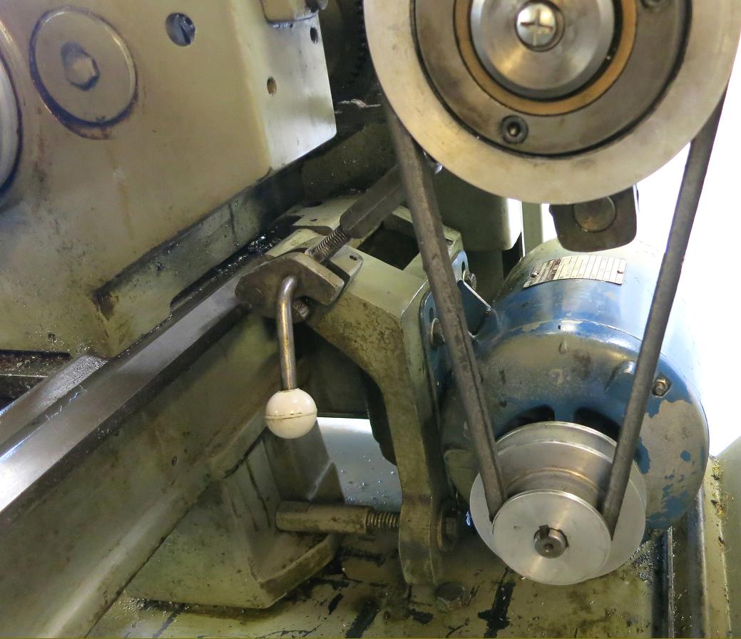

The lower part of the countershaft consisted of a block of cast iron secured by a single clamp bolt to the bed V-way at the back of headstock; the block was bored through to take a bar, from which hung the slotted motor-support plate - this being secured at the bottom by a single shaft that incorporated a long compression spring - presumably to allow some "give" in the system. The "swing head" that carried the 4-step "A-section" V-belt pulley was tightened and relaxed by usual adjustable, over-centre mechanism with a right-and-left-hand threaded hexagon block fitted with a rather short and so awkward-to-manipulate ball-ended handle (the same fitting can be found on the original 1933 South Bend).
Lower mounting point for the spring-loaded motor-support plate
