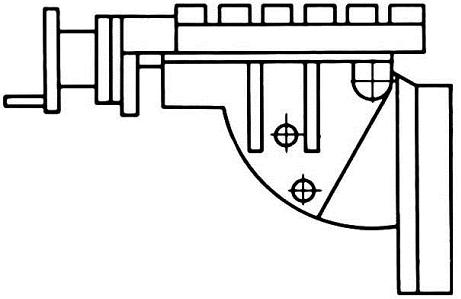

Type Dsn or 300 x 850 mm Type Dsp. Two Universal tilting and swivelling tables were also offered, the conventional Type Dsu3 and the unusual Type Dsr3, the latter screw driven to provide a lateral feed. Both had  five 14 mm T-slots on 63 mm spacing and with swivel angles of 360° around their vertical axis, 30° each side of the longitudinal and 45° around the traverse.

Type Dsn or 400 x 800 mm Type Dsp. Two Universal tables were also offered, the conventional Type Dsu3 with a working area of 315 x 630 mm and the unusual 280 x 630 mm Type Dsr3 with a feed screw that gave a lateral feed. Both had  five 14 mm T-slots on 63 mm spacing and with swivel angles of 360° around their vertical axis, 30° each side of the longitudinal and 45° around the traverse. .

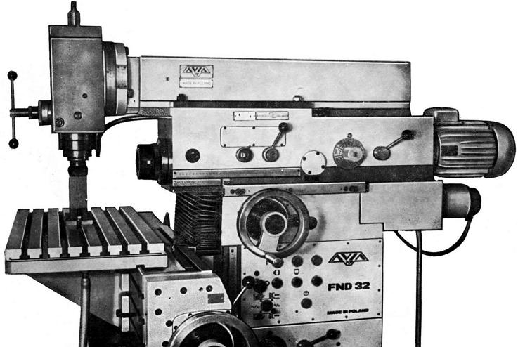

Avia FND-25 and FND-32 with the Type Dgf Vertical Milling Head and Type Dsp/Dsn Horizontal Table

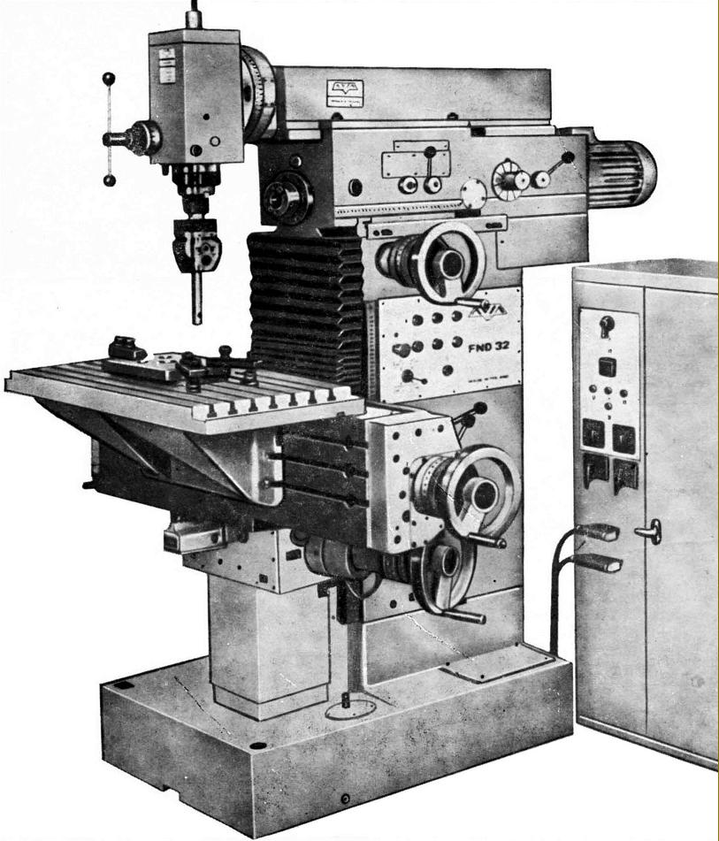

Standard version of the FND-32 with a cutter-arbor support drop bracket on the end of the overarm

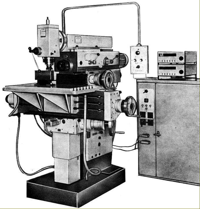

Avia FND-32 fitted with the optional electrical control pendant Type Dws3 and Type Dsom Rotary table

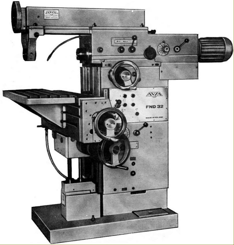

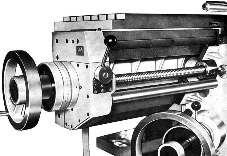

Unlike many competing makes, the Avia did not have bellows to cover the table ways
The unusual 280 x 630 mm Type Dsr3 Universal Table with a feed screw that gave a lateral feed.
