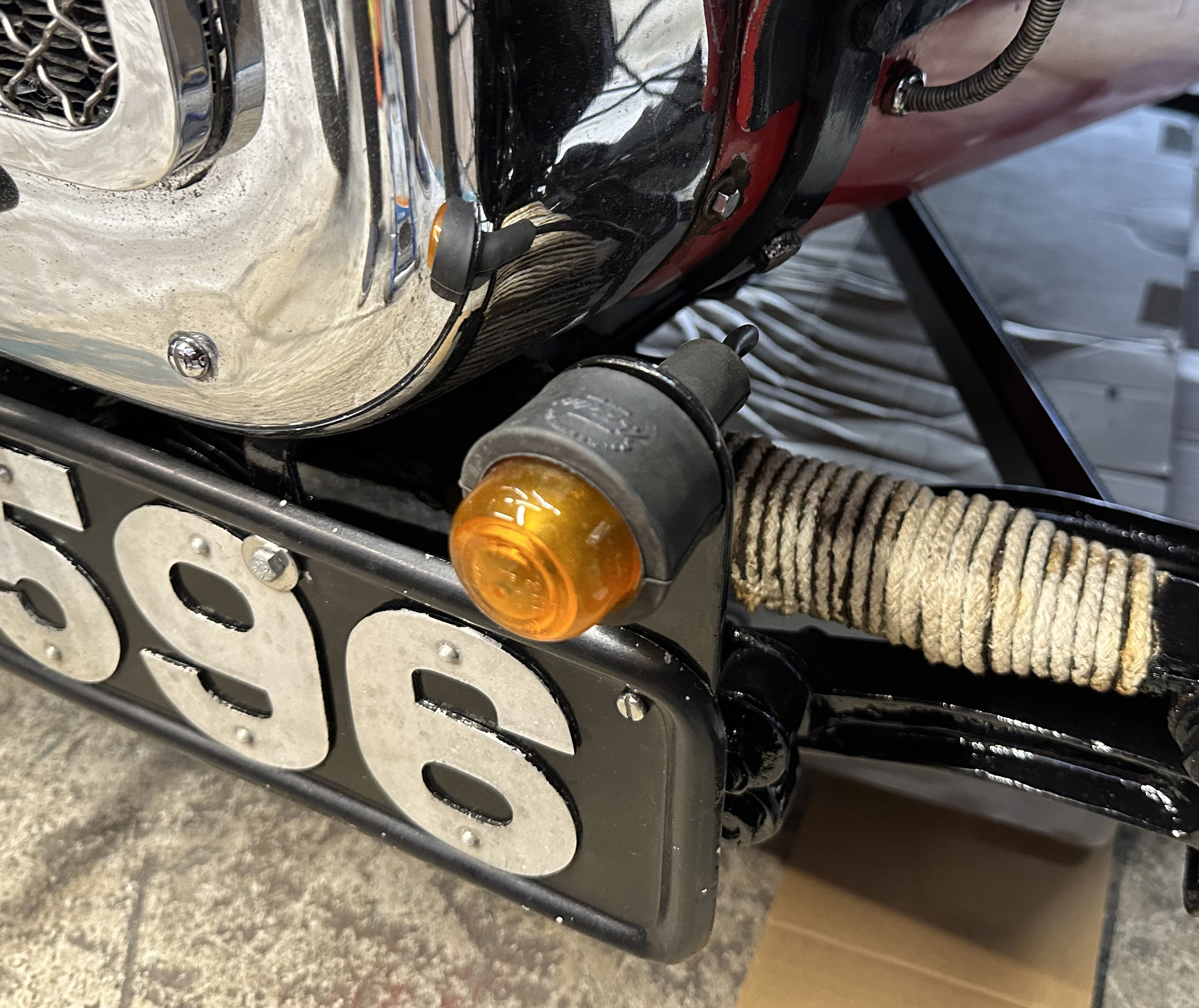

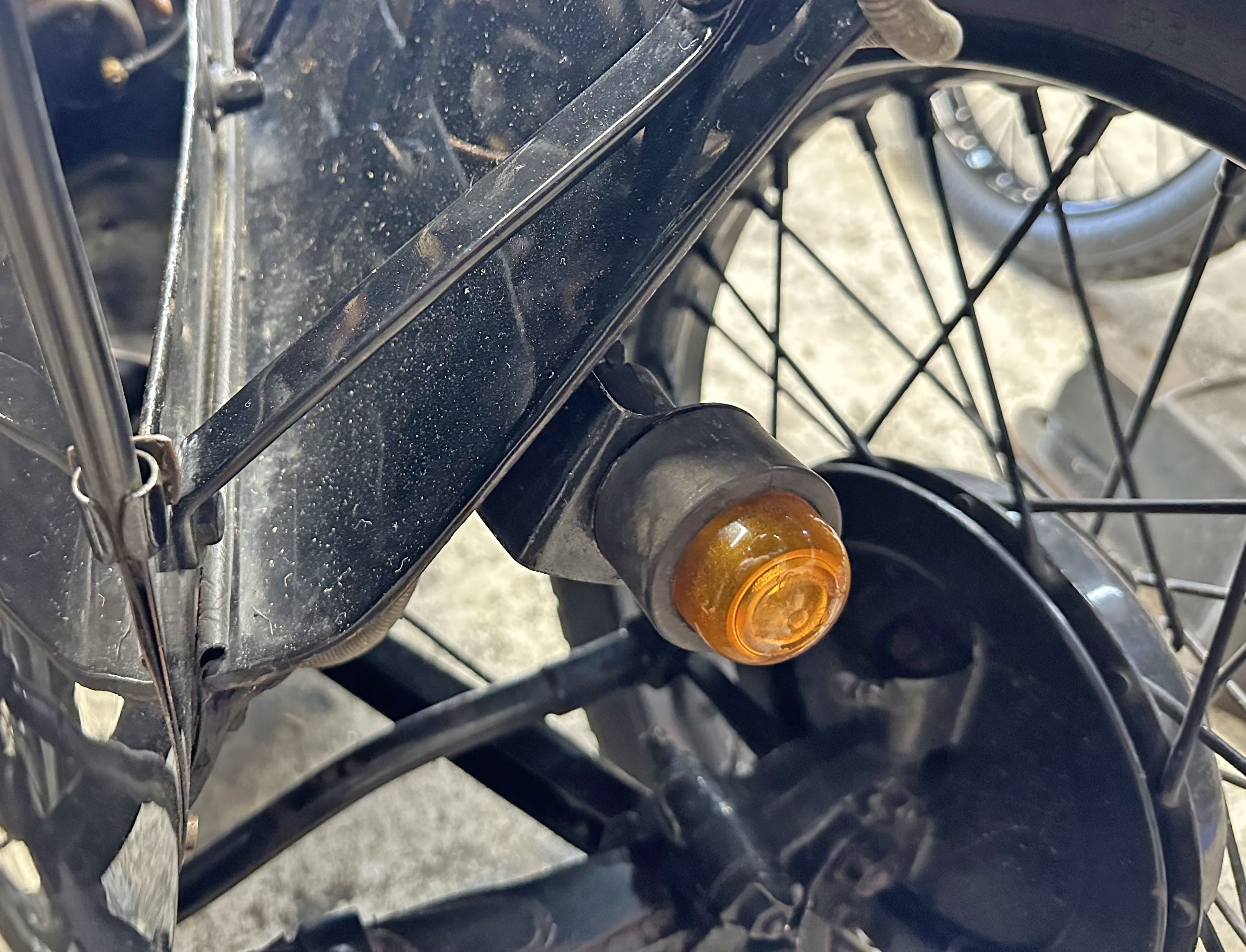

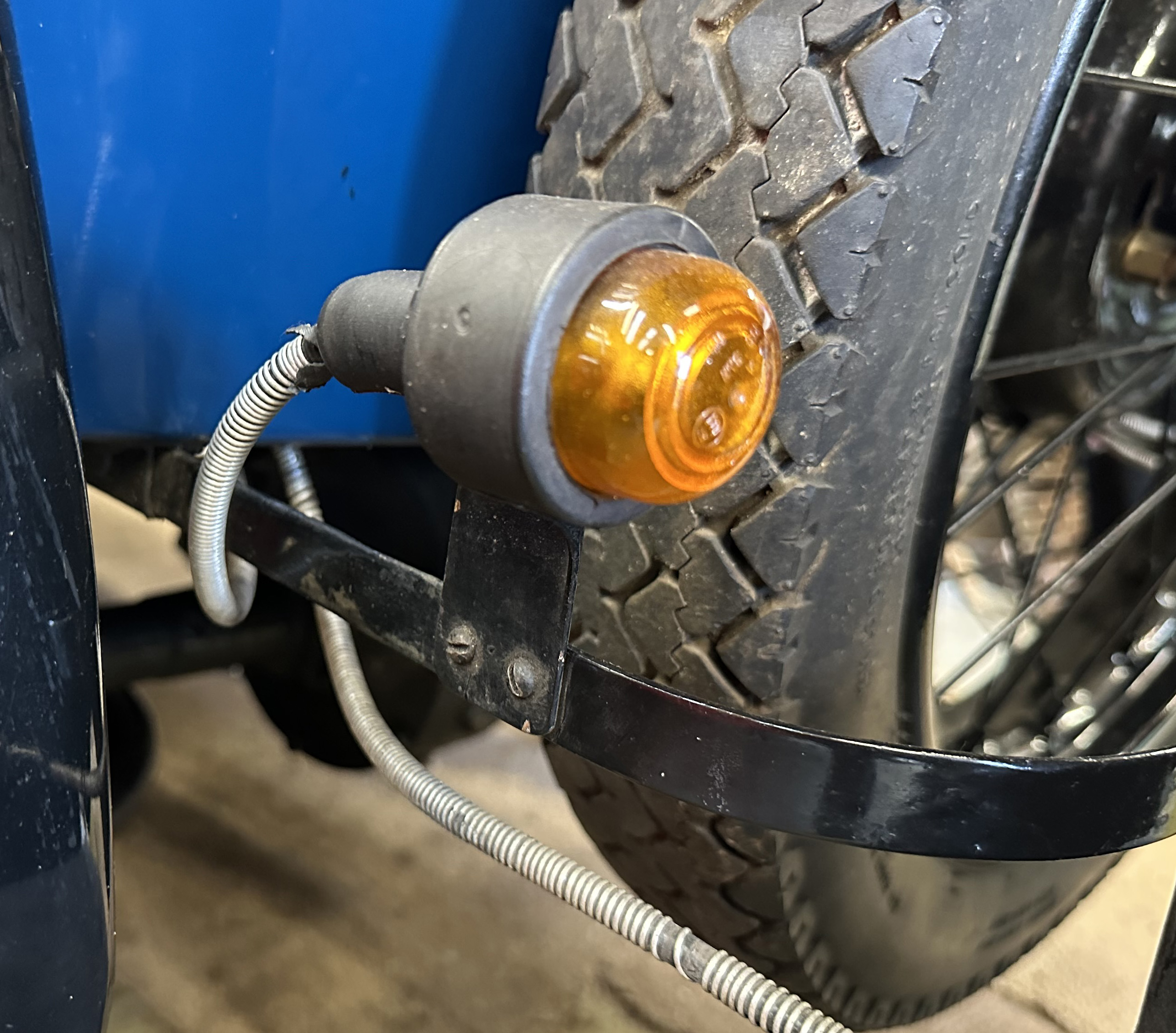

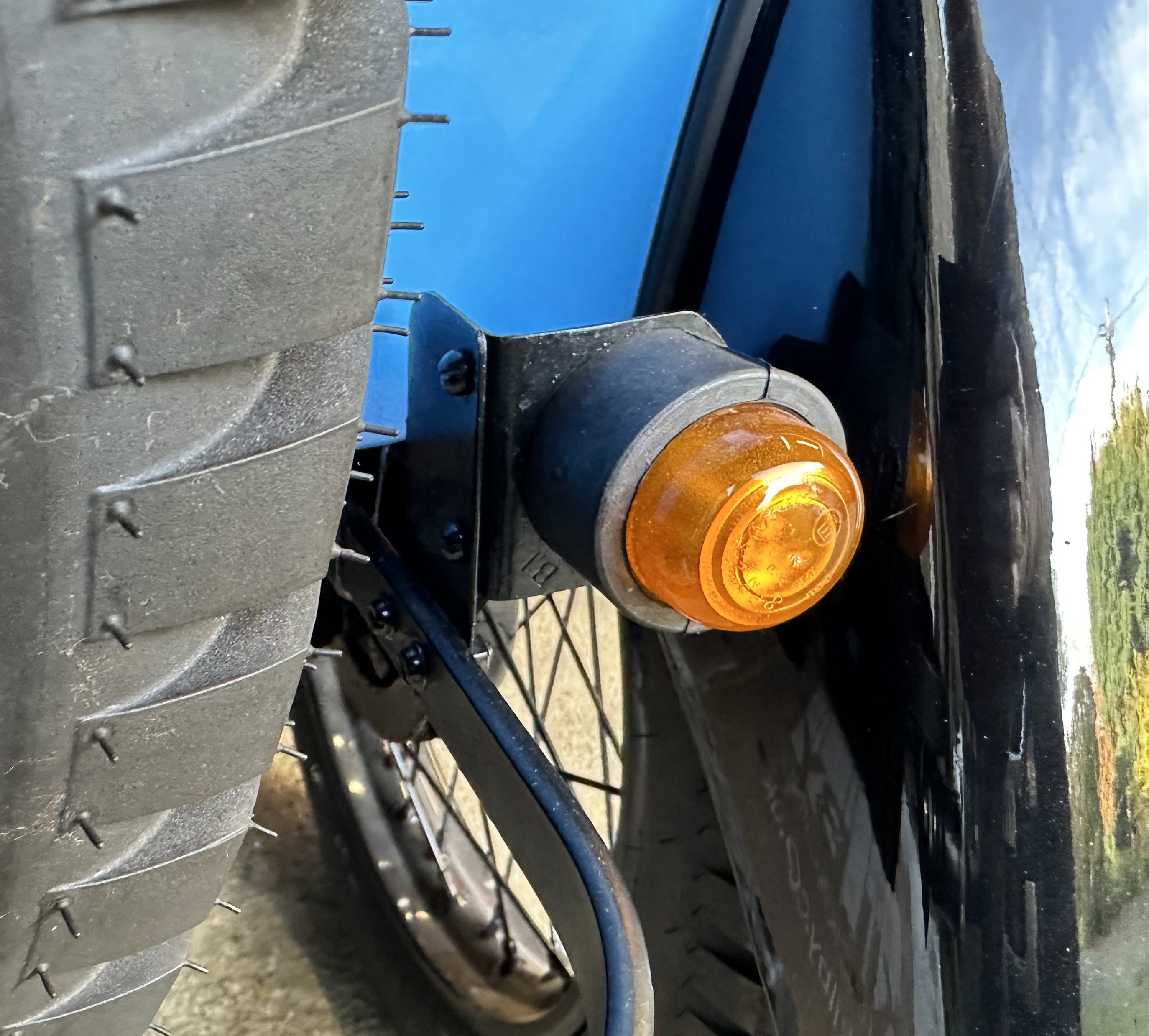

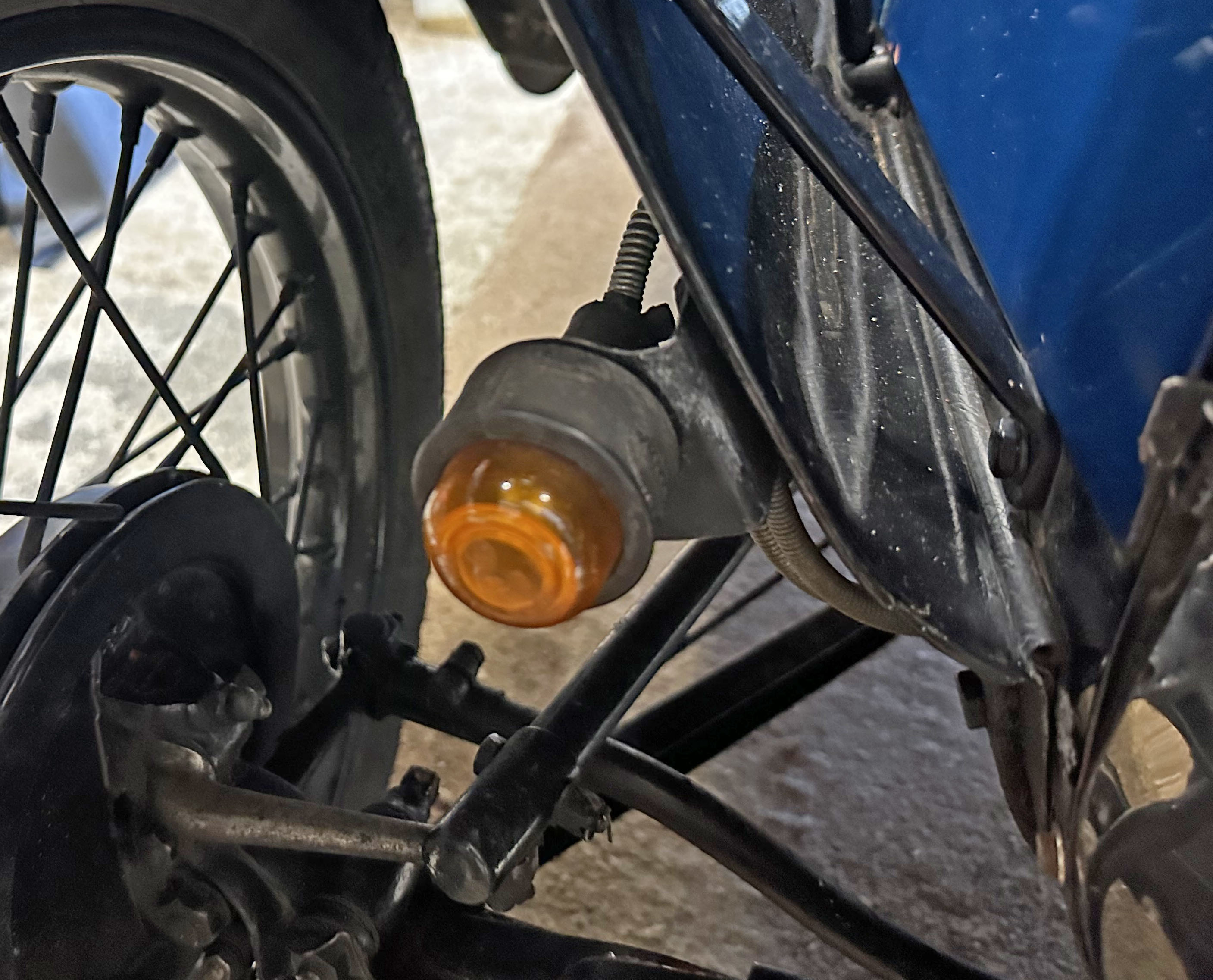

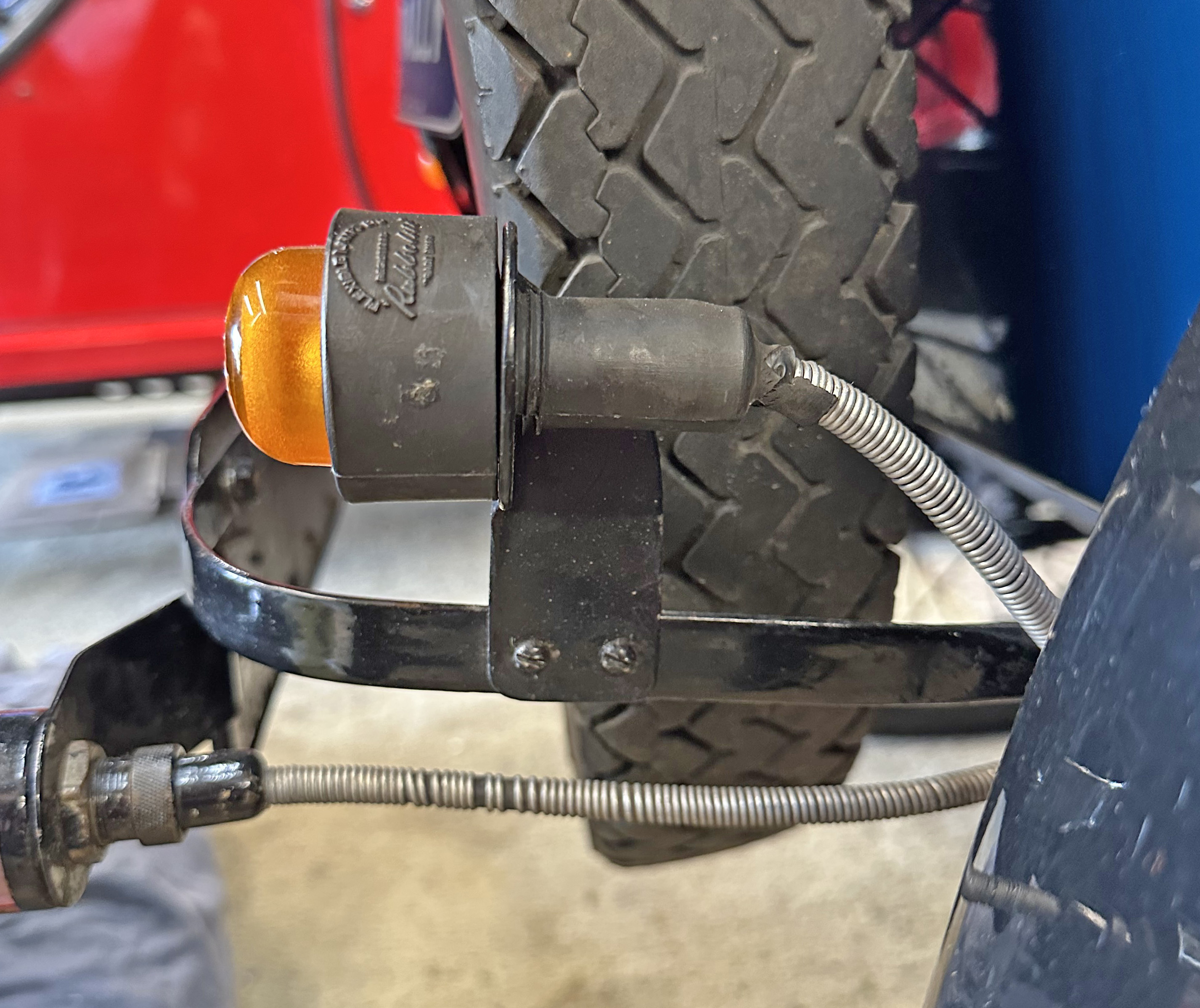

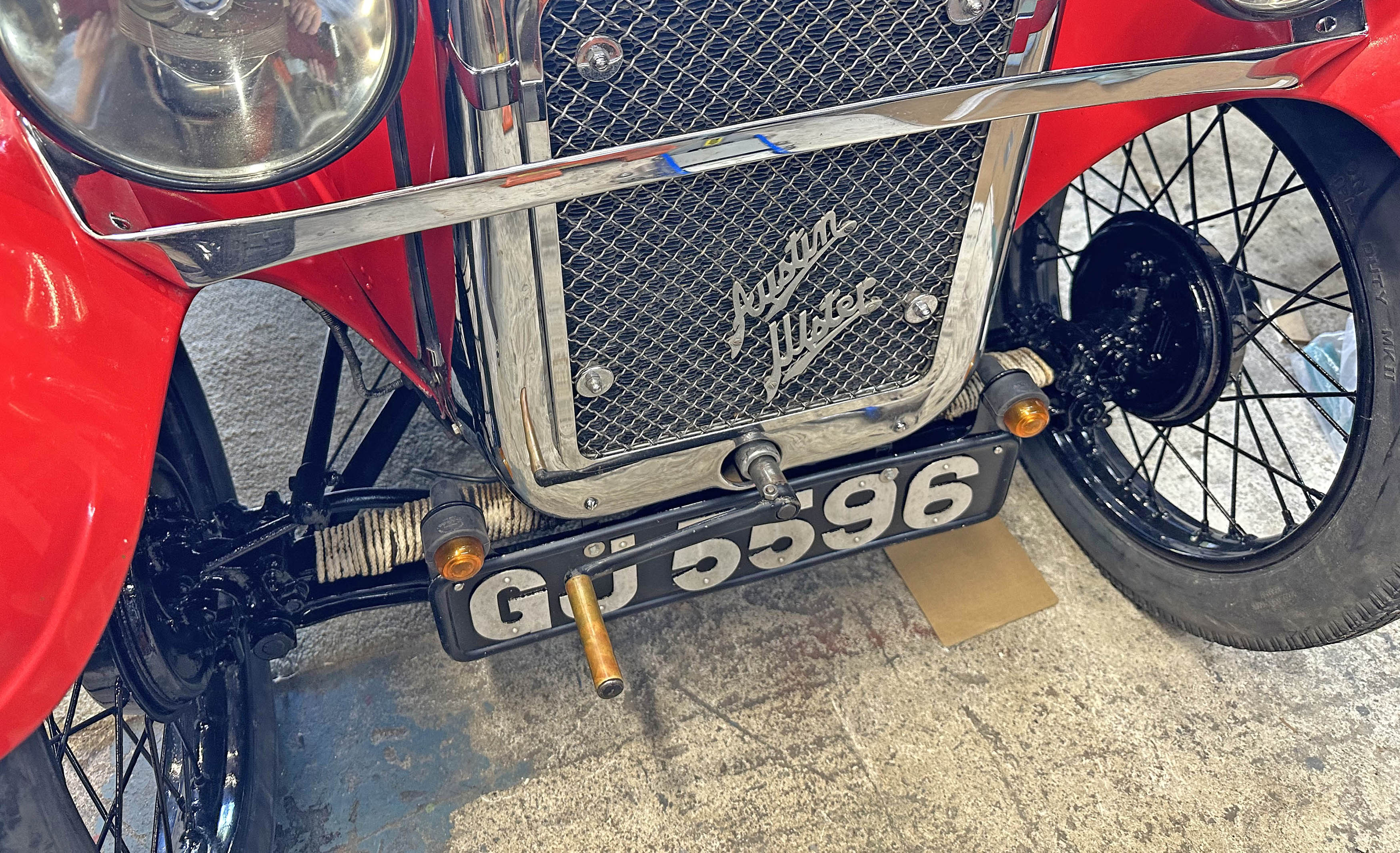

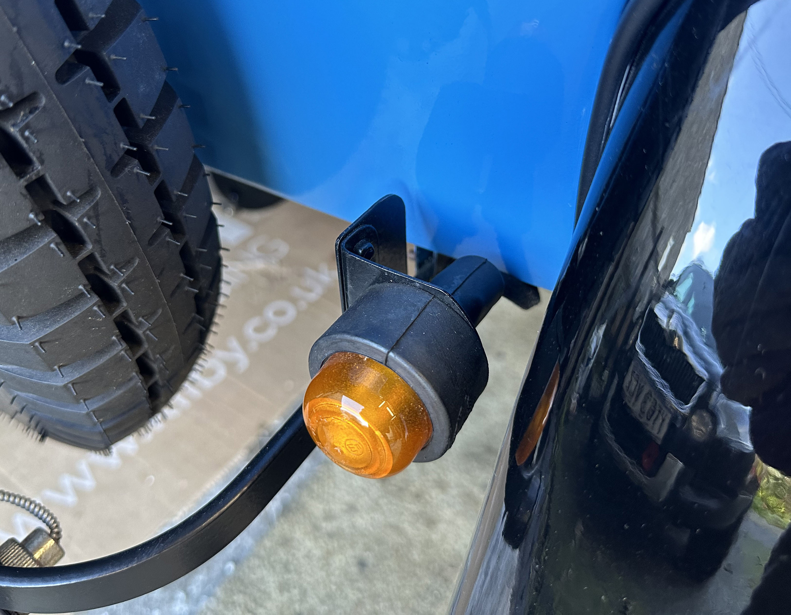

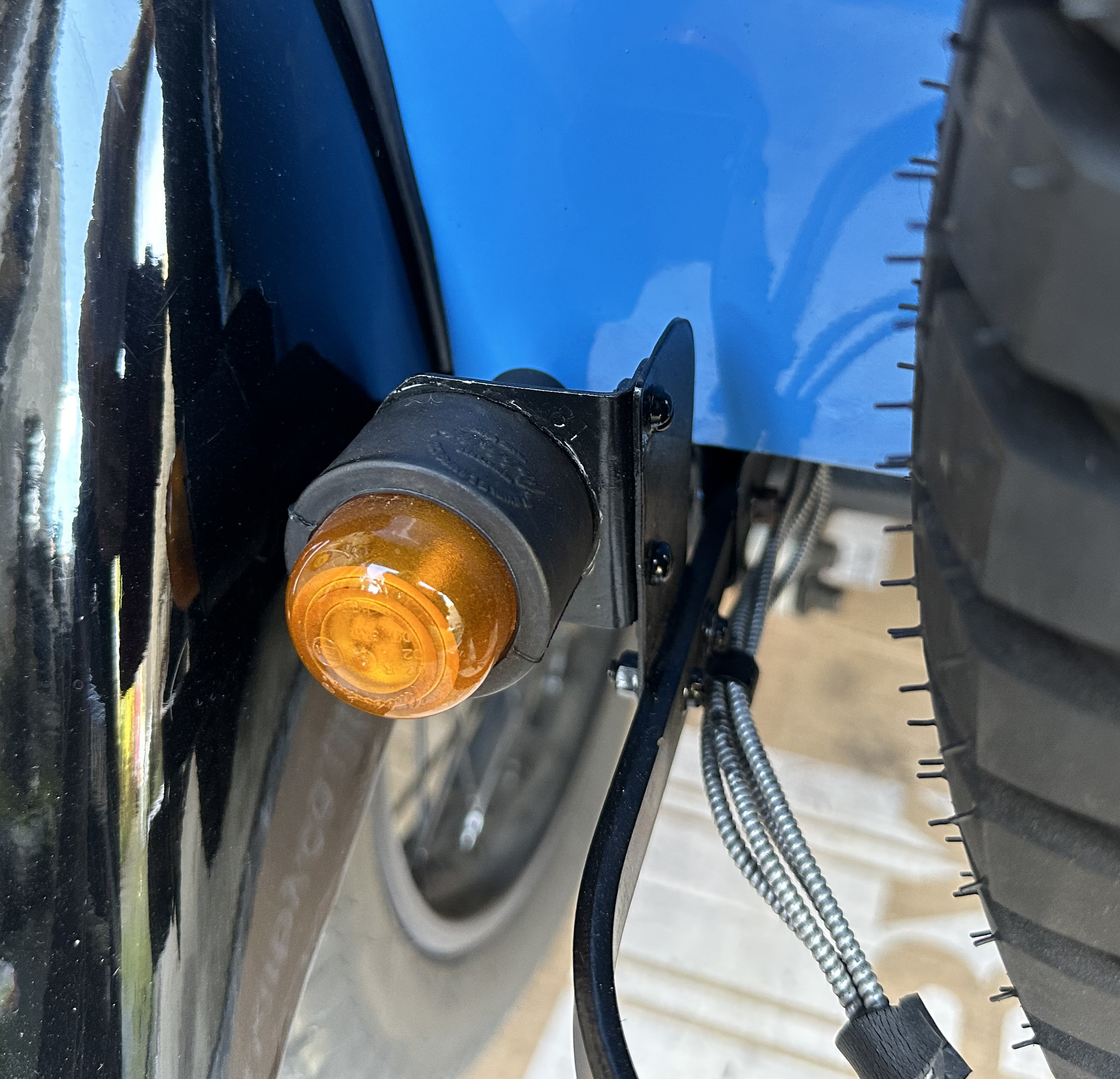

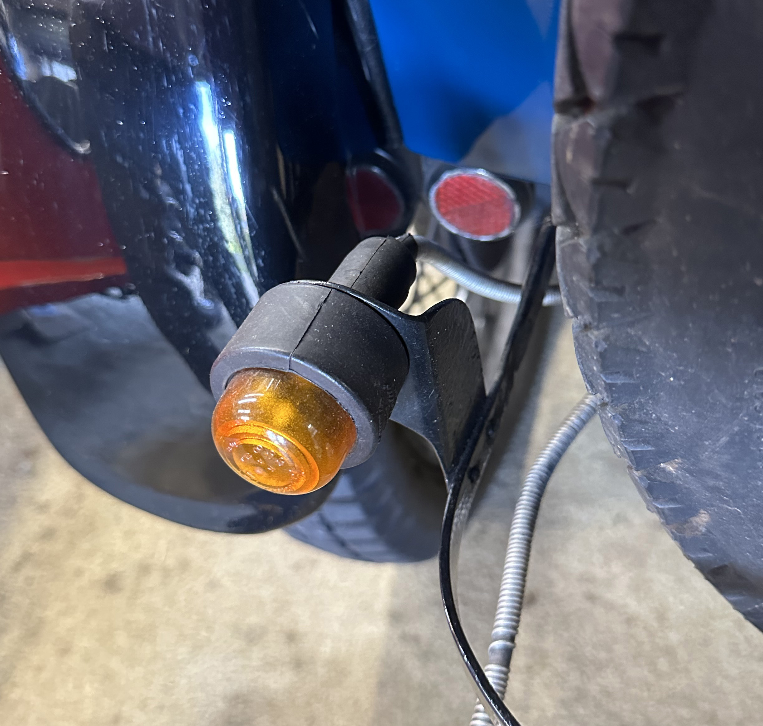

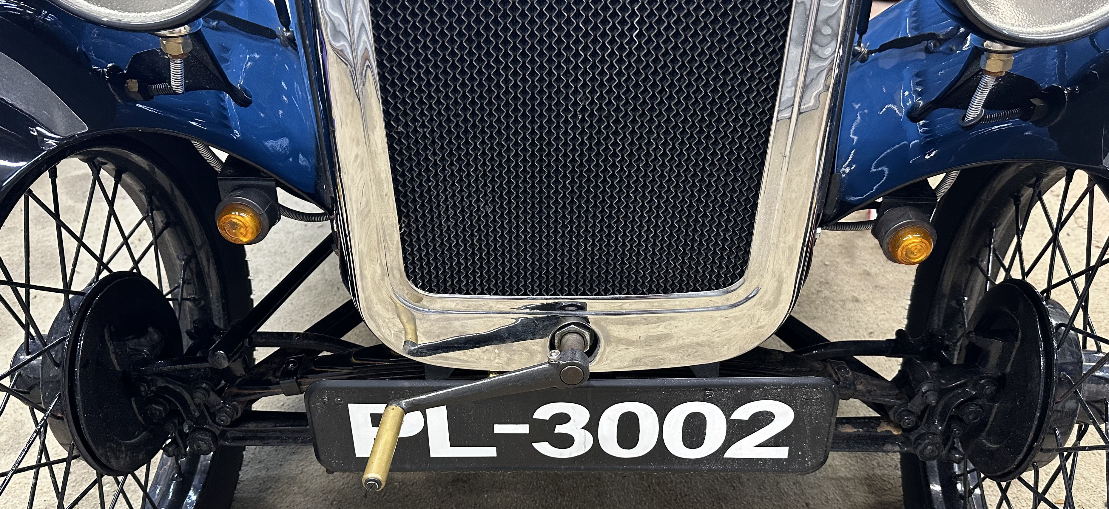

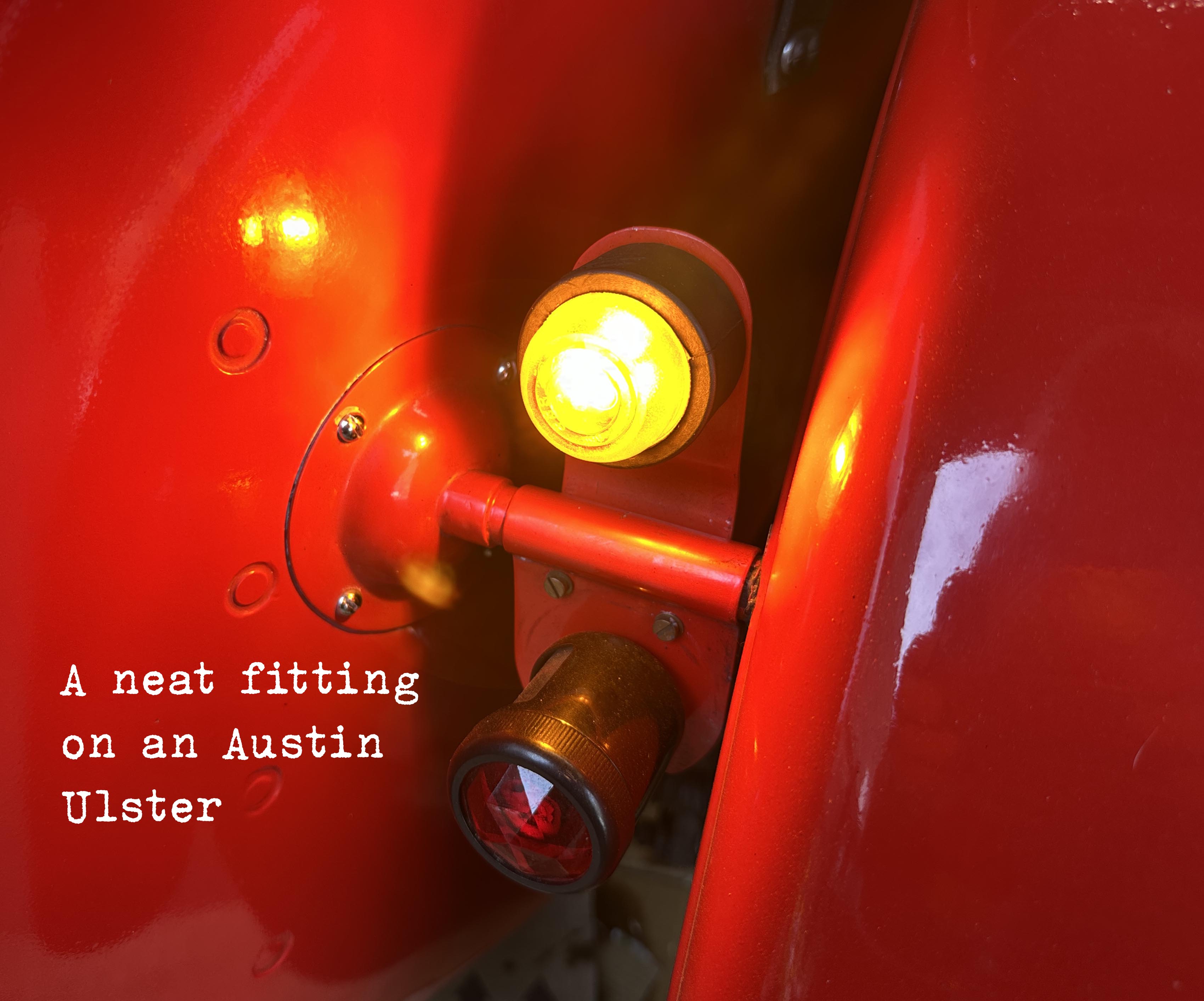

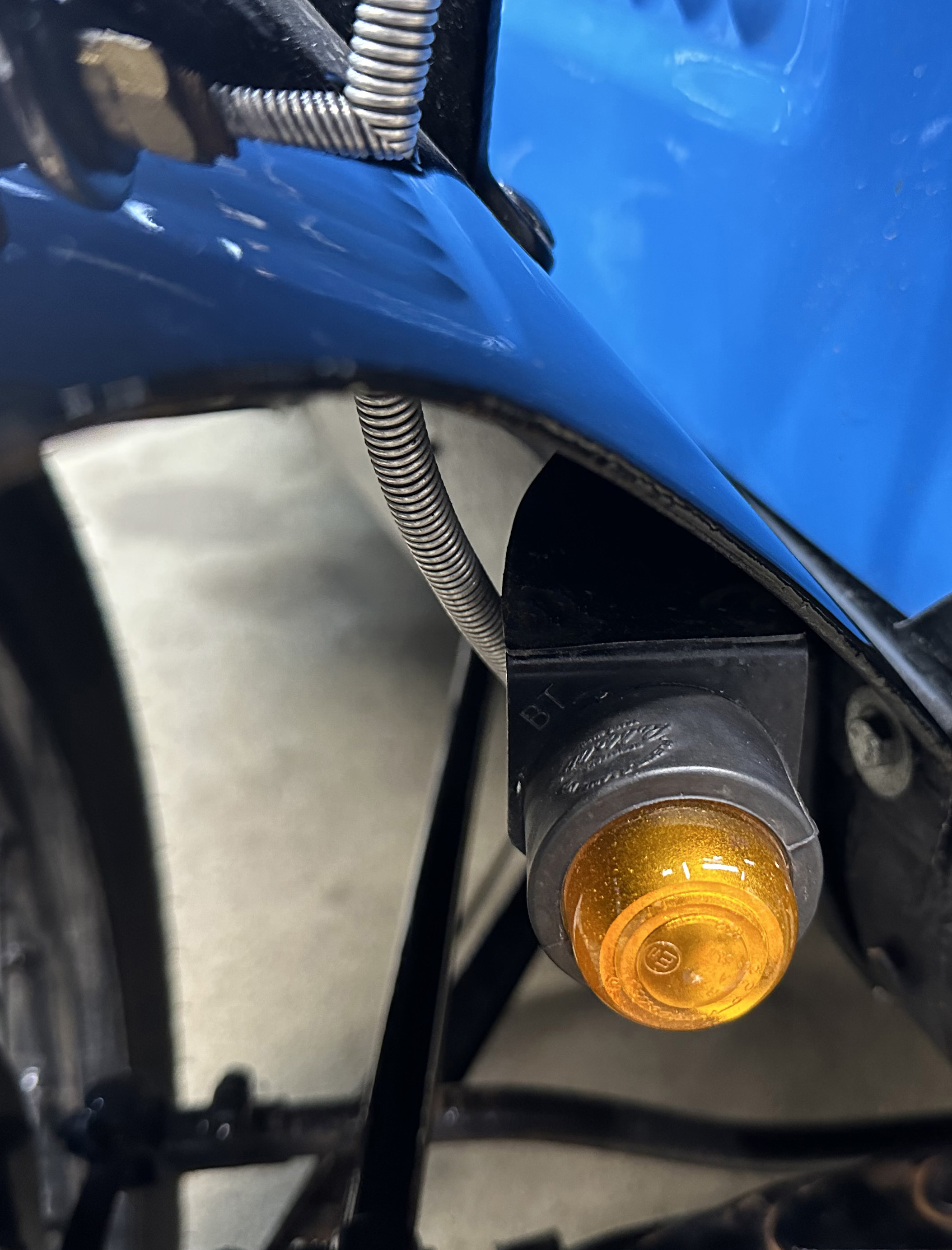

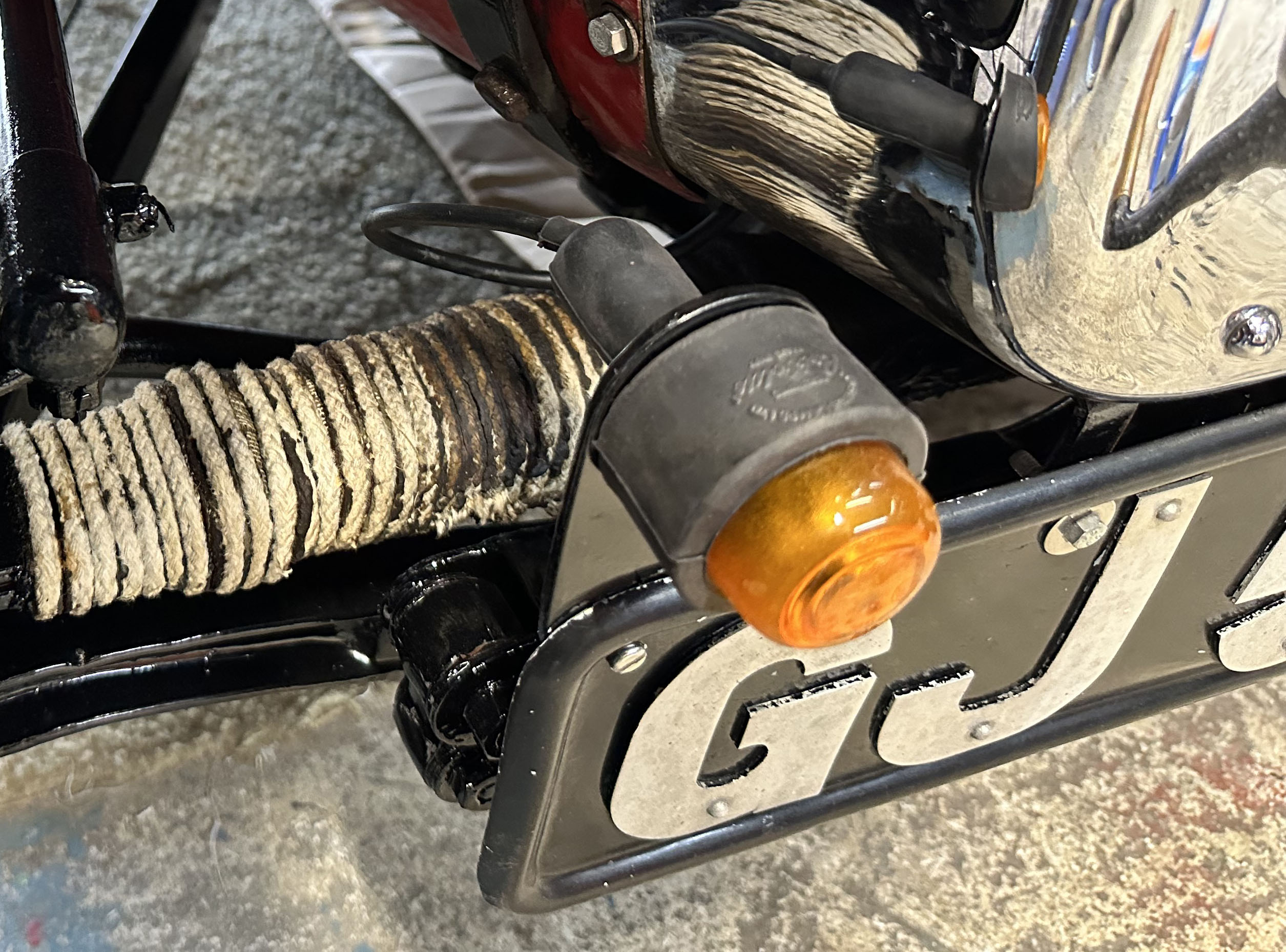

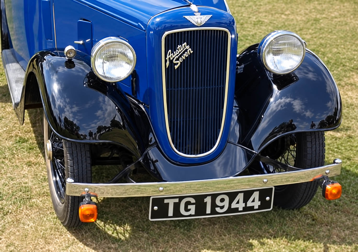

Indicators need to flash between 60 and 120 times a minute, but where should they be mounted? The ideal place is high up and as widely spaced as possible; however, in many cases, this is impossible, and some compromise has to be made. On an Austin 7 built before 1932, using the original lights, some form of brackets will be necessary at both the front and rear. The photographs below show the various shapes and mountings of brackets that might be helpful. On a Box saloon, Ruby, or other late versions with both rear wings carrying tail and stop lamps, the indicators can often be combined inside those, with various specialists offering such conversions that obviate the need for separate indicators. Some people have even fitted the indicators inside the headlamps, using special dual-purpose, white/amber LEDs. Search this website for the various options and it is possible to buy lamps with an indicator function built in. e.g. this company offers a wide selection some of which might be suitable

A wide variety of lights is available, allowing one to choose from the large and obvious to the smaller and somewhat more subtle. The best balance between the two might be the ones that I've fitted on my older cars, a mini "Rubbolite" type that comes with a set of simple right-angle brackets. On one car, I've fitted them to brackets secured to the front wing stays and, at the back, on the number-plate support arm. Willie McKenzie has the flashers as a complete kit on this pagehttp://austinrepro.com/headlamps .... Other suppliers also have them. An alternative - though very expensive - might be this one

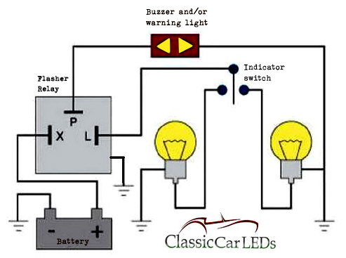

If you have a 2-terminal flasher unit - and hence no way of connecting a buzzer or light - when using an LED system, it's possible instead to wire in two 'grain of wheat' LEDs, one connected across the contacts to the left flashers, and the other to the right.
If, on an LED system, you  wire in a tungsten warning bulb it might well take so much current that the flashers will refuse to work; if you fit a buzzer that too will need to take the minimum amount of power. The buzzer and the warning light are both connected to the third terminal of the flasher unit usually marked 'P' . A search on eBay will reveal what you need - I found a good selection by searching for 12-volt cab indicator buzzer.

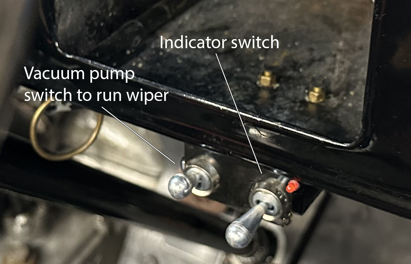

To keep things looking neat - and as inconspicuous as possible -  if you make a small bracket to carry the switch (like the one shown below, bolted to the underside of the driver's side glove pocket) it can also be made long enough to carry, on its underside, both the flasher unit and the buzzer. If these are secured with doubled-sided tape or Velcro and fitted with long enough cables, if any part fails, it's a simple job to unbolt and replace it. Alternatively, I have seen a system where all the components were mounted on a piece of thin plywood fastened high up on the inside, right-hand face of the scuttle. With long cables, this could be detached and brought out beyond the steering wheel, and so very easy to attend to.

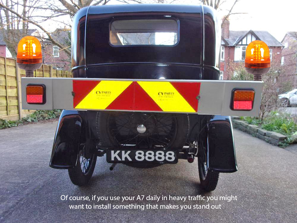

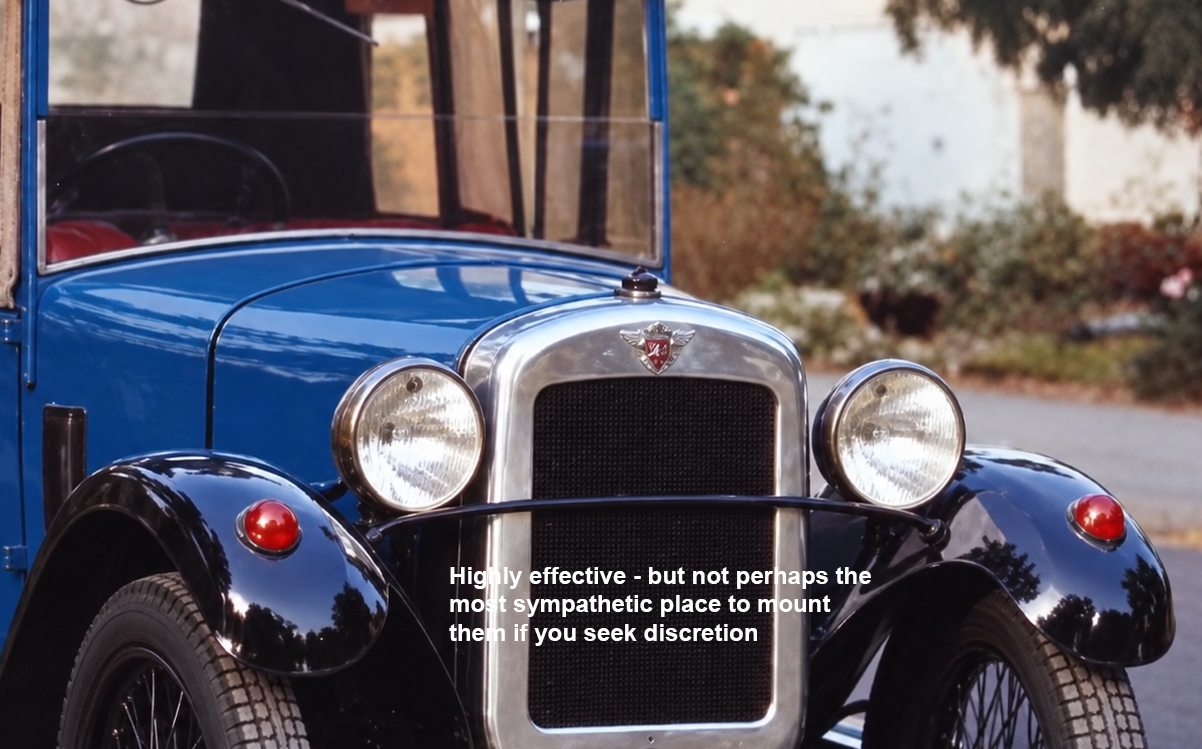

Large, wide and doubtless very bright, but perhaps rather spoiling the car's lines?
