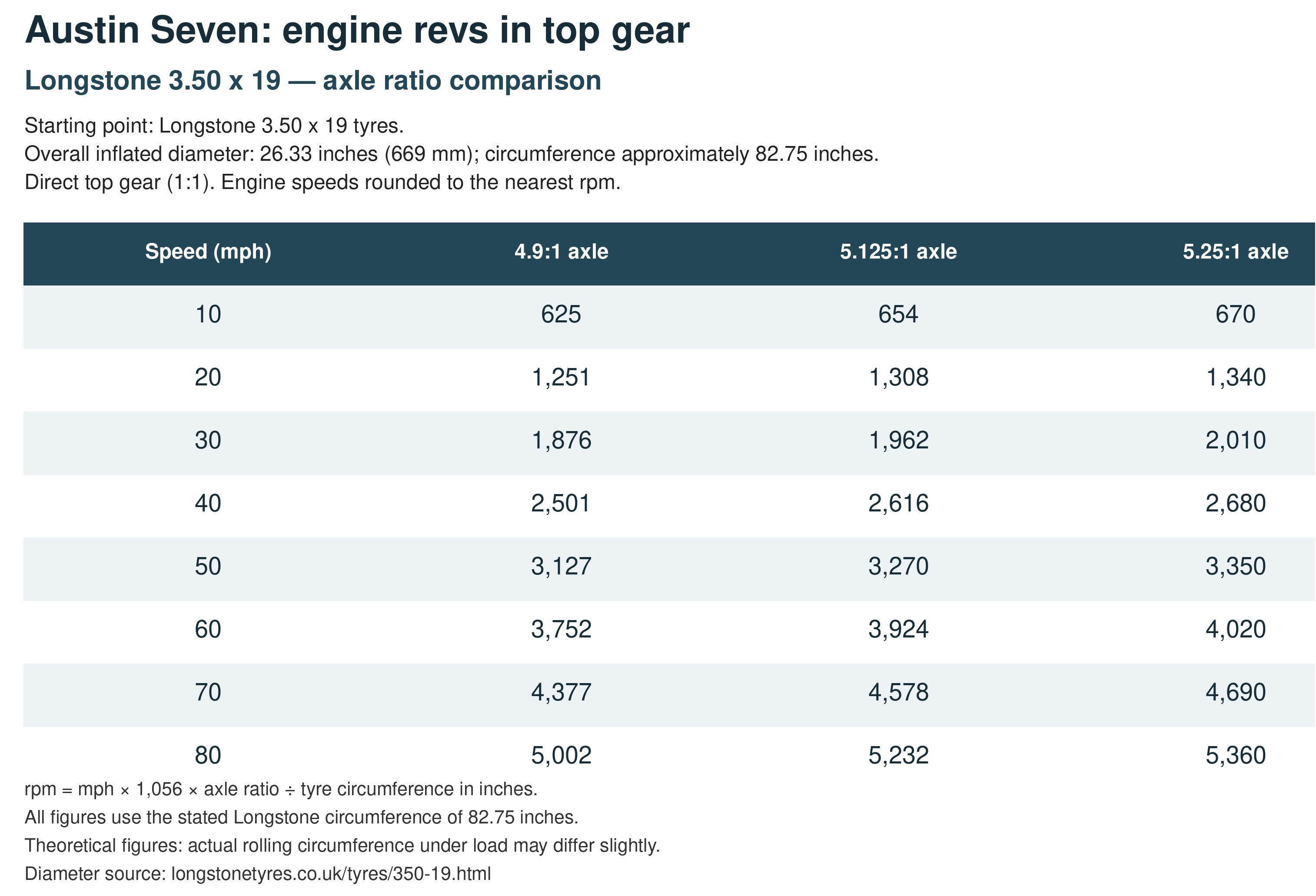

If you're used to driving a turbo-diesel or large-capacity modern petrol car, it's not unusual for an Austin 7 engine to sound and feel as though it's revving hard. The reality is more sobering: in ordinary use, with standard gearing, wheels, and speeds rarely reaching 50 m.p.h., the revs rarely rise above 3000 r.p.m. in top gear.
The first chart shows the engine revs achieved by a typical Seven, with a 4.9, 5.125 and 5.25 back axle and 3.30 x 19 tyres.

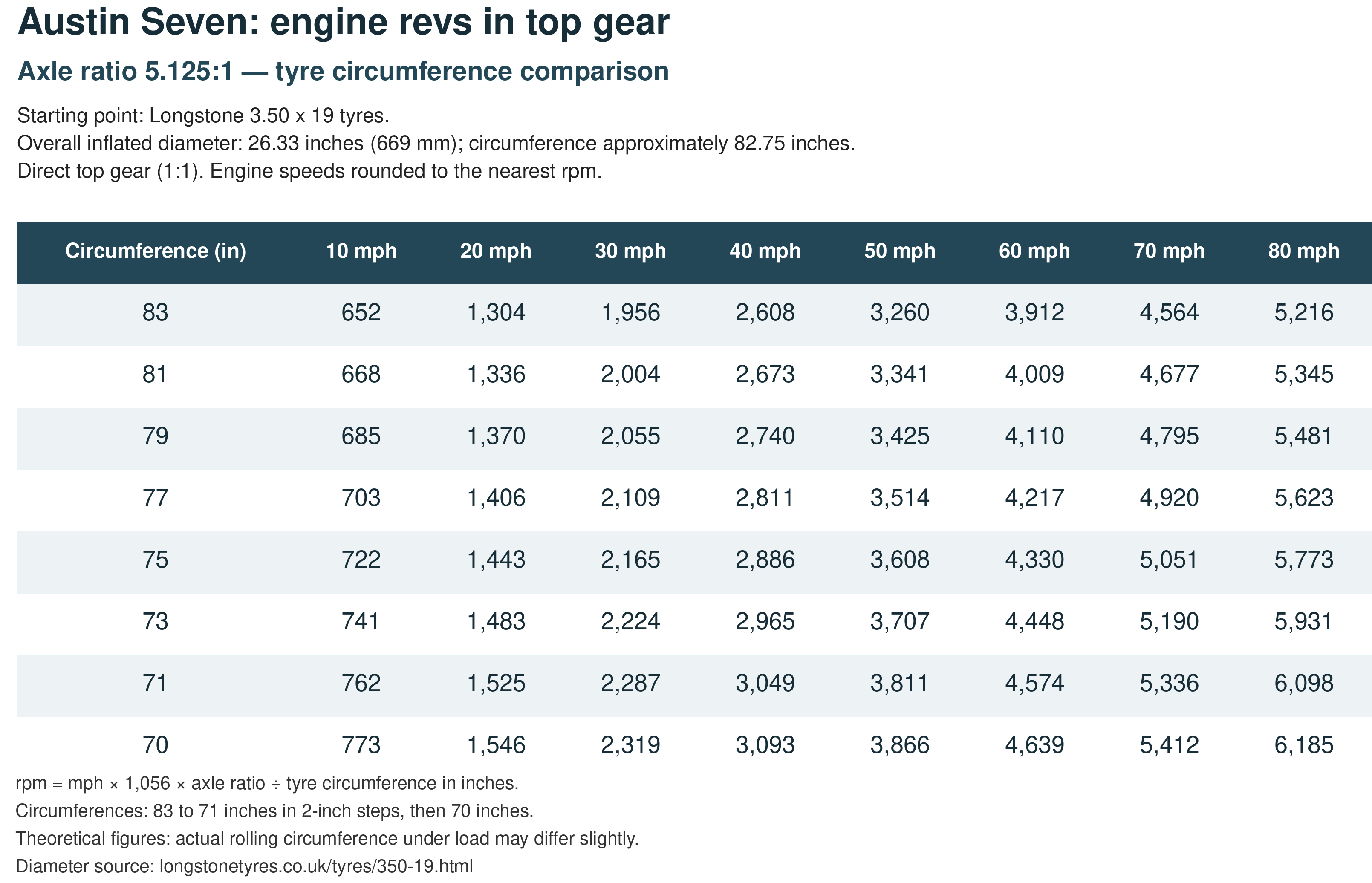

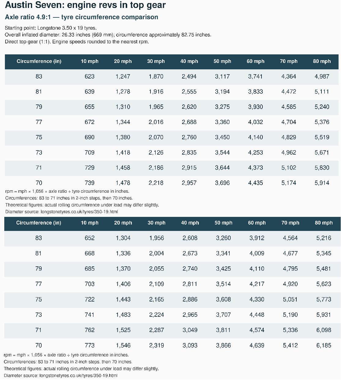

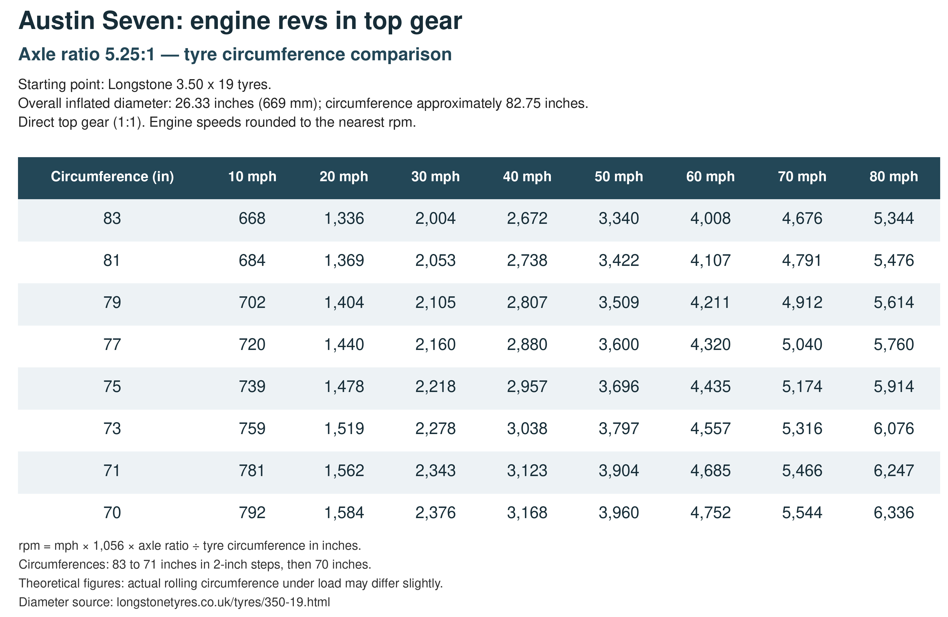

The following charts expand to list the revs achieved with tyres of different circumference, the starting point being 83 inches, just above the 82.75" of a standard 3.30 x 19, and going on to 70", which if about the circumference of a 15" rim fitted with a 4.5 or 5" tyre might be.
Of course, you need to measure your tyres' rolling circumference carefully and, if you have a different-ratio back axle, use the following description to calculate it yourself.
The charts use the following formula for top gear, where the gearbox turns the propeller shaft once for every turn of the engine (as it does in an A7):
Engine rpm = (speed in mph × 1,056 × axle ratio) ÷ tyre circumference in inches

An example at 40 mph
For the first chart, I used the stated approximate circumference of 82.75 inches for the Longstone 3.50 × 19 tyre.
Distance travelled each minute:
40 × 1,056 = 42,240 inches
Wheel turns each minute:
42,240 ÷ 82.75 ˜ 510.45 rpm (˜ means approximately, or in this case, near enough...)
Engine turns each minute with a 4.9:1 axle:
510.45 × 4.9 ˜ 2,501 rpm
Changing to a 5.25:1 axle, while keeping the same tyres and road speed, gives approximately 2,680 rpm. The higher 'numerical' axle ratio (oddly, we call that a lower-axle ratio) makes the engine turn more times for each wheel turn.

The charts give, of course, theoretical figures based on the stated tyre circumference. For the closest match to the actual car, use its measured rolling circumference. The charts use 4.9 exactly; the familiar 44-tooth crown wheel and 9-tooth pinion give an actual ratio of 4.8889:1--a very small difference. I've no idea how much a 3.50 x 19 tyre expands at 80 mph....
