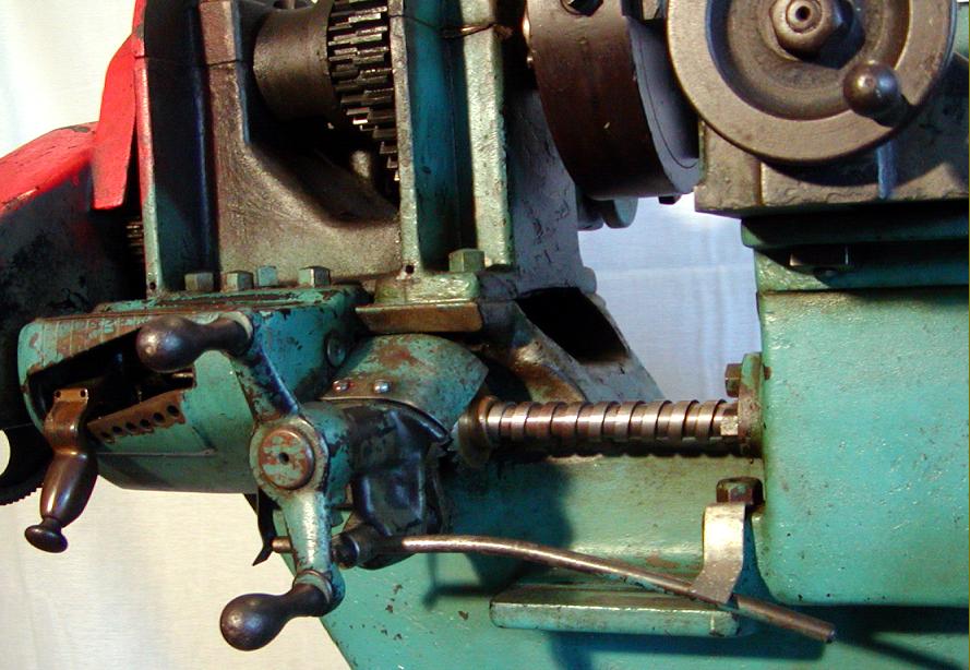

A set of five grooves, turned into the gearbox input shaft, allowed the large final-drive gear to be positioned correctly in relation to the others - it being necessary only to drop the gear's spring retaining clip into the correct one.
Leadscrew dog-clutch engaged
Leadscrew dog-clutch disengaged

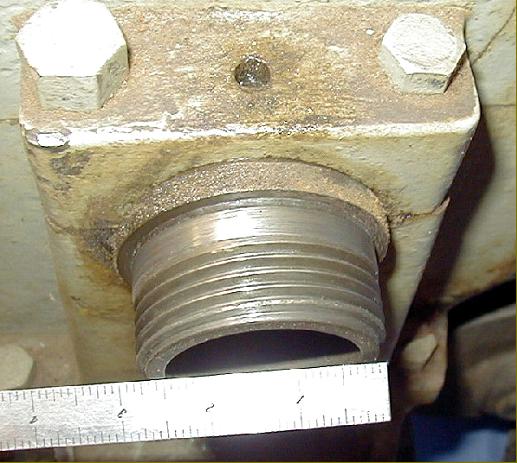

The substantial headstock bearings held a spindle with a 21/8" x 8 t.p.i. nose and a 1.25" through bore.
