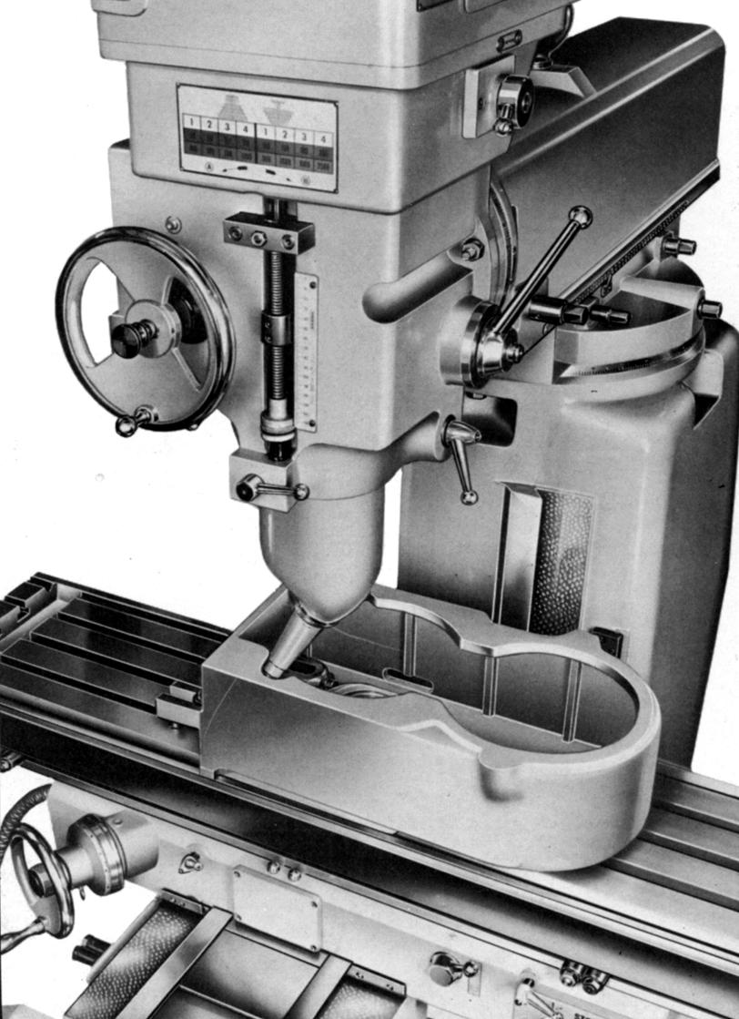

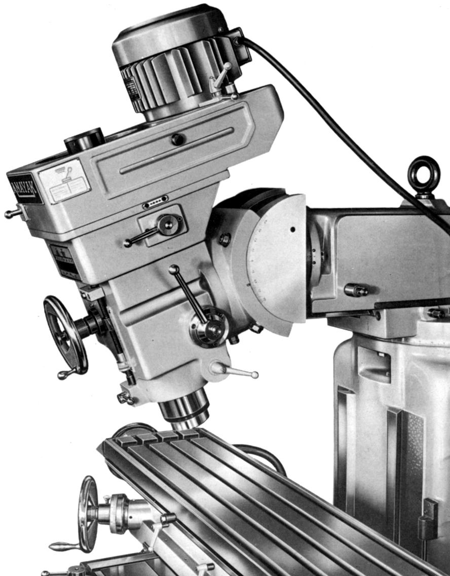

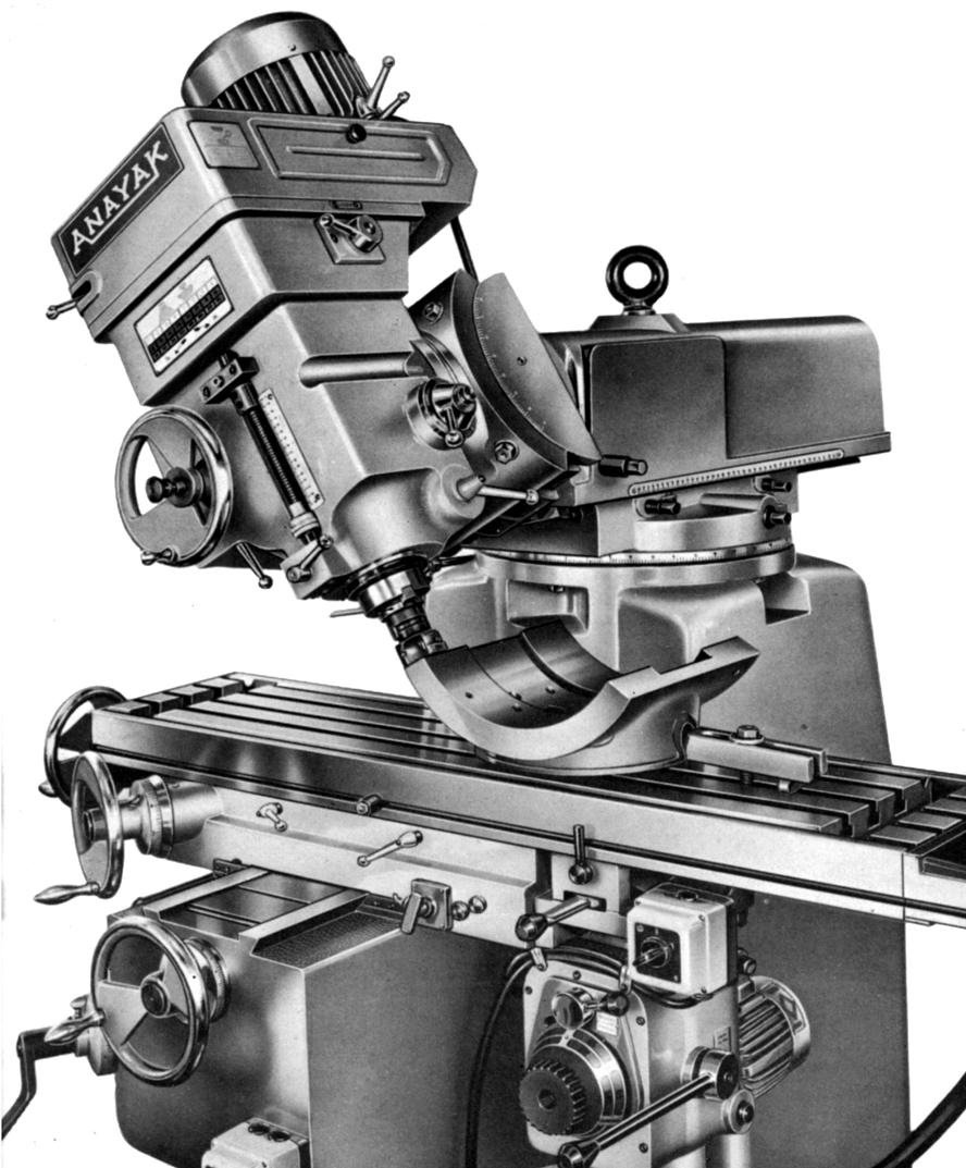

Unlike the smaller Anayak millers, the FV-1 and FV-2, the two larger models were not fitted as standard with a "nodding" head. Instead, this facility was offered as an option and (in place of the usual less rigid clevis joint) used a ram-end adapter formed with a convex semi-circle of its front face to which the standard head (fitted with a similar concave unit on its mounting face) was bolted. With huge contact faces spread over 180°, the rigidity was much improved and head held firmly despite its considerable weight (though it did incur the disadvantage of increasing the distance from spindle line to the inside face of the column by 7.25" (184 mm)). Equipped with this fitting the head could be swivelled 90° (45° forwards or backwards) across the table as well as 180° in the table's longitudinal direction (see the illustrations below for details).

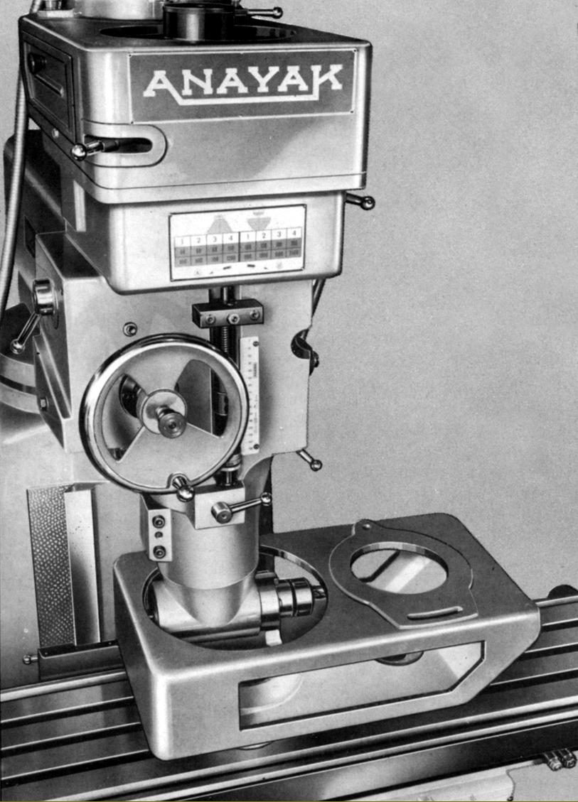

With a quick-action hand-lever for drilling and a handwheel for fine feeds, the spindle had 6" (150 mm) of travel under hand or power feed - the latter with three rates set at  0.0015", 0.003" and 0.006" (0.038, 0.76 and 0.152 mm) per revolution and fitted with automatic, pre-set disengage. Late models had, for some markets, an electronic infinitely-variable speed drive on the power downfeed - though what the rates were is not known. Just one spindle nose fitting was listed - an ISO-40 - but it is likely that others would have been available to special order.

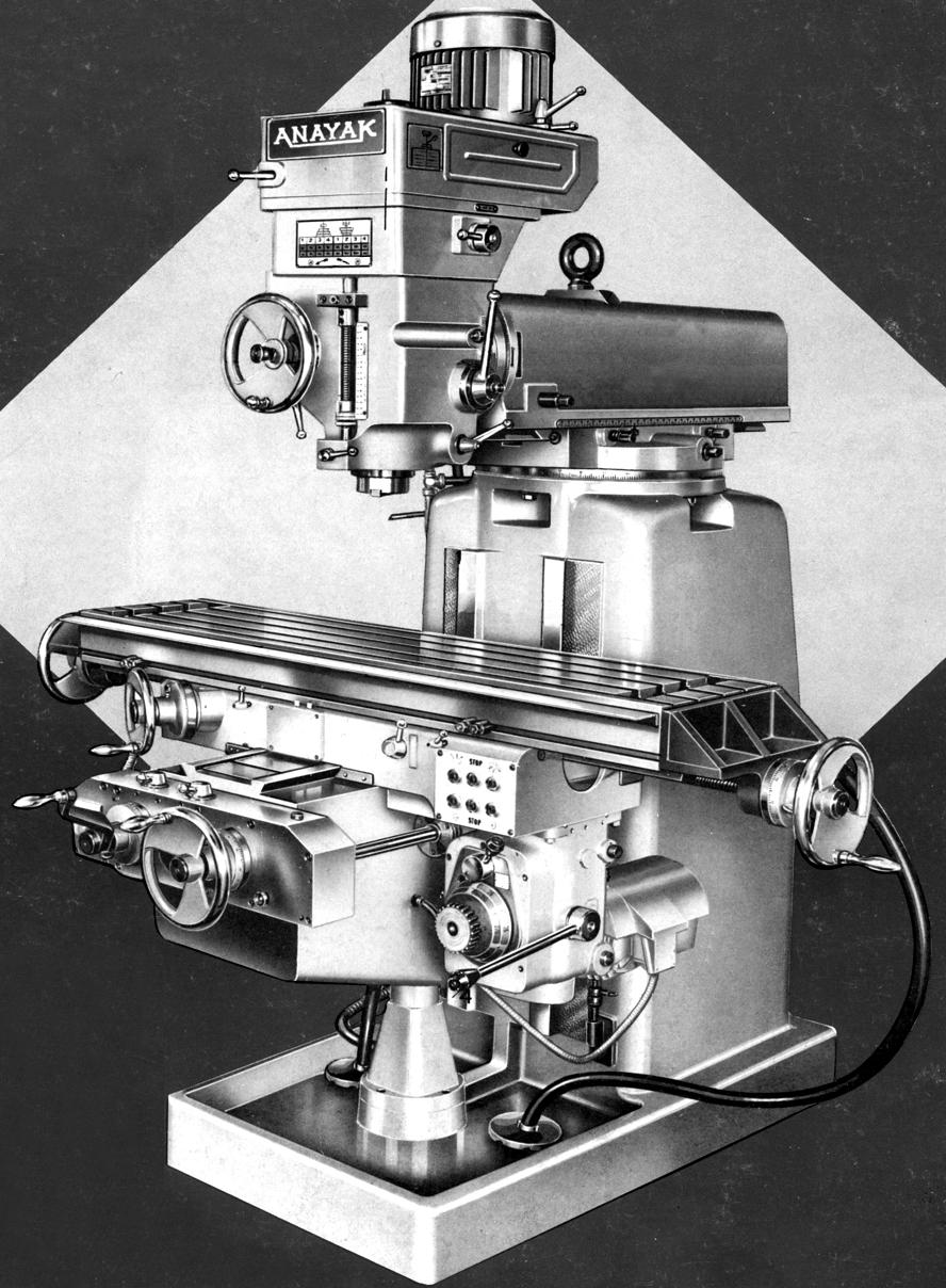

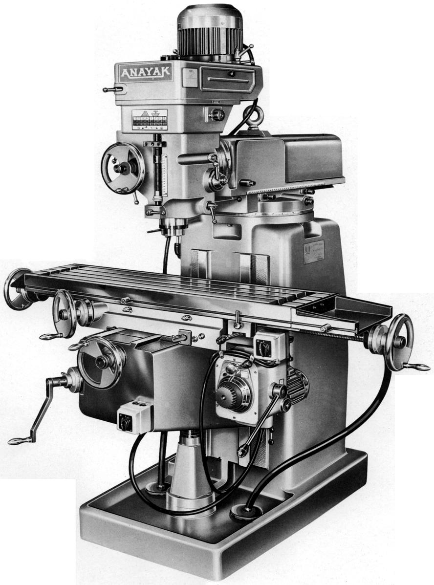

Anayak FV-4 in standard specification with power longitudinal and cross feeds - as sold in the early 1970s

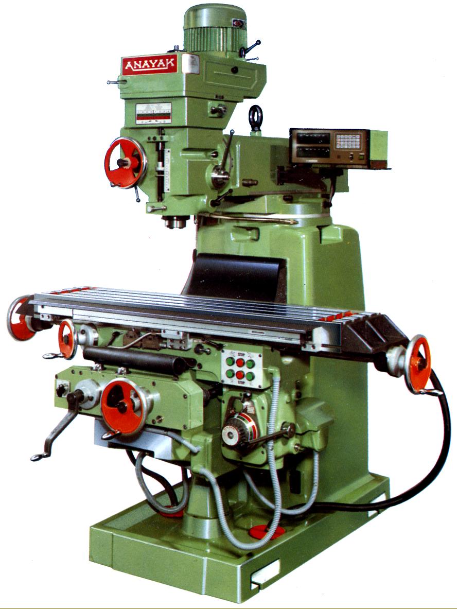

Anayak FV-4 as sold in the 1980s: power longitudinal and cross feeds, protected slideways and fitted with a DRO fitted -
Anayak FV-3 in standard specification from the early 1970s

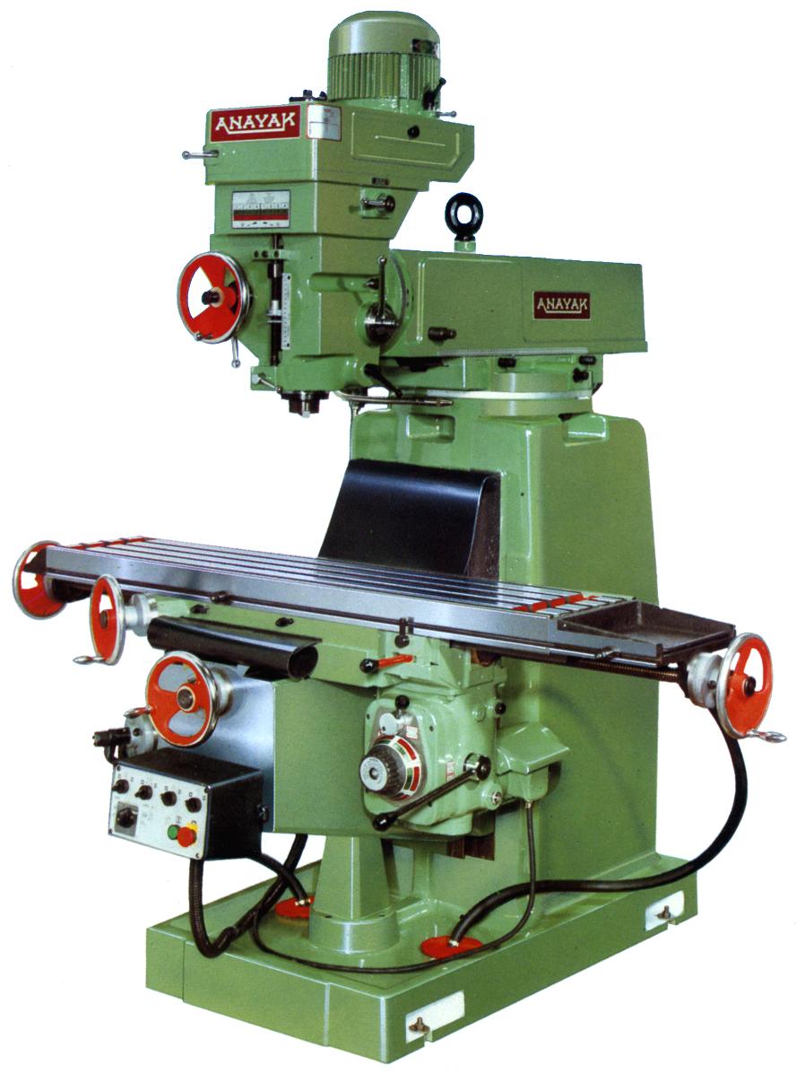

Anayak FV-3 in standard specification as sold during the 1980s

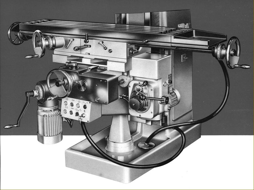

Anayak FV-3u Universal with swing table. power longitudinal and cross feed and an independent rapid vertical feed - the motor attached to the underside of the casting holding the knee rise-and-fall hand crank

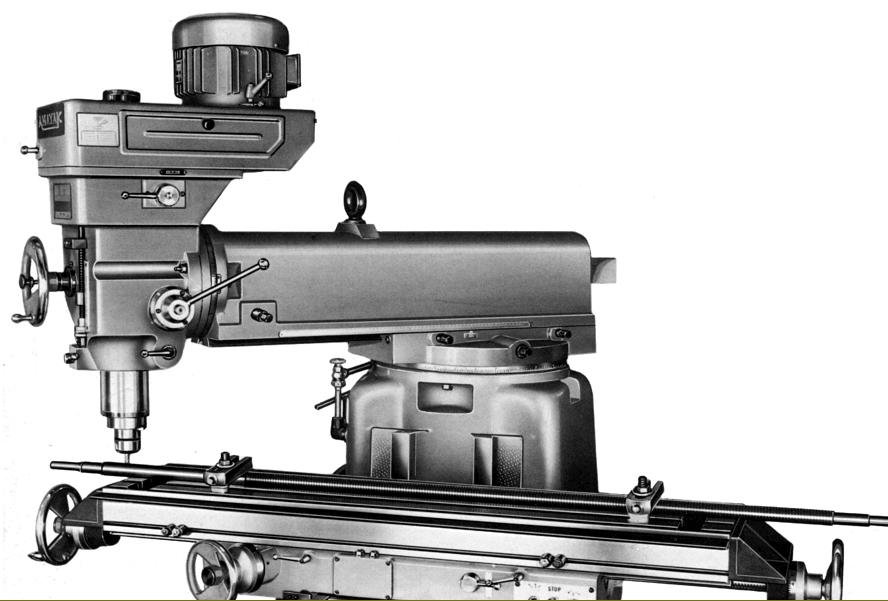

Unlike the smaller Anayak millers, the FV-1 and FV-2, the two larger models were not fitted as standard with a head that had a "nodding" action. Instead, this facility was offered as an option and (to replace the usual type of less rigid clevis joint) used a ram-end adapter formed with a semi-circle of its front face to which the standard head (fitted with a similar fitting on its mounting face) was bolted. With huge contact faces spread over 180°, the rigidity was much improved and head held firmly despite its considerable weight

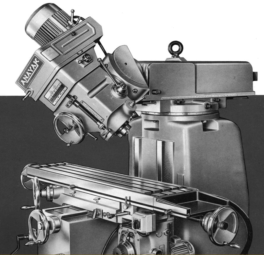

An extreme setting of table and turret

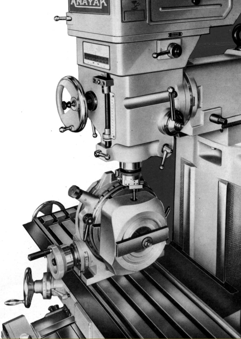

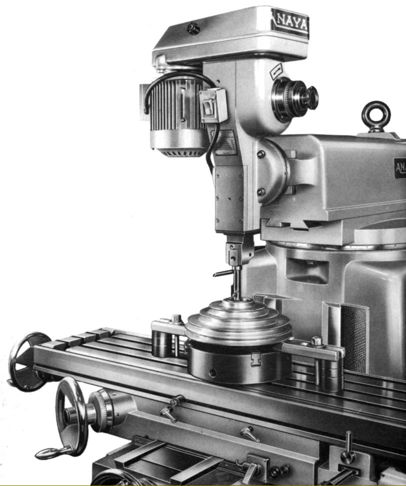

Spiral milling using a dividing head power driven through changewheels from the table feed screw

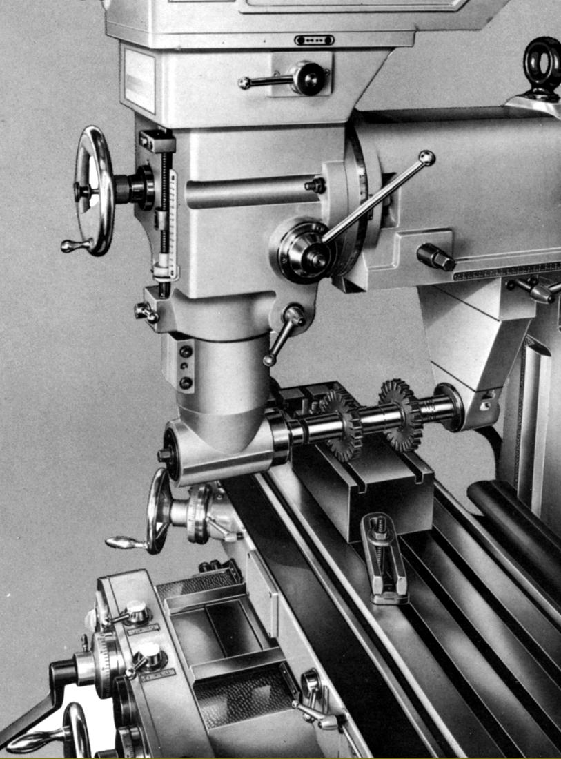

Right-angle milling attachment

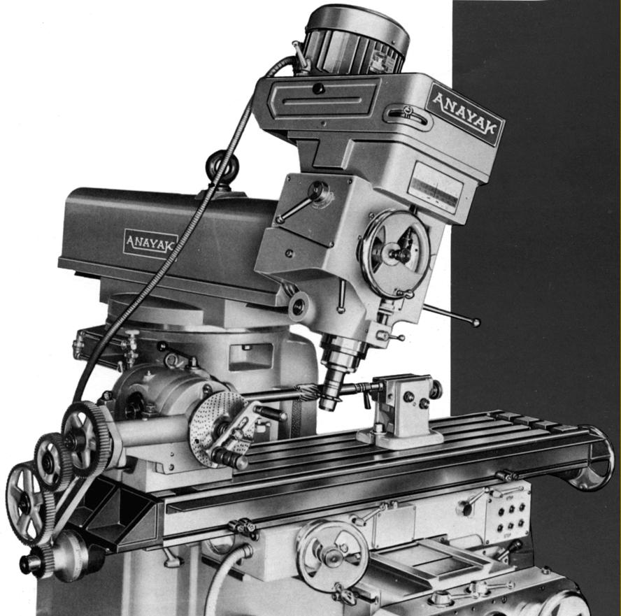

Horizontal milling with the right-angle attachment fitted with an inboard support bracket and horizontal cutter-holding arbor

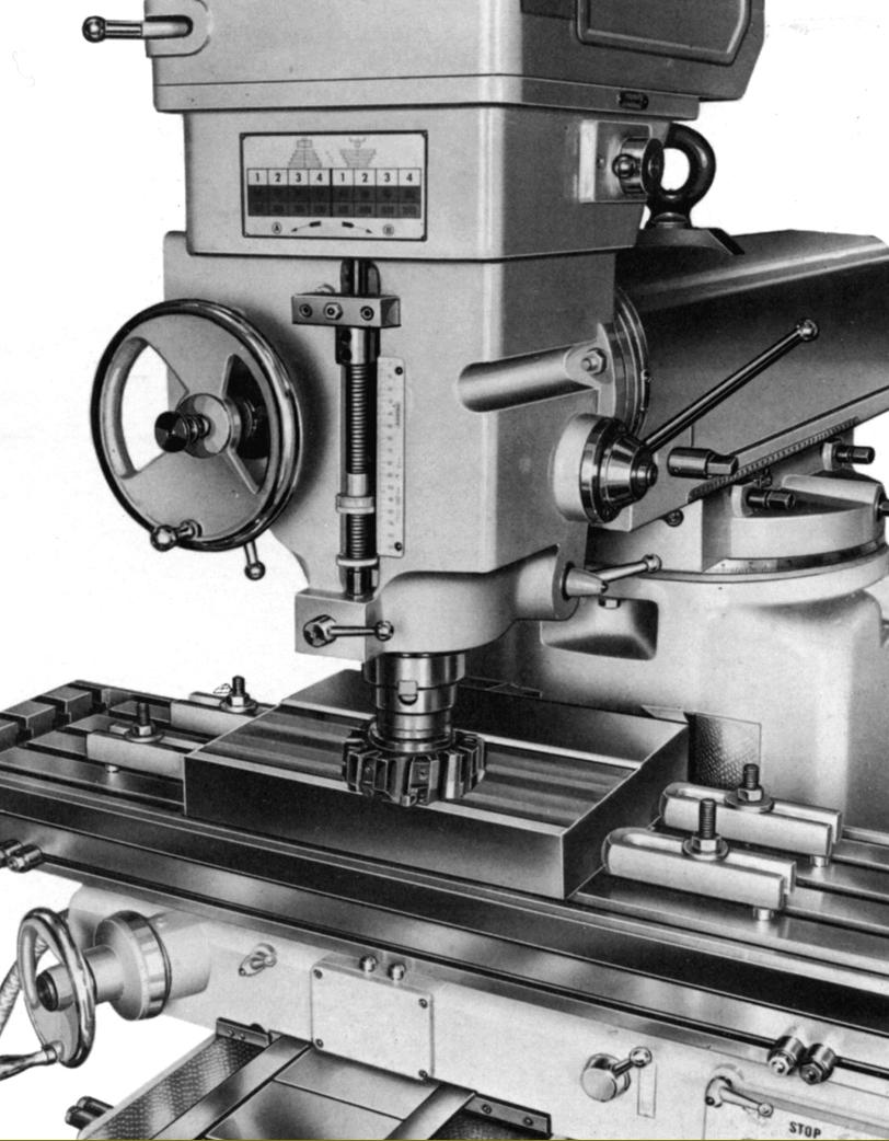

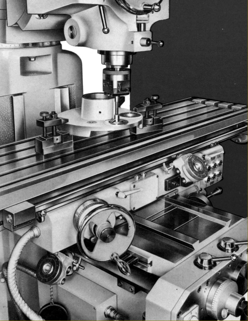

A 4-inch side and face cutter working on a mild steel block

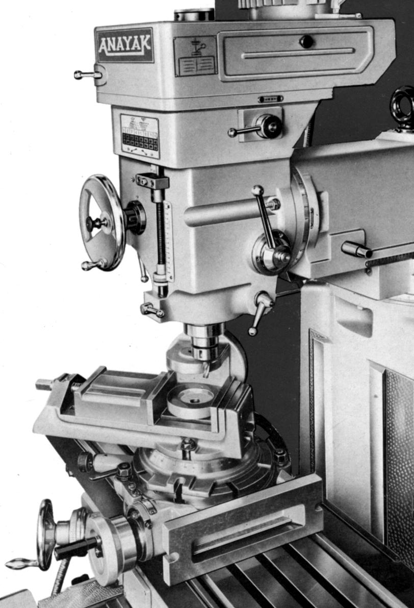

Maker's 12-inch (300 mm) rotary table, fitted with an all-steel machine vice, being to machine a hole in the end of a lathe changewheel bracket.
Dividing head set vertically holding a job being bored
