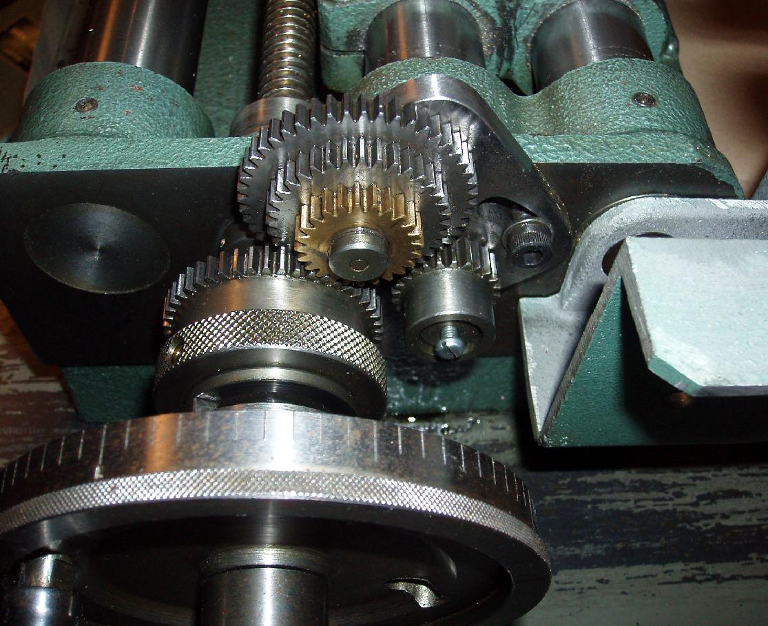

Carriage power-feed drive gears

The carriage-feed gearbox also contained a lever-operated dog clutch that, once the gear train was in motion, allowed the drive to be flicked into and out of mesh. Note the all-bronze construction of the clutch-operation mechanism
The end of the leadscrew was fitted with a usefully- large handwheel and micrometer dial. Note the use of bronze for the smallest gear
3-speed carriage-feed gearbox
