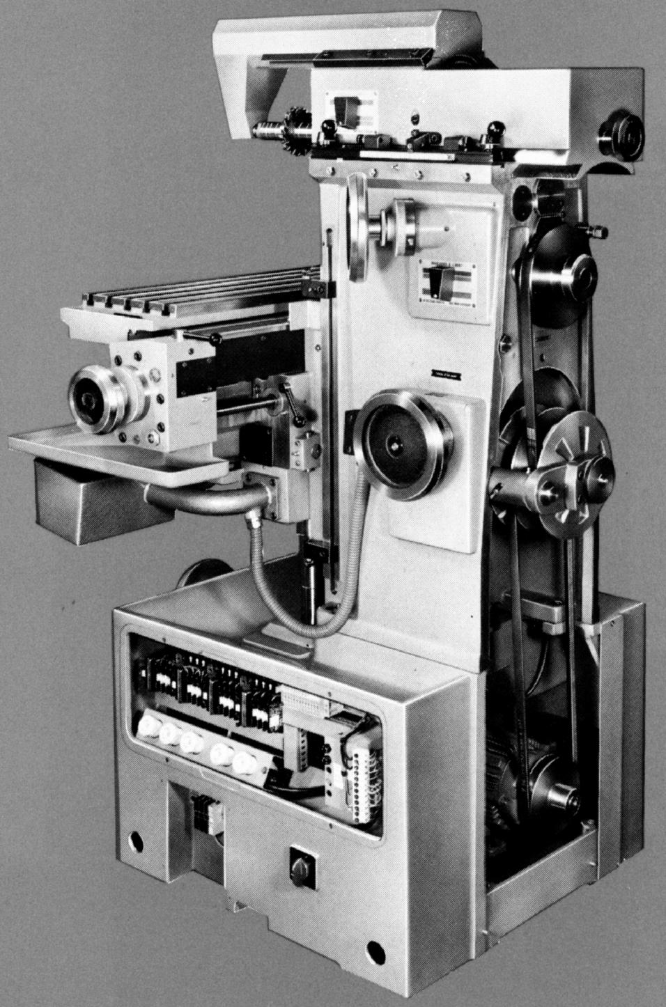

Standard vertical head,  driven by gear from the main horizontal spindle
For horizontal milling a conventional overarm and arbor were used - but even here Aciera ensured maximum rigidity by forming the arm and the (normally detachable) drop bracket from one casting.
Vital in exploiting the full versatility of the F4 was the 146 lbs (66 kg) Universal Table: with five DIN 650 12 mm wide T-slots running down its 23.5-inch (600 mm) length the 10-inch (250 mm) wide table could be pivoted left or right through 15° from central and tilted backwards or forwards through 30° from horizontal
Aciera F4 variable-speed drive system
F4 table-feed arrangement
F4 spindle-drive arrangement
