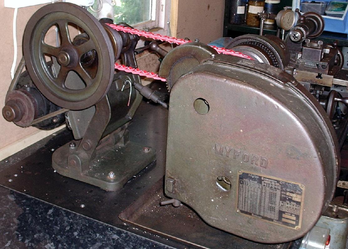

A set of photographs showing details of both the bench-mounted unoit and the the very heavy, rear-mounted countershafts fitted, with some modifications and differences, to Myford/Drummond M-Type lathes from 1942 until approximately 1951. Both flat and V-belts were used from the countershaft to headstock spindle (though the latter) are by far the most common) but all drives from motor to countershaft were by an A-section V-belt.
Both substantially built and neatly designed, the bench-mounted Myford M-type countershaft is a most effect assembly

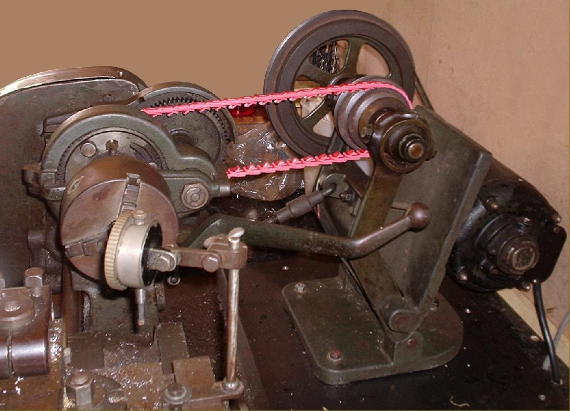

A substantial cast-iron over-centre tensioning arm, with a right and left-hand threaded adjuster to allow the belt tension to be precisely set. The bearings were plain but held within ingeniously-designed housings where the points of two opposing and adjustable screws pressed into countersinks on either side of each bearing and both held them and allowed a degree of elf-alignment. This type of countershaft assembly  was also used (from 1935) on the American Atlas 10-inch lathe (though with Hyatt roller bearings) and later on the Australian-built Hercus copy of the South Bend 9-inch.

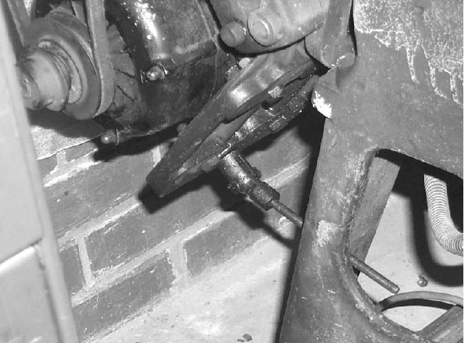

The motor plate was supported on an adjustable rod that allowed the motor-to-countershaft belt tension to be set. Some lathes had their motor mounted underneath the plate and the adjuster arm connected to a lug on the countershaft itself.

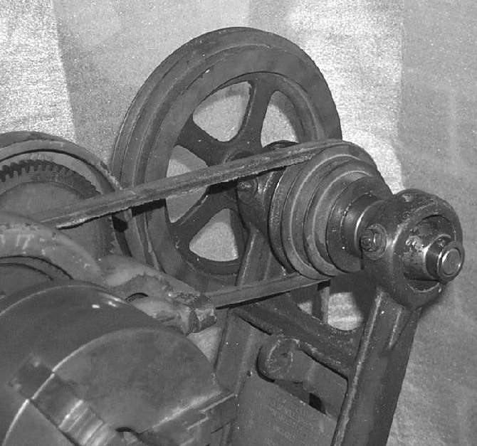

A view with the tensioning arm removed.

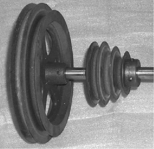

Both the two-step countershaft pulley and 3-step headstock-drive pulley were in cast iron the extra inertia of which helped to smooth out the drive from the commonly-fitted single-phase motor.

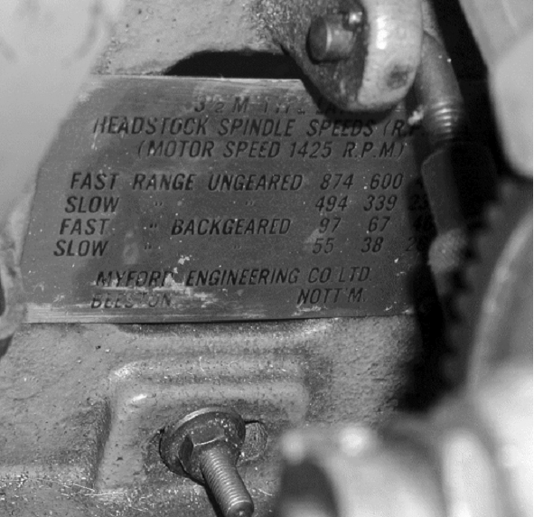

Spindle-speed chart riveted to the inside face of the countershaft.
Some lathes carried a second plate listing the speeds available with the alternative 950 rpm motor.
