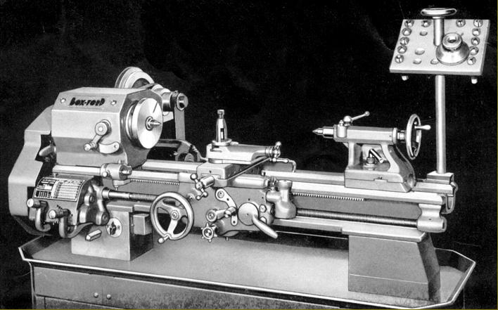

The first Boxford Model A: flat-belt drive, screwcutting gearbox, power cross feed
and quick-release countershaft as made from April 1948 to January 1951

Following the two early precision lathes, the company's next model, introduced in 1948 and again branded a "
Box-Ford", was an improved copy of the Pre-WW2 American South Bend  "9-inch Workshop" model, a type that dated back to the last months of 1933 and the Company's Model 5.  The earliest known publicity material concerning the new 9-inch model is a typed sheet found pinned to a pair of 1947 catalogues for the small precision lathes (it's reproduced at the bottom of the page). Details included are scant, just the main dimenions and specification and no hint of a Model Type or Series Nnumber. To date, the earliest catalogue found is a well-produced folder with a cream-coloured cover in card holding twelve sheets (secured with split pins) showing all three models, A, B and C, together with a range of accessories. Other catalogue covers can be seen here.

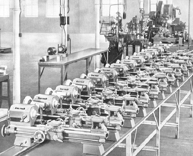

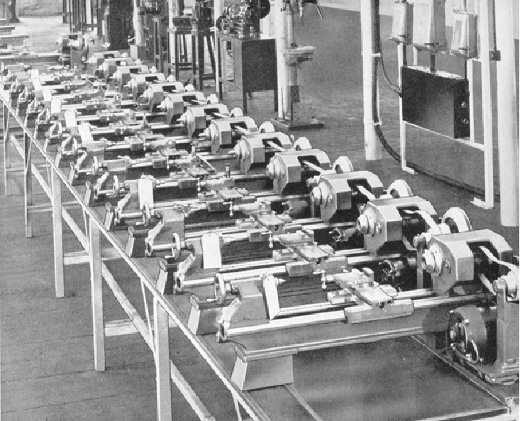

The first batch of 'Box Ford' lathes produced by Denford during 1948 at their Box-Trees Mill plant at Wheatley, near Halifax in Yorkshire, England. The lathes all had 3-step, flat-belt final drive and the compound slide rest was fitted with small diameter micrometer dials--exactly like those on the South Bend 9-inch from which the lathe was copied The countershaft was an integral unit of unusual and ingenious design where the pulley system and motor were both mounted on a platform that could be slide forwards and backwards on two bars fastened to the back of the headstock-end bed foot - the movement being activated by a quick-action thread controlled by a handle that fitted onto the hexagon end of a shaft that protruded through the bed foot at the headstock-end of the lathe..

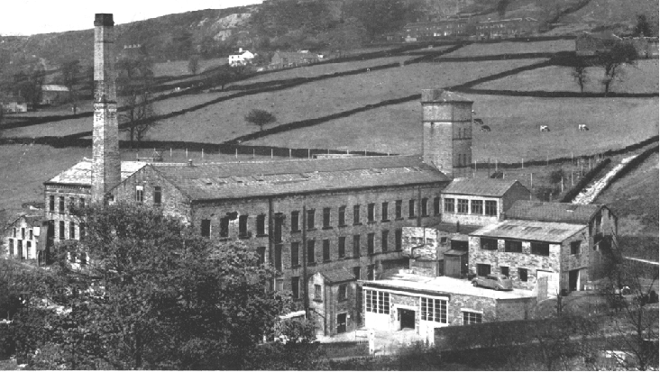

The original works - Box-Trees Mill, Wheatley, Halifax

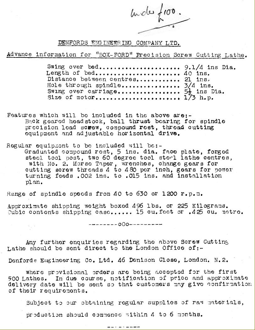

First known mention, in 1947, of the "Box-Ford" 9-inch South Bend copy.
Note the caveat about obtaining raw materials and the wording, designed to appeal to the critical export market. The country, exhausted from fighting and winning WW2, found itself short of almost every commodity and in urgent need of funds - the cry was: "Export or die".
