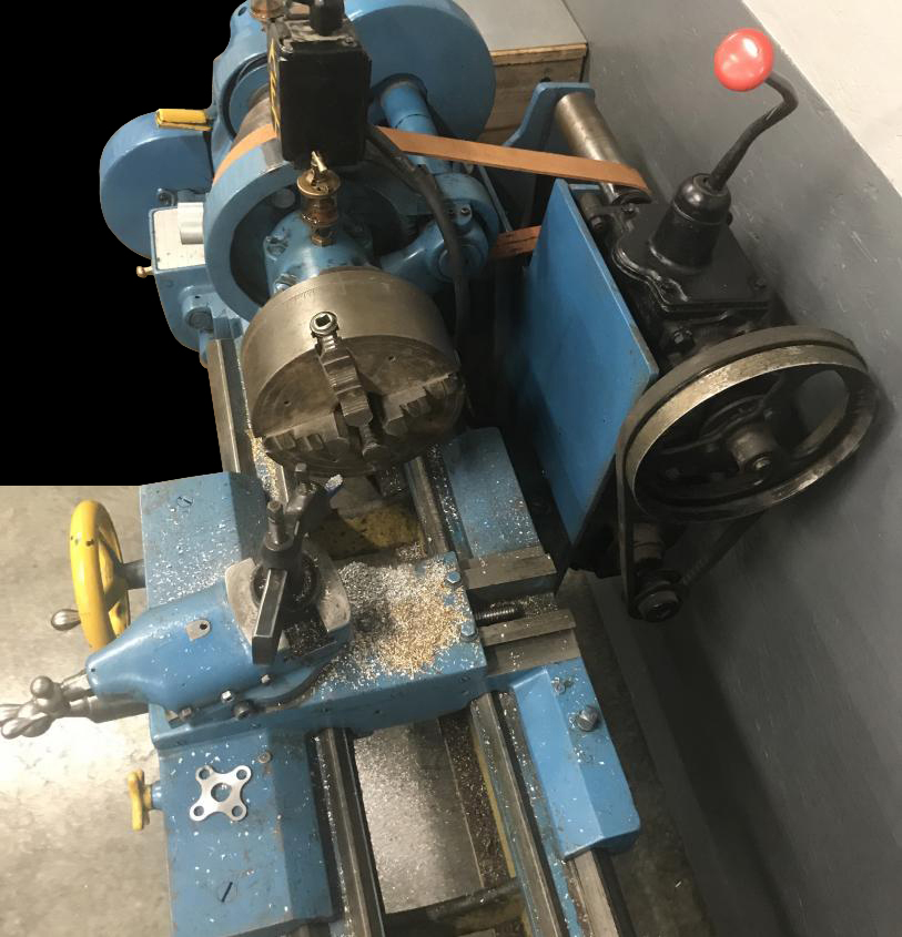

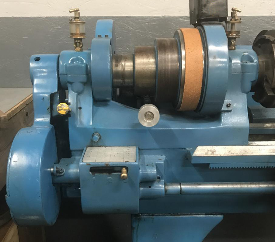

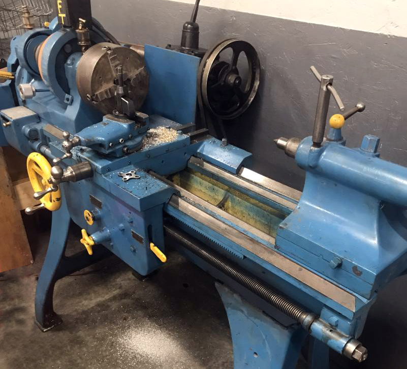

Founded by the former president of Whitcomb-Blaisdell Machine Tool Co. around 1910, the Worcester Lathe Company was based, along with many other machine-tool makers, in the state of Massachusetts . A range of regular engine-type machines was made, in both backgeared, flat-belt drive and geared-head versions, with production probably ceasing in the early 1920s.

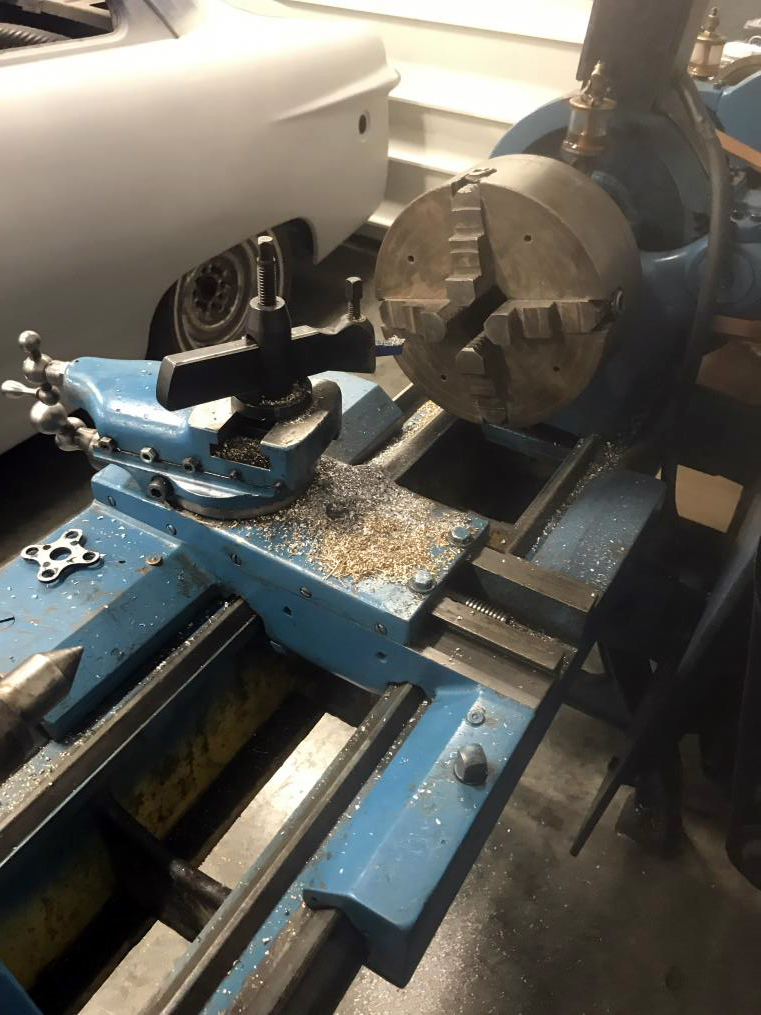

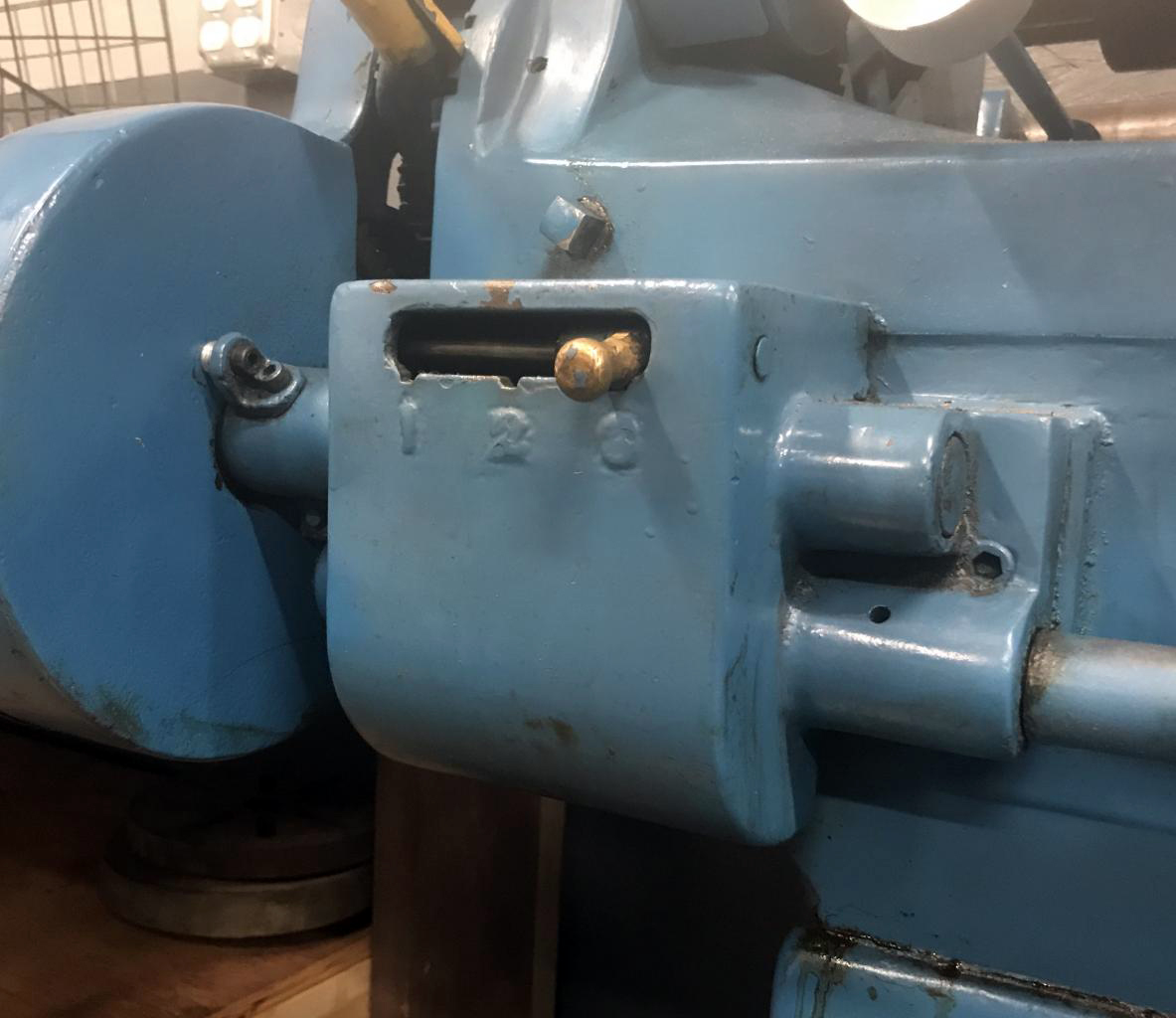

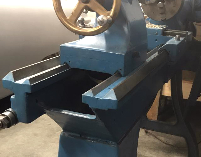

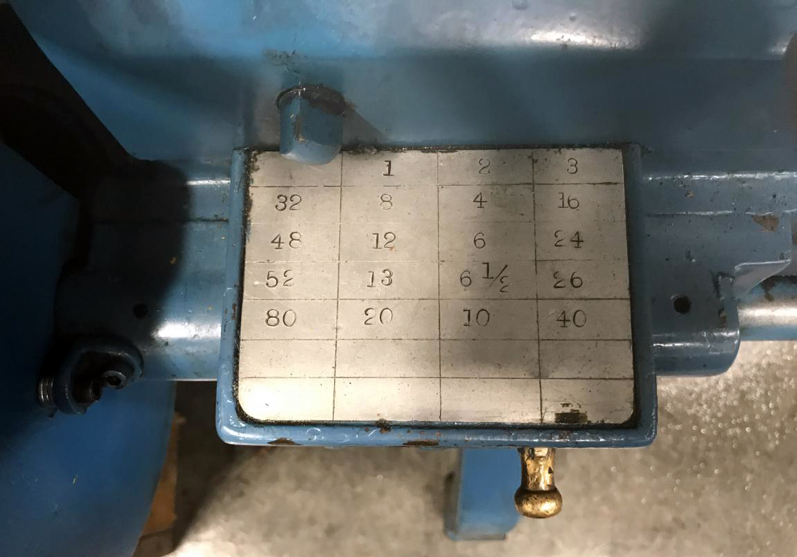

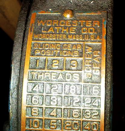

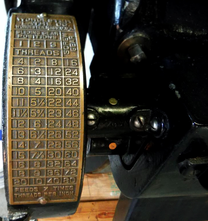

Rather oddly, some examples have been found with ways comprising a pair of Vs and flats (the example on this page) while others had four Vs (the example in blue, below) - in each case, of course, the carriage running on one pair and the tailstock the other. While early models appear to have had changewheels for screwcutting with an auxiliary flat-belt drive to the leadscrew, most examples discovered have a simple screwcutting gearbox that gave just three rates of feed for each setting of the changewheels - selection being by a lever sliding horizontally in a slot marked "1", "2" and "3". While a rather poor reproduction of an early catalogue shows the two 12 and 14-inch standard and toolroom lathes with the simple 3-speed box, a late advertisement, from 1921, includes a picture of a lathe fitted with a full quick-change box.

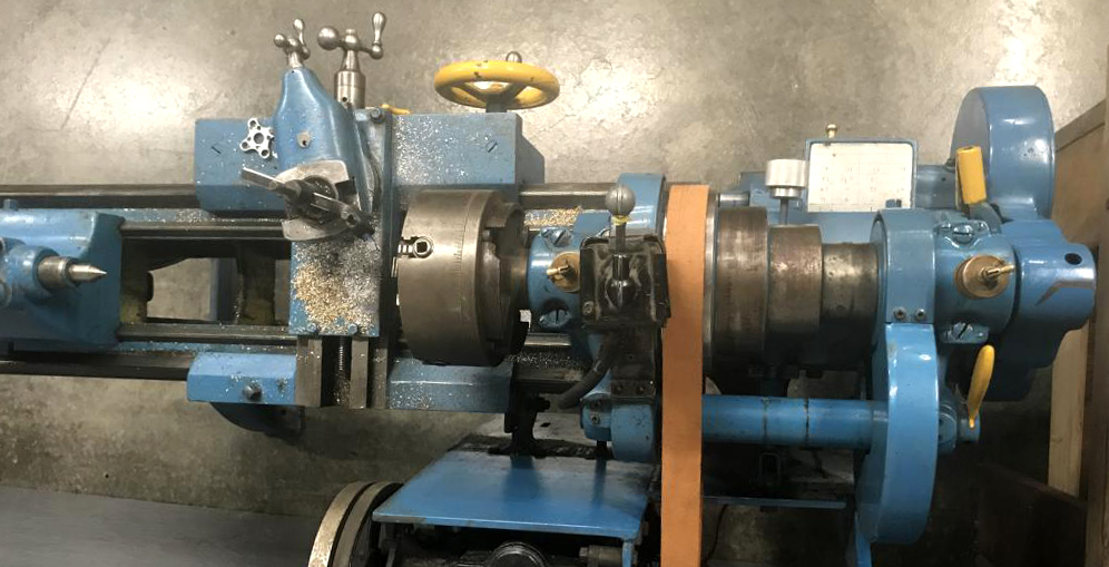

Although remote ceiling and wall-mounted countershafts would have been offered, at least one late-model could be had with a drive system consisting of a motor carried on a plate between the legs of the headstock-end support, its clutch operated by a full-length bar strung above a line between the headstock and tailstock.

Tony, I came across a lathe badged as made by "Worcester Machine Tool Co." I find that the headstock and tailstock castings, the spring clamp arrangement of the tumbler reversing lever, the lead-screw-plus-sliding-feed-shaft setup, and the presence of double inverted-vee ways to be continuations of the designs produced by the P. Blaisdell firm. Keith Rucker's Vintage Machinery archive has photos of such a Blaisdell lathe which clearly show the inner, tailstock ways and the outer, saddle ways just the same as those on the blue Worcester Lathe Co. machine on your site. The listing of the lathe described a 12" swing with 30" between centers and the apron is the same design shown in the P. Blaisdell 1893 general catalog from VM, though the older, hinged cross slide with elevation crank in back seems not to have survived long into the new century.

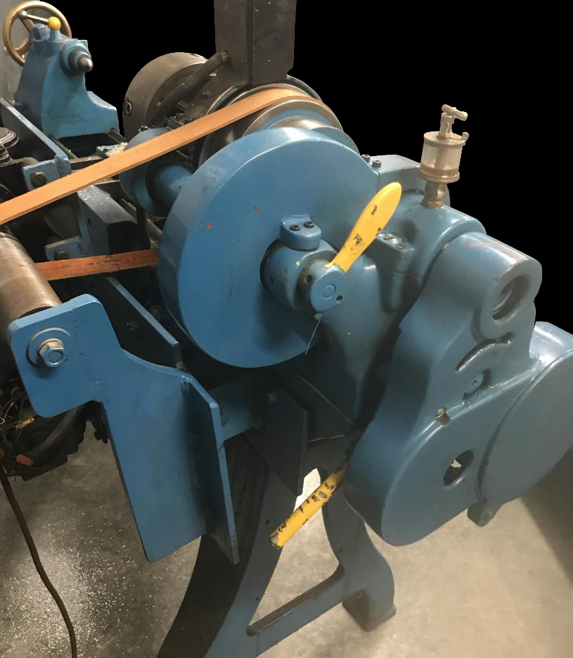

A common, effective and relatively easy addition to the drive system of any flat-belt drive lathe is the gearbox from a classic car. Depending upon the arrangement, if the four belt-driven speeds are combined with a 4-speed box and back gear and range of some 32 speeds becomes available. The lathe above has a single wide pulley that allows the belt to drive any of those on the spindle - the countershaft unit pivoting from the back of the headstock-end floor leg to adjust the belt tension. With a 4-speed box the set-up gives a range of eight easily-changed speeds

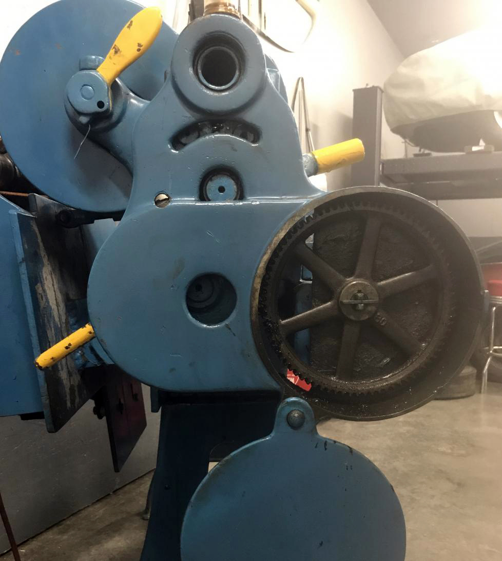

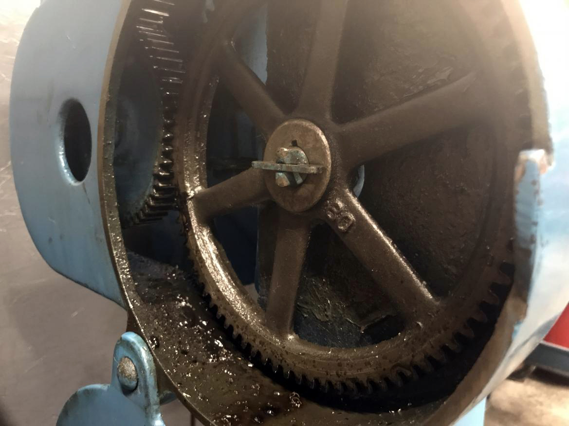

A quick-release key retained the large screwcutting changewheel

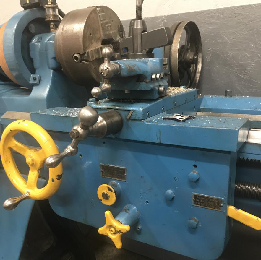

A simple gearbox gave three sliding and screwcutting feeds for every setting of the changewheels
