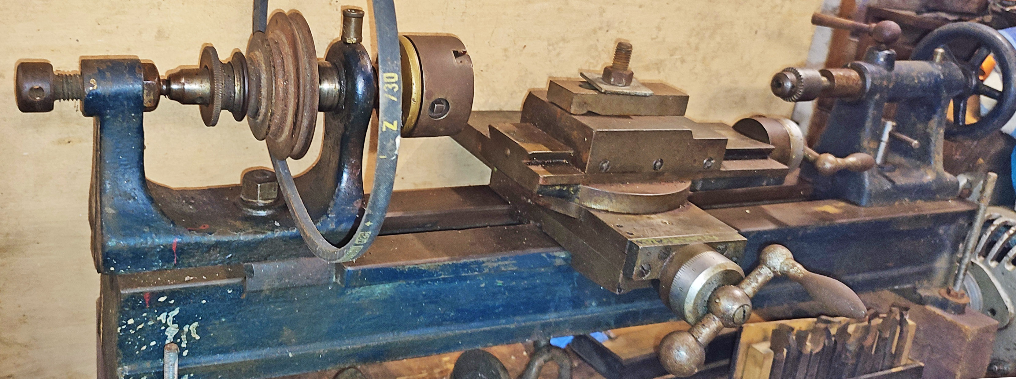

A D.E.Whiton lathe for bench mounting that has survived in original condition complete with a Whiton-made 3-jaw chuck and what must be the  maker's compound slide-rest assembly
This example of a D.E.Whiton lathe differs from that at the top of the page - its bed lacks the slender feet of the bench model and instead has pairs of small lugs at each end of the bed to bolt it down to a stand. This is confirmed by a section of bed cut away in line with the headstock pulley to allow a drive rope to pass up from a treadle-driven flywheel.
The slide rest on this Whiton is from a later model of a precision plain lathe Visible in the picture - below the bed - are the clamps used to hold down the headstock, slide rest and tailstock.
