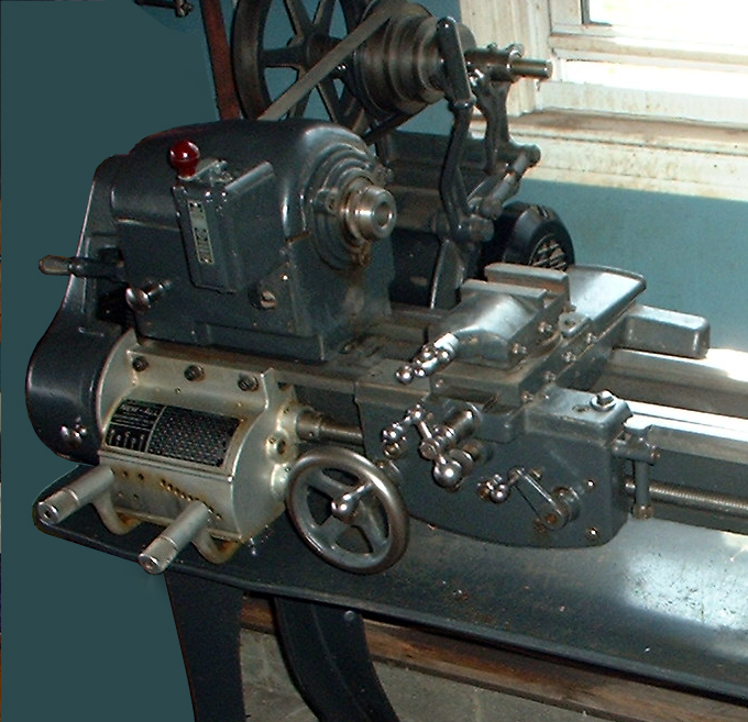

Western Aircraft Tool Co.  gearbox fitted to a Logan lathe
