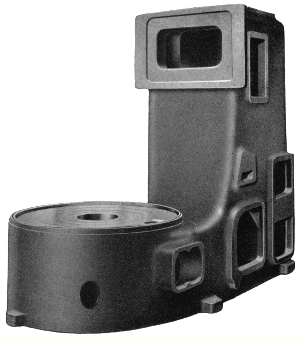

Massive one-piece main casting of the standard machine

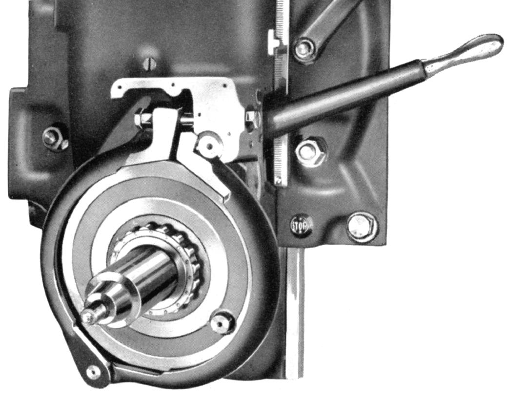

Turret clamping mechanism - this used a V-shaped contracting ring in steel, cam-operated by the handle that also moved the hardened and ground turret locating plunger - the small boss at the 4 o'clock position relative to the central mounting stem

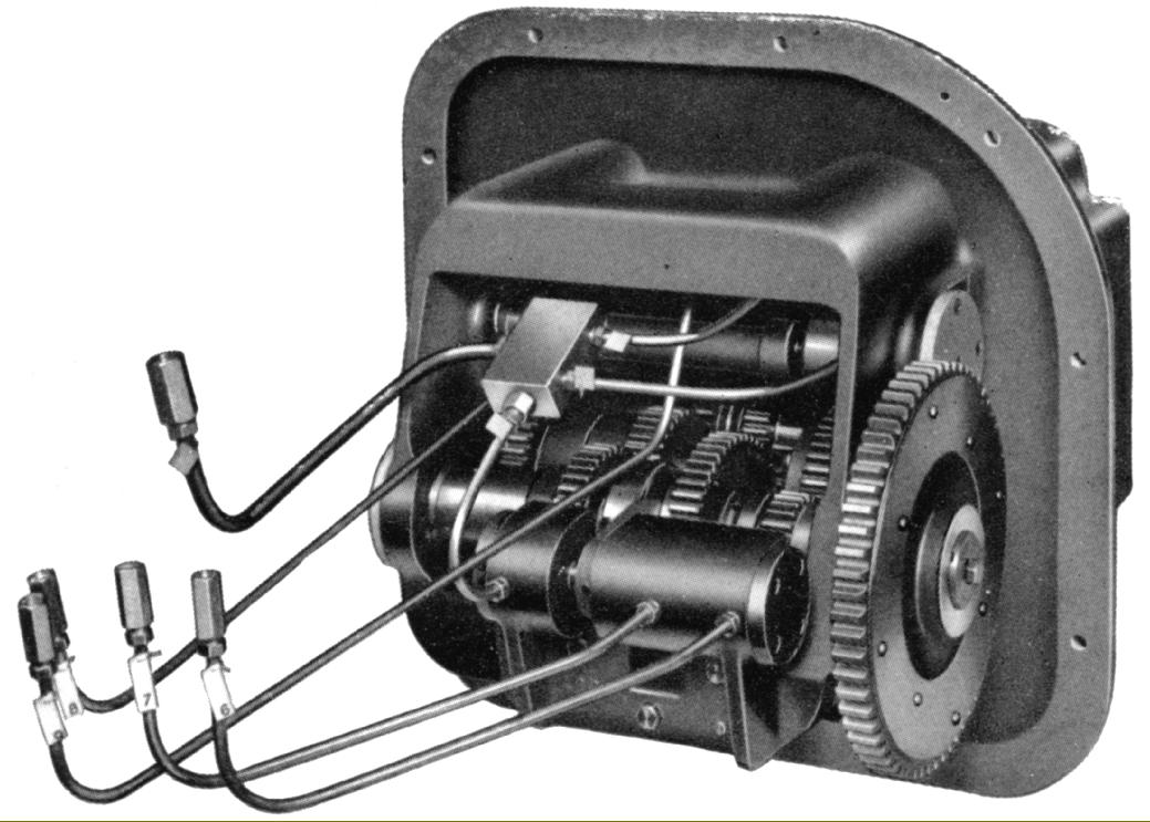

Feed gearbox: like the speed-change gearbox this was formed as a complete unit with shafts that ran in ball and roller bearings and gears made from heat-treated, nickel-chrome steel with their tooth profiles - and the shaft splines - being ground finished. The twelve feeds - hydraulically selected by sliding dog clutches of alloy steel in combination with a free wheel - were selected by a rotating dial and operated in vertical, horizontal and angular directions. Engagement of the reversible feeds was by a hardened, positive clutch with a shear pin fitted to prevent damage from overloading.

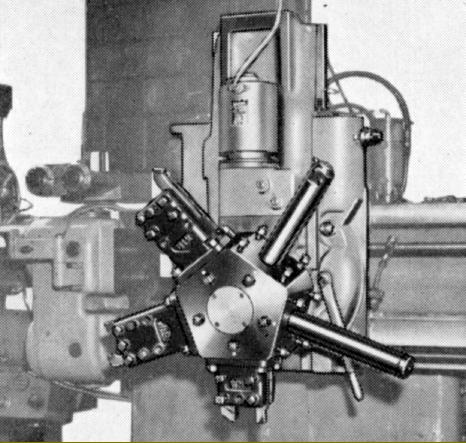

Power-operated turret - handy on the taller machines

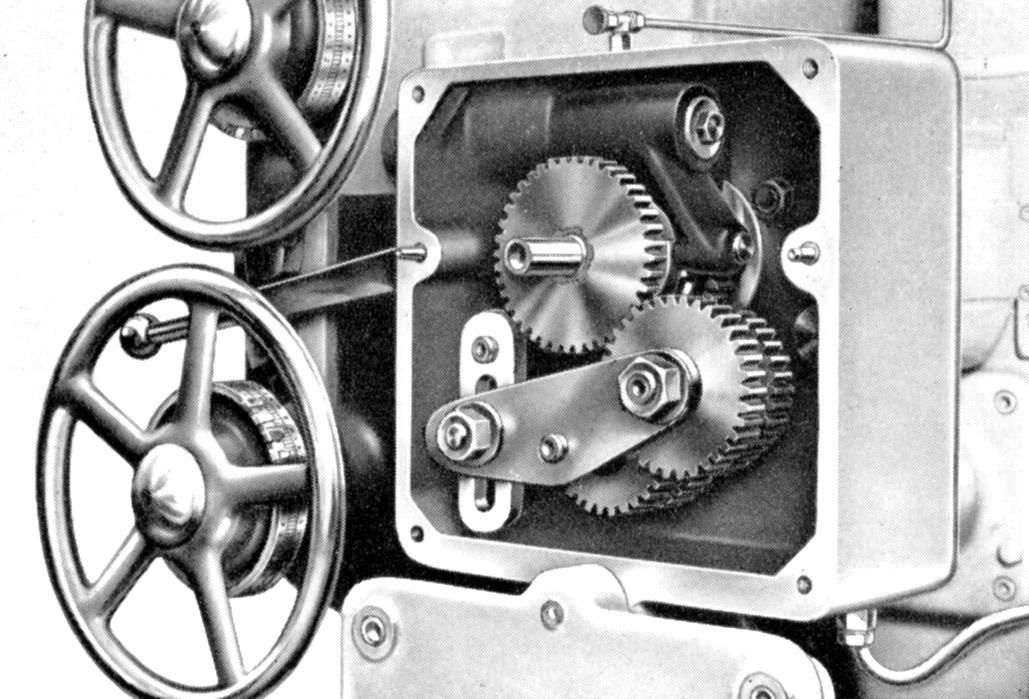

Taper generating attachment. This unit was necessary if the required taper could not generated by swivelling the turret slide. The accessory worked by connecting together the horizontal and vertical feed shafts by a set of changewheels, the range being generated spanning 1° to 40° measured from either the horizontal or vertical plane - an idler gear being supplied to give reversal of the set taper. If tapers outside the standard range were required, the makers could make special arrangements for them to be generated

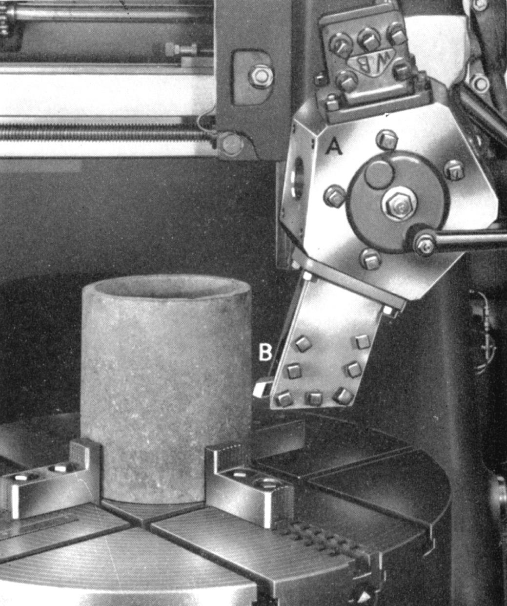

An "Intermediate position Toolholder" - designed to assist with tall workpieces by giving clearance from the face of the turret (A) with minimum tool overhang (B)
