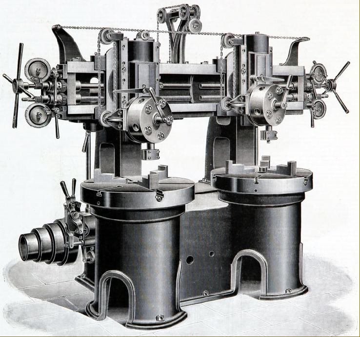

A Duplex machine from 1901
A heavier duplex model from 1902
Rear of the 1902 duplex model
1904 duplex 30-inch
