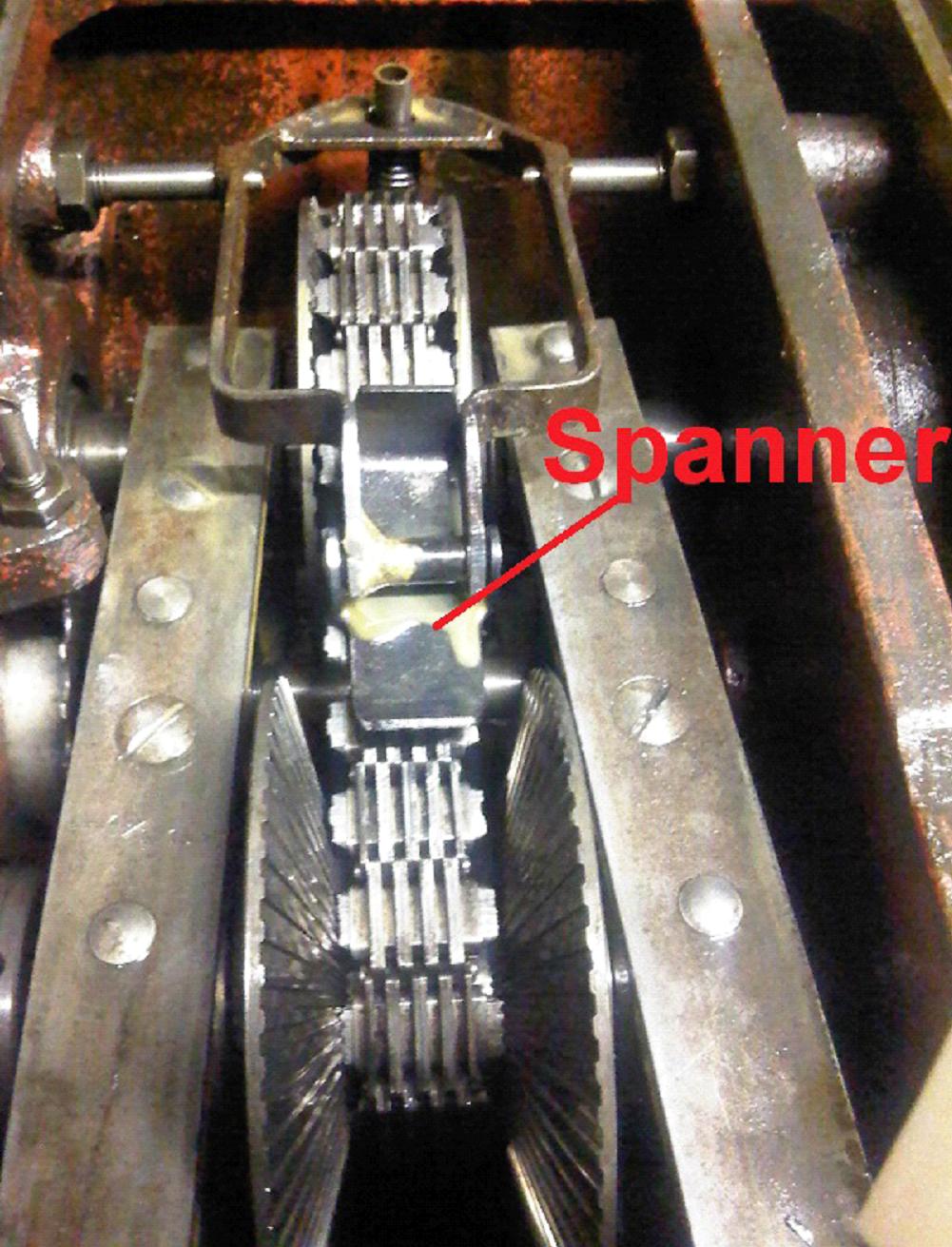

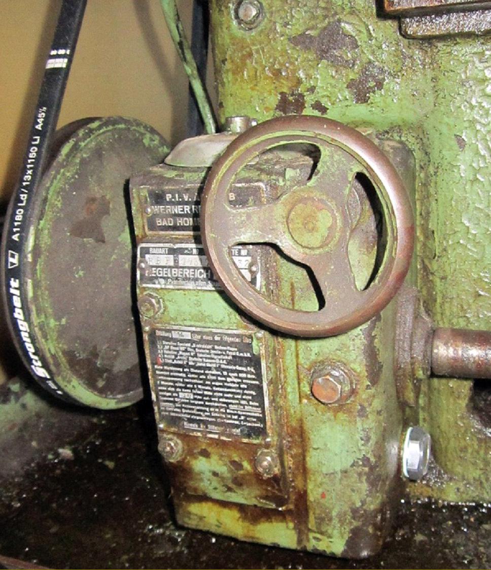

Shown below is a typical product of the company, a short-bed, very heavily built lathe of the "production type" - that is, without a leadscrew for screwcutting but fitted instead with a feed shaft to drive the carriage. In order to enhance the lathe's intended function it incorporated an unusual feature, the use of two P.I.V. Antrieb Werner Reimers
mechanical variable-speed drives - one for the main spindle drive and another (much smaller) to power the carriage-drive shaft. Hence, it was possible to not only vary the spindle speed by turning a car-steering-wheel-like-control on the face of the headstock but also, simultaneously and at a different rate, change the rate of carriage travel by turning a smaller wheel of the face of the feed gearbox. Like the similar (but differently-driven) mechanism on the Hardinge HLV and HLV-H toolroom lathes, this arrangement allowed a job to be machined at the optimum rate for its diameter, material and surface finish required by the simple, time-saving manipulation of just two controls.

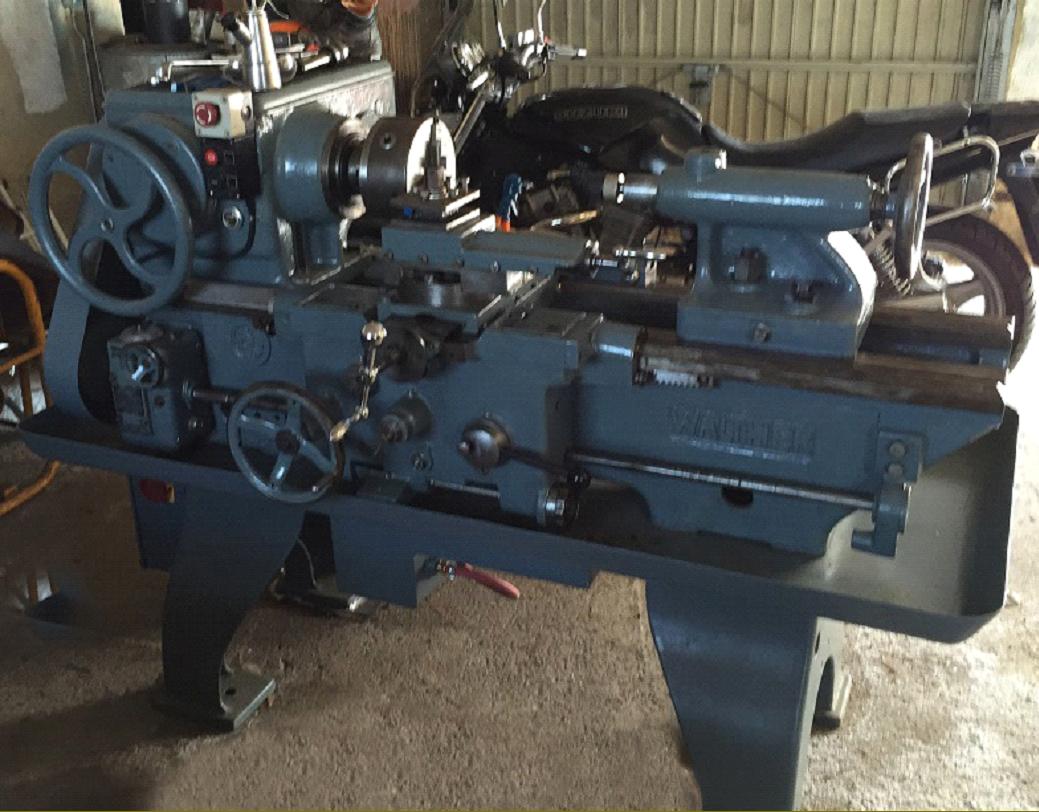

The owner writes:

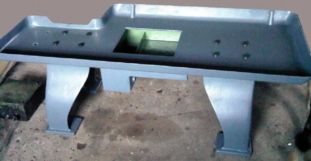

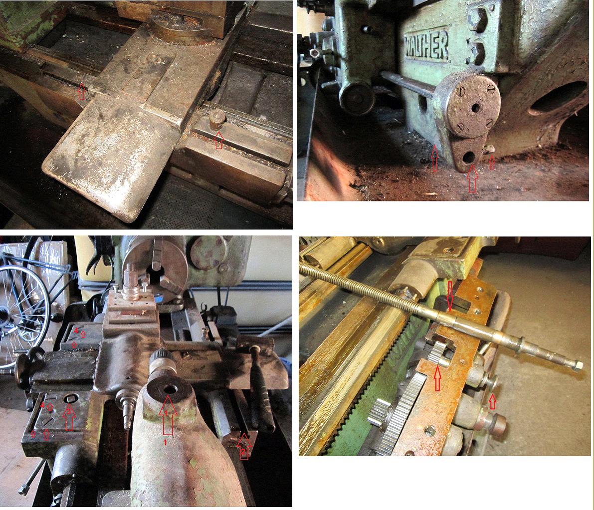

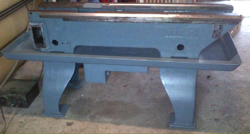

I bought my Walther from an Ebay auction and, when I first saw it, realised that it was in very poor condition: most of the paint was missing, oil was leaking from the two gearbox, the belt transmission from motor to spindle was deranged and the automatic feeds didn't work - this was a machine that had been run into the ground by the previous owner who had used it only to re-machine car brake drums.
Once removed to my workshop I realised that the use of two PIV drives was something rather special and I thought that perhaps the makers might have had some relationionship to the old-established German gunsmiths of the same name. As so little information was available it dawned on me that this could be an example of a "last Mohican" - and decided (despite its terrible state) to refurbish it.
One interesting problem that turned up during the rebuild was a missing lock nut on the friction coupling used to drive the carriage; this used a M32 x 1.5 mm pitch left-hand thread - a size impossible to find today and one that needed to be specially (and expensively) machined. For the paint I decided on a very tough, long-lasting 2-component Epoxy.

Inside the headstock showing the P.I.V. variable speed drive mechanism
Variable-speed feed gearbox
