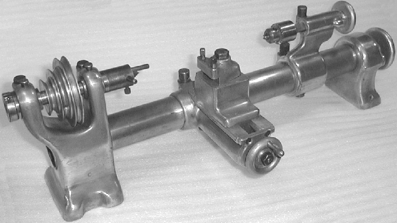

The "No. 1" Plain-turning version of the Wade CAV lathe.
The small diameter of the headstock spindle meant that there was no room to machine a taper in its nose to accept a centre, instead, a screw-on boss was used (a device frequently used on light, amateur lathes of the 1800s) which had sufficient diameter to carry a short No. 1 Morse taper centre and, at the same time, act as a simple form of drive plate for between-centres work.
