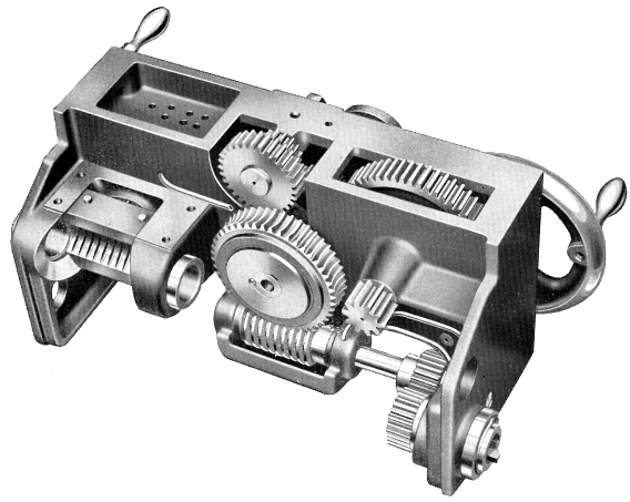

Apron as used on the N-16, L-18, N-18 and L-20 lathes. Larger lathes had the modified and strengthened unit shown below.
Strengthened apron with power-feed reverse as used on the N-20 and larger lathes
