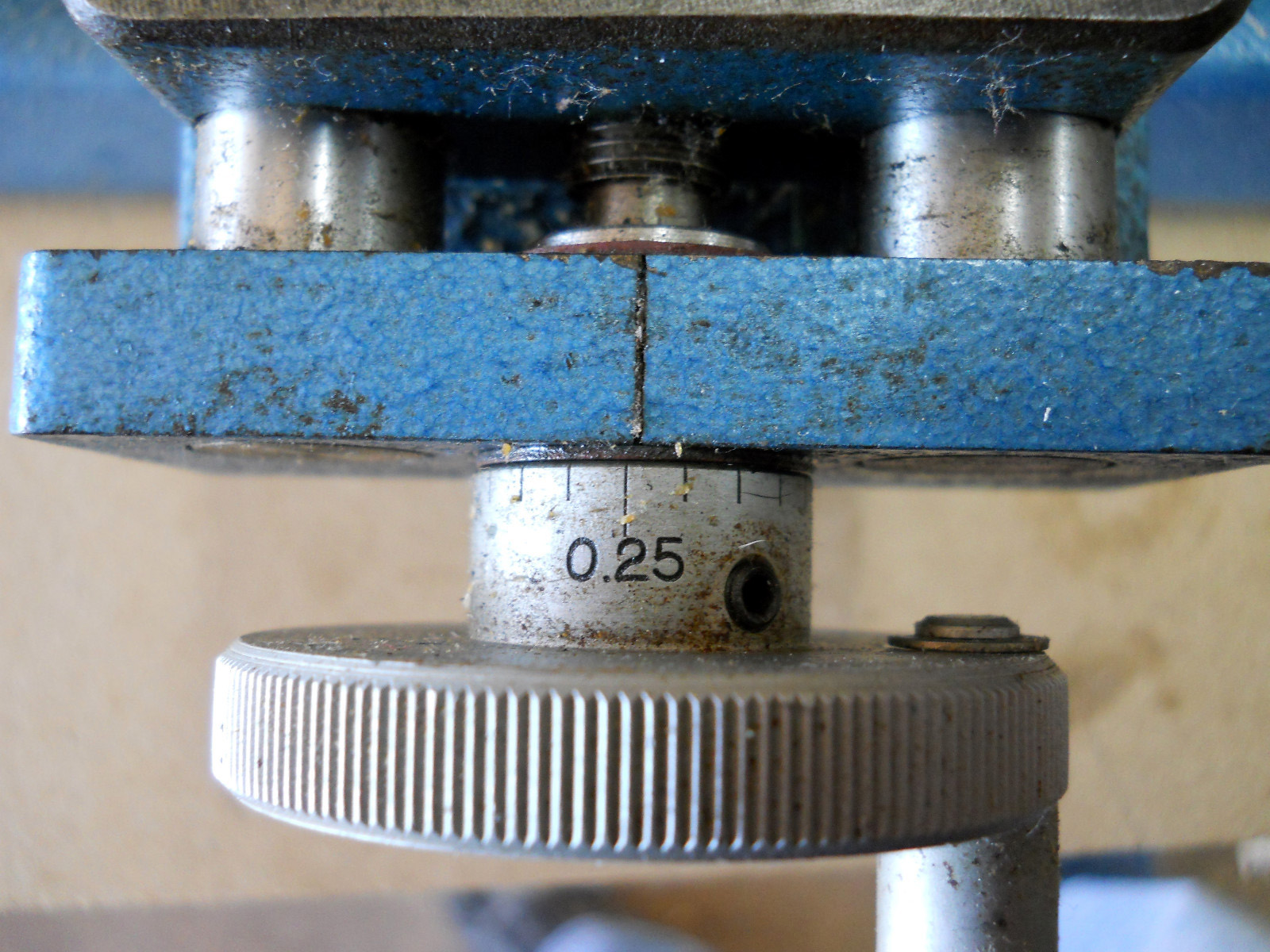

Looking to have been constructed along the lines of the Unimat DB200/SL1000, the Vigor Super Mini-Lathe Model LA-1100 was made in Japan (further confusion) and handled in the United States by B. Jadow & Sons of New York. Of simple arrangement, both its bed and slide rest assembly were constructed from twin steel bars - in the photograph below the bed ways are covered by a sheet of black steel. The carriage, driven by a hand-turned leadscrew running down the centre line of the bed, carried a cross-feed screw covered by a protective tube - though that for the swivelling top slide was left completely exposed and so at the mercy of swarf and dirt. Both feed screws, as well as the leadscrew, were fitted with small but clearly engraved micrometer dials.

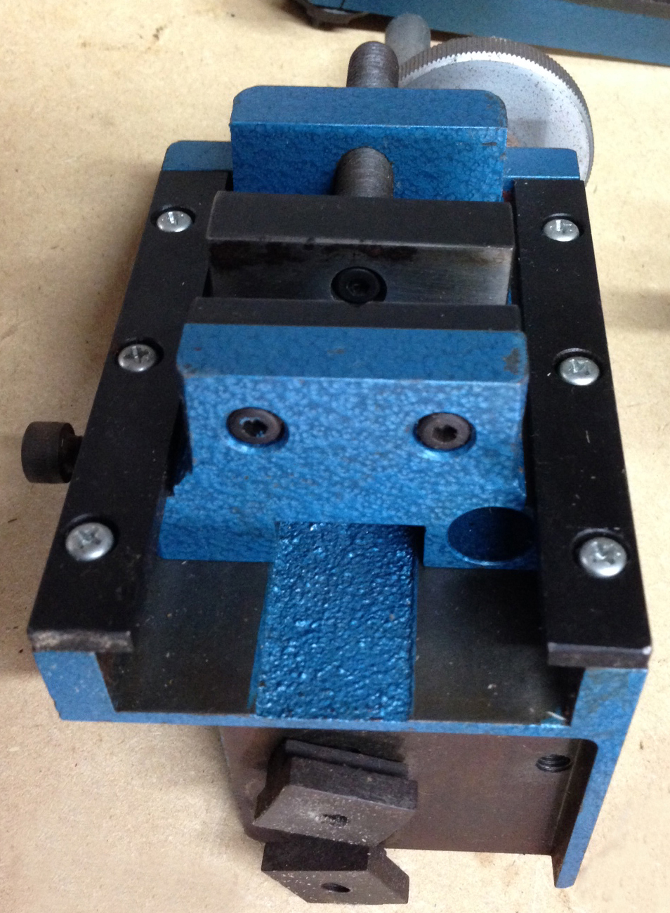

A vertical milling slide with an integral vice was also included with this, like the top slide, being constructed in a simple, built-up fashion with screw-on caps replacing the usual fully-machined, V-edged ways. Also in the kit of standard parts was a neat, height-adjustable toolholder (of a design that would scale up to be useful on a larger machine) and possibly a tailstock chuck.
