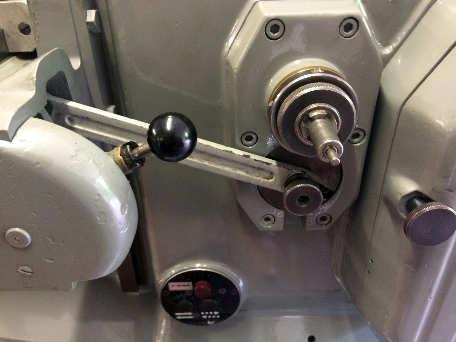

A useful eight rates of ram stroke were available, these being obtained by a set of pick-off gears - arranged in fixed pairs on fixed centres - and stored neatly on hooks on the inside face of a door in the cabinet's right-hand face; the gears gave rates of 32, 40, 50, 70, 85, 120, 145 and 180 strokes per minute. One option - not shown on the machine below - was a simple cam-and-rod operated tool lift  on the return stroke. Horizontal power feeds (in both directions) were fitted to the table as standard, the five rates varying from 0.1 to 0.5 mm per ram stroke with, at extra cost, an electrical cut-out when the table reached it travel limit. A pleasing refinement on the Vernier was that, instead of the expected exposed ratchet drive to the table, an enclosed one was used with a ball-ended control lever. Hand drive of the table was by a detachable, 4-dog crank handle, this also being used to both set the ram stroke and move it by hand - in every case the mounting shaft used was fitted with a spring-loaded "safety pin" that ejected the handle and so prevented it being left in place when the shaper was under power.

Protruding from the end of the table's hand-cranked mounting shaft can be see the spring-loaded "safety pin" that ejected the handle and so prevented it being left in place when the shaper was under power.
