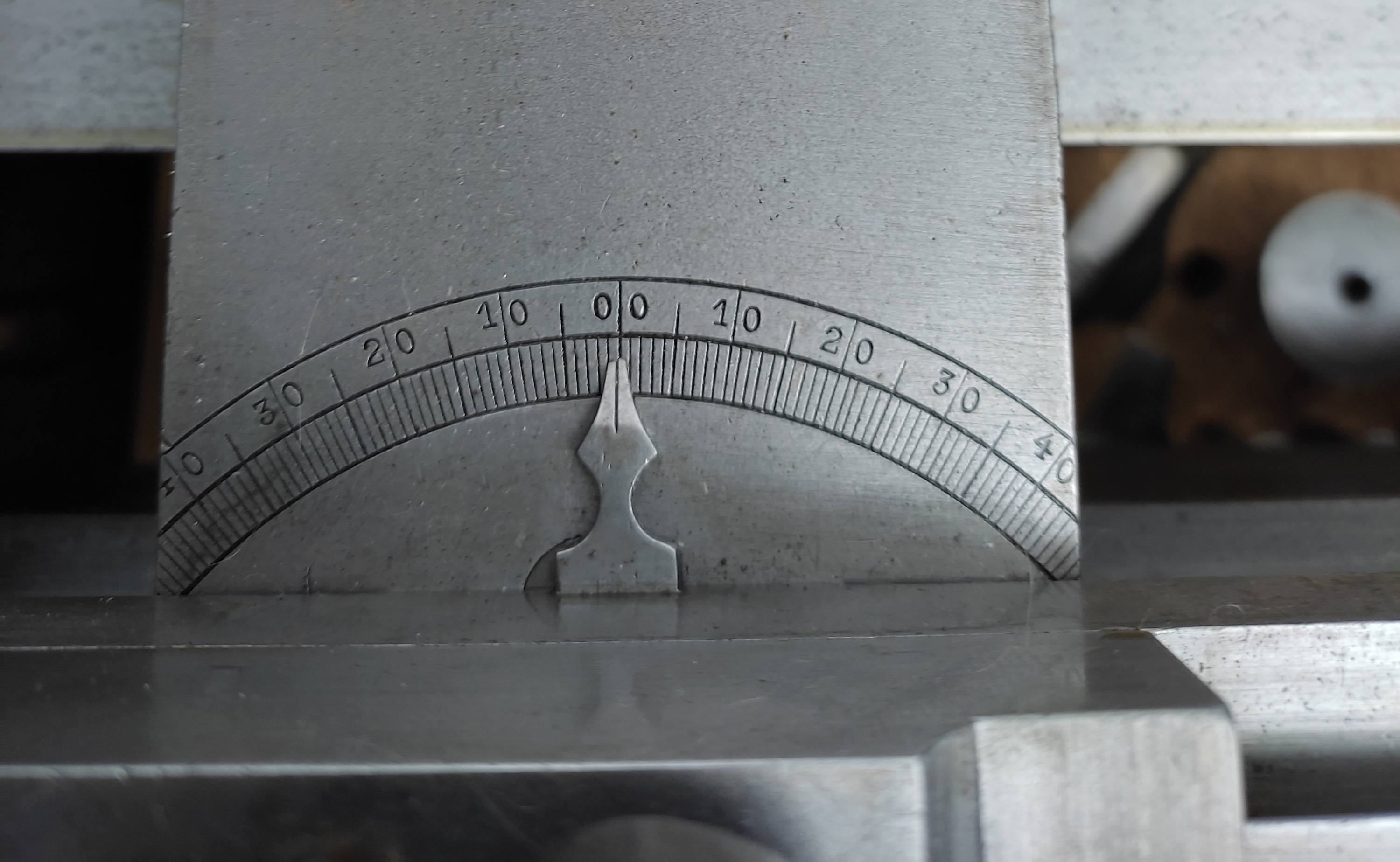

The lathe belonged to Léon Fournier at Grand Mont des Gras 25790, a manufacturer of precision equipment including hand chucks and special ''morel pliers'' intended for watchmaking. The lathe has remained in the same family and now, happily, is owned by the grandson.
Dating from the early years of the twentieth century, the lathe has screw pitches of English Whitworth form, those moving the slide rest being right-handed and so, when turning the feed handle to the right, moved the slide towards instead of away from the operator. In England this is called a ''cack-handed'' system (one long abandoned) - and, if all the lathes in a workshop were so fitted, it was not a problem. Of course, if conventionally equipped lathes were in the mix, the chance of spoiled jobs was very high indeed..
Unfortunately, it is not clear if the Vernot Brothers were the makers of the lathe but, even so, this is a beautifully-made machine, with a centre height of around 125 mm and admitting perhaps 500 mm between centres.
In many ways it closely resembles early Lorch lathes of the Type A that were current from circa 1885 to 1920. The bed has the same V and flat ways and the compound screw-feed slide rest is almost identical to that on the Model A1 No.4 - even to the long levelling screw on the toolpost clamp. The ball-ended wing-nuts that clamp parts to the bed are the same, as is the spindle collet drawbar handle.
One clear difference can be seen in the end faces of the bed. On the Lorch the faces are formed with a clear 90° step at the bottom to form a flat surface - and with the bed feet bolted to the full length of the step. On the Venot the end faces of the bed appear to have been rather crudely formed with a radius and have a very short flat step  - and both bed feet sit level with the upper section of the bed's end faces and have thinner bases.
In conclusion, the lathe appears to be a close copy of a Lorch Type A and most unlikely to have been manufactured by Lorch themselves. Copies of Lorch lathes are relatively common and include Satif, BTM, Stedall, Kharkovski (Russian), Rolls Royce, Lanco and George Adams
