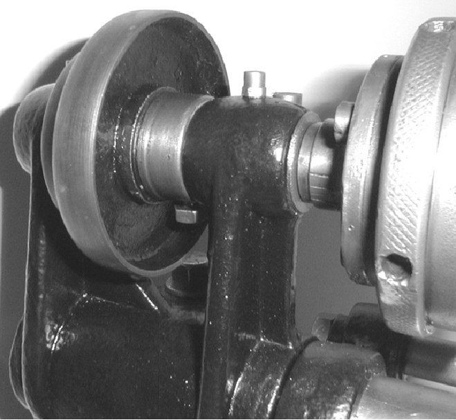

Just over 30-inches long, and standing 15.5-inches high, it was based on a solid bar bed with early versions having a light-duty "gut-rope" 3-speed drive but later models, although restricted to two speeds, being able to handle more power through flat-belt pulleys. The base section of the headstock (like that on the Round Bed Drummond), was bored through to accept the bed; it carried a 0.5-inch bore spindle, screwed 7/8" Whitworth, running in plain parallel bearings closed down by screws positioned at the rear. Other than arranging the headstock pulley flanges to bear against the inside of one or other of the headstock bearings, there was no way of adjusting for spindle end thrust.

Simple but adequate headstock with spit plain bearings clamped by rear-set screws

Spindle thrust was taken care of by positioning the headstock pulley flanges against the inside face of one, or other, of the headstock bearings.
