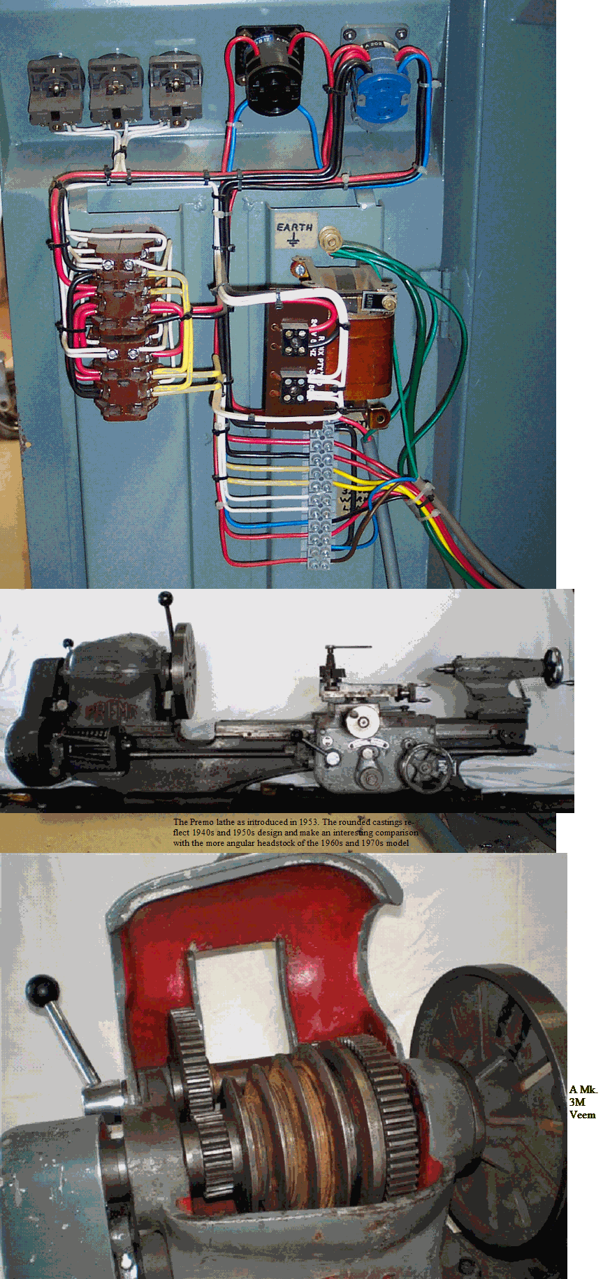

Continued: Heavily built and (apart from the arrangement of its patented drive system) an entirely conventional backgeared and screwcutting lathe the last version Weem/Premo had a permanent (but rather slim) 360 mm-swing gap in its 180 mm wide, ground-finished, close-grained, mehanite-iron V-way bed. As was normal practice, the carriage and tailstock both ran on their own pair of V and flat ways. Although not mentioned by the makers in their sales literature, the back of the bed was machined flat and tapped to allow the mounting of a "Maximat" self-powered (swivelling-head) vertical milling attachment as used on a wide range of Emco lathes and stand-alone millers. Formed as a heavy, box-section casting the headstock was fitted with a flat, hinge-up lid that doubled as a useful tool tray - the opening allowing not only maintenance of the belt and gears but access to the oil nipple used to lubricate the spindle when the lathe was running in backgear. The engagement of backgear was by a single lever on the front face of the headstock which, when moved, had the effect of simultaneously disengaging the bull gear from the drive pulley and causing the other gears to come into mesh. As on some Colchester lathes, the headstock could, be adjusted on the bed and one owner reports being able to achieve a setting that produced an accuracy of better than 0.0001" 6 inches away from the nose of a 3-jaw chuck. Made from nickel steel, and running in generously large class 3 (close tolerance) Timken taper roller bearings, the 1.0156" (25.8mm) bore, No. 4 Morse taper headstock spindle was (users report) able to absorb very heavy cuts without chatter. The spindle was driven by a long-life, oil resistant toothed belt from an internal layshaft mounted across the rear of the headstock; the layshaft carried a 4-step V-belt pulley on its outer end driven by a 1.5 hp motor that was mounted on a platform hinged on the back of the headstock. 8 speeds were available, from 38 to 1300 rpm, and to change them the combined belt and gear-guard cast-aluminium cover had to be swung open and the drive belt from motor to headstock layshaft released by a combined mechanism that used a long "over-centre" action lever to slacken and apply the tension - together with an adjustable toggle (with a left-hand thread at one end a right-hand at the other) to adjust it. A useful practical touch was the inclusion of a wall across the inside of the changewheel cover that prevented lubricant from the gears being thrown onto the drive belt. A 1.5 hp 3-phase 450 volt motor was fitted as standard but the makers offered the option of single-phase electrics with a 240 volt, 1.5 hp motor with that best-of-all-options - "capacitor start and run" to give both enhanced starting and running torque. The electrical control gear was neatly mounted on the headstock-end front panel of the braced, sheet-steel stand - the switches being easily reached by the operator from his normal working position; because many of these lathes were supplied to schools and technical training establishments, the electrics were safely isolated by a key-operated switch. A 32-volt transformer was supplied to power the low-volt lighting and motor controls. Unfortunately, the wiring was left exposed on the inside face and, to stop users from employing the space inside as tool storage, the (hinged) panel was locked closed with three screws. The right-hand side of the cabinet was provided with a full-height hinged door with two shelves sufficient to hold the lathe's standard equipment together with a number of accessories. The rear of the centre section was arranged to accommodate an (optional) coolant pump and tank that, if fitted, was fed by a welded-in drain tube positioned directly above it. The rear of the saddle was supplied ready tapped to hold both the (extra-cost) taper turning attachment and the coolant distributor tube support bracket. Continued below:

The top of the headstock, which was flat and formed with a lip so that it could be used as a convenient tool tray, was hinged at the rear to allow access to the connection that released the bull wheel from the spindle so that backgear could be engaged. A shear pin was fitted through the leadscrew under the O ring on the joining section. The screwcutting gearbox had just nine positions for the single tumble lever - and no sliding or reversible gear on the input shaft by which means many other makers had contrived to offer a choice of both fine and screwcutting feeds.

The electrical switchgear was neatly mounted on the headstock-end cabinet door from where the switches could be easily reached by the operator from his normal working position; unfortunately, the wiring was left exposed on the inside of the door and so the cabinet could not (at least safely) be used to store loose tools.
