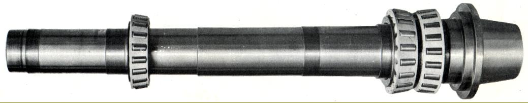

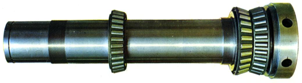

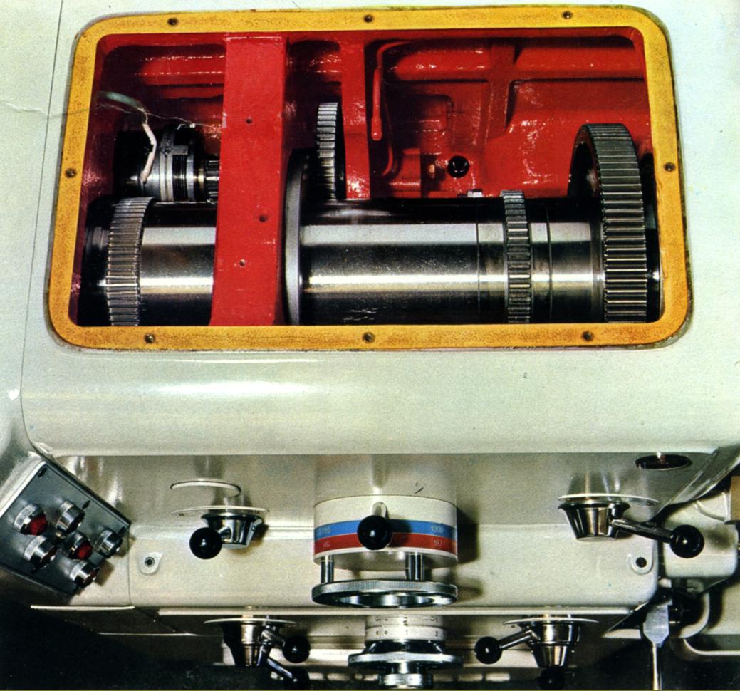

All headstock components, including the ball-bearing supported auxiliary gear shafts and gears, were made from case hardened and ground nickel-chrome steel with the spindle, running in ultra high-precision roller bearings made by Gamet in England, turned from a forging then hardened, stabilised and given a ground mirror finish. A choice of spindle end fittings was offered for the Ursus 52, the standard being a rather old-fashioned American Long-nose taper in an L1 size and the other an American Cam-Lock D1-6" and an American ASA A-6". On the Ursus 105, with its huge spindle bore, just one type of nose was supplied, a D1-8" Cam-Lock. Lubrication was by a pressure pump, the supply also being directed into the screwcutting and feeds' gearbox.

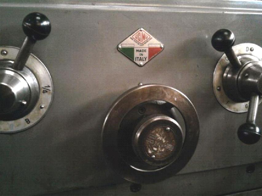

very deep studies, all versions of both lathes were able to generate a range of English, Metric, Module and Diametral pitches without having to dismount of substitute any of the changewheels. Sealed, with changes made by dials and levers and not an open sliding tumbler, the box was proof against the ingress of dirt and swarf and used a separate set of gears for screwcutting and feeds - the latter by the usual slotted rod passing through a worm gear in the apron. Pitches available were Metric from 0.5 to 7 mm, English from 4 to 56 t.p.i., Module from 0.25 to 3.5 and Diametral from 8 to 112. Rates of longitudinal feed varied from 0.06 mm to 0.75 mm per revolution of the spindle with cross-feed rates set to be exactly twice as slow.

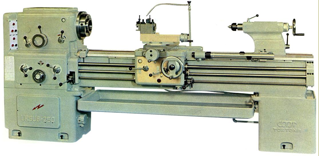

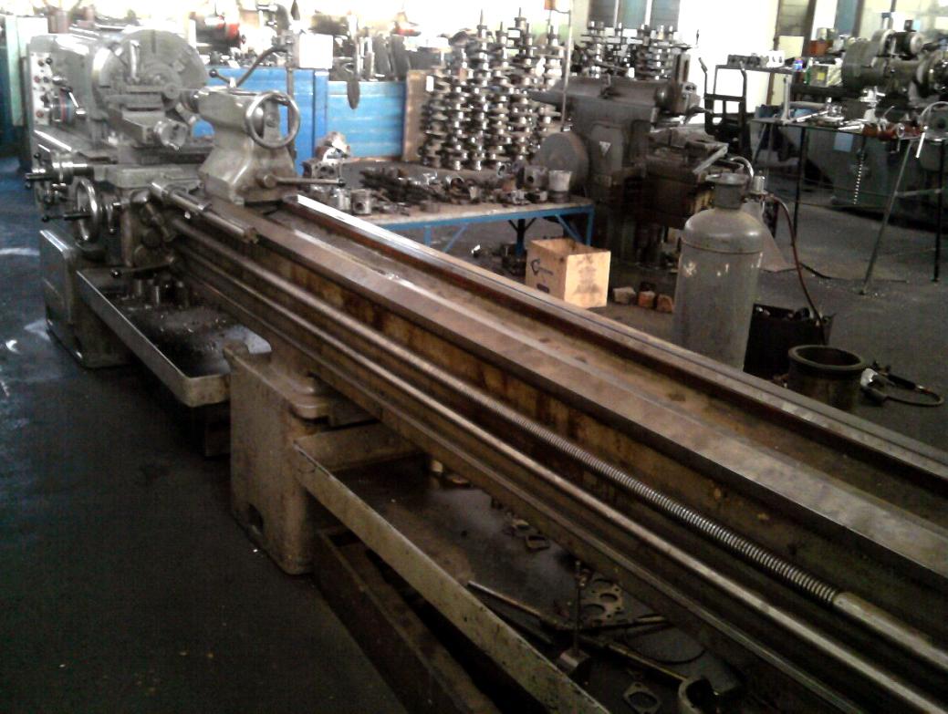

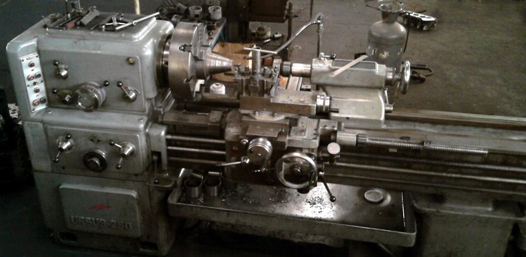

Ursus 250 with 105 mm spindle bore

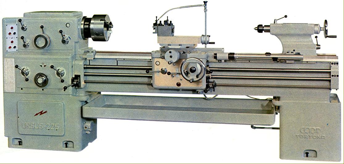

Ursus 225 with 52 mm spindle bore

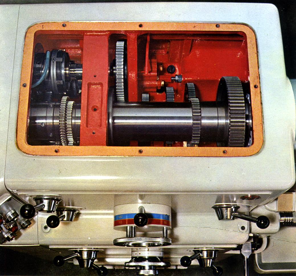

Inside the headstock of the 52 mm bore model
52 mm bore spindle with its Gamet bearings
Inside the headstock of the 105 mm bore model
105 mm bore spindle with its Gamet bearings
Ursus 250 lathe with 105 mm bore spindle
