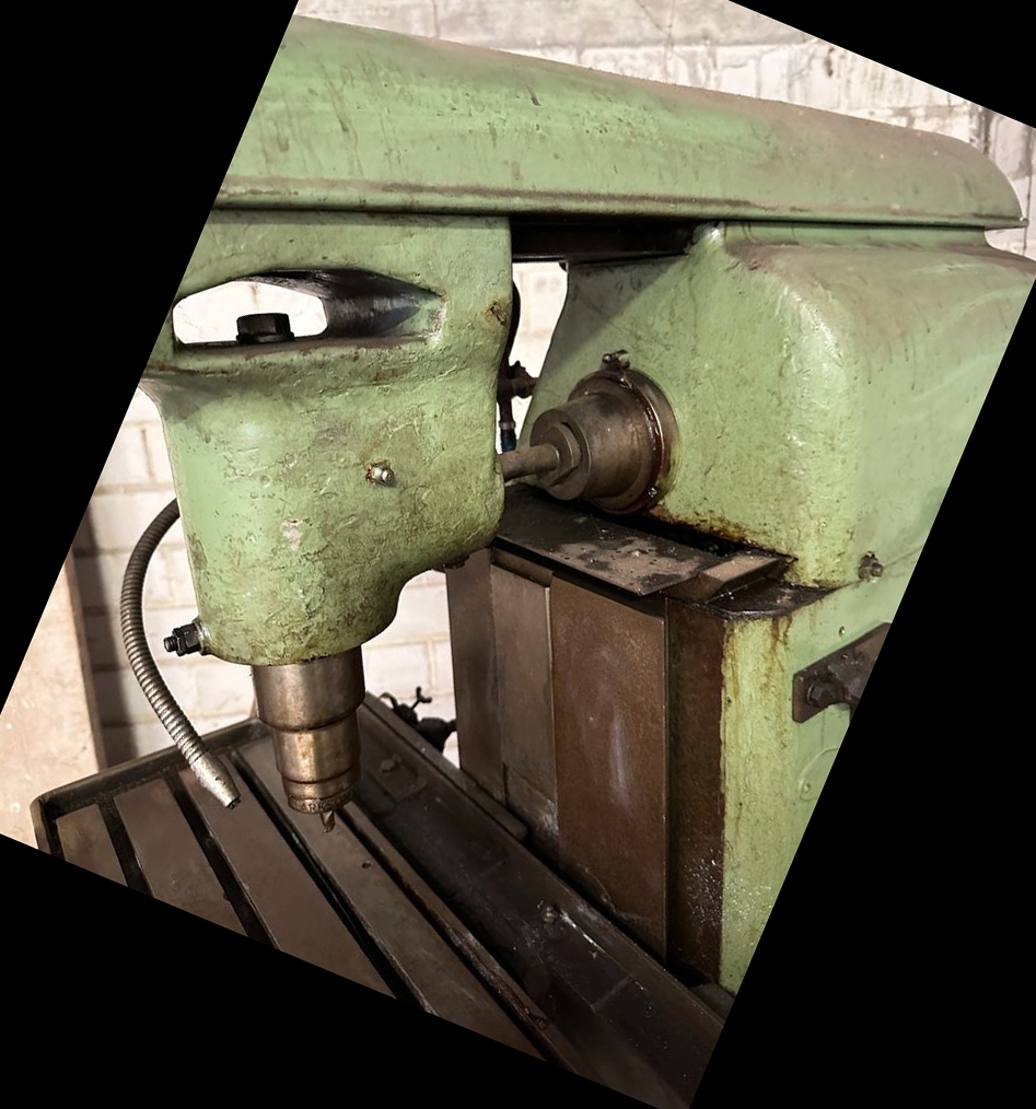

Although carrying a plate proclaiming the maker as Hahn & Kolb, this was not the case as they were not manufacturers, but a large German machine-tool organisation not dissimilar in many respects to the English Herbert Company who factored and distributed those from many other companies. In some cases, so close an alliance was forged that machines lost their original identity and were badged Hahn & Kolb - for example, the "Variomat", a machine of similar type to the one shown on this page.
Arranged along the lines of the precision universal
Deckel FP Series and Thiel and Maho types, the "Hahn & Kolb" shown below did not have a conventional knee. Instead, on the front surface of the column was a flat vertical surface that carried that most essential of all accessories for this class of miller, a table that could not only be tilted each way from horizontal but also, as it was mounted on a two-axis swivel, positioned at almost any angle desired.
One limitation was that the entire assembly of table and swivel brackets could only be moved horizontally or vertically (though this was also the same for Deckel-type models) while the in-and-out feed was by moving the head - a massive casting sitting atop the main column - using a handwheel that worked through a direct-acting screw.
Flange-mounted against the rear of the main column, the two-speed motor drove both the table feeds and either a horizontal spindle or a simple, non-swivelling vertical head.
Horizontal feed was both by a hand-turned screw and power, the latter having eighteen rates of feed (from 2.1 mm/min to 193 mm/min) produced from a combination of the two-speed motor and a 9-speed, a two-lever gearbox mounted on the right-hand face of the machine's main column. The power drive seems to have been through chain and sprockets, this perhaps connecting to a rack machined into the bottom edge of the "knee" - though exact details of the details of this arrangement are uncertain.
A very useful range of 12 spindle speeds was provided, a 3-step belt drive and the 2-speed motor giving 57, 74, 108, 171, 222,324, 450, 640, 931, 1470, 1920 and 2793 r.p.m.
If the miller was also available with other types of head as commonly found on other makes is not know, but if they were, might have been of the following kind as seen on Deckel machines:
- swivelling with a fine-feed or rapid-action drilling quill
- long-reach with its own motor
-  angular spindle designed to assist with the milling of hard-to-get-at sections
- slotting
It is unlikely that the maker was able to offer alternative tables such as a more rigid plain horizontal type as, unlike other machines of this type, the "knee" was not a vertical surface fitted with T-slots, but a single, permanent fitting. Nor, apart perhaps from rotary tables, would other useful accessories have been available such as vertical indexing units and gear-cutting attachments..
