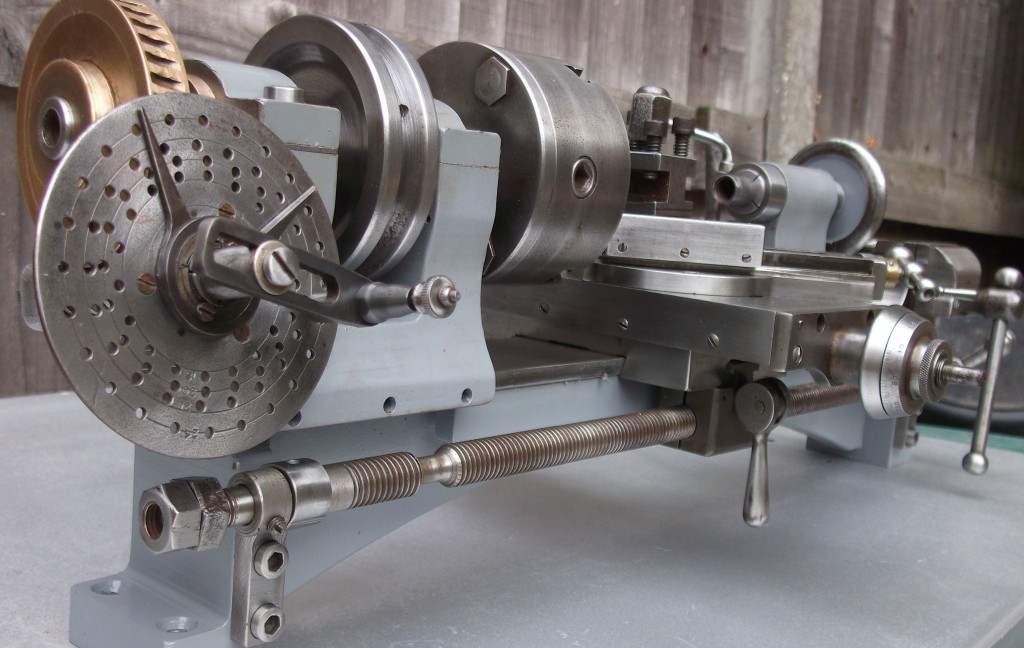

Yet another traditional "bench precision" lathe of unknown origin - this having a centre height of 2.5" and taking around 8" between centres. Of an interesting design,, the lathe is of high-quality, heavily built and fitted with a full compound screw-feed slide rest. An unusual fitting - also found on the American UND lathe - is a worm-and-wheel driven headstock spindle indexing attachment complete with an indexing plate. Also original to the lathe is a small vice - complete with a small "anvil" section - that clamps to the tailstock end of the bed.
As the single-groove headstock pulley (complete with a circle of 60 indexing holes) is original, the lathe must have had, when new, a multi-speed countershaft unit - this being lost. Shown in the first set of photographs in as-found condition, lower down the page it can be seen as restored.

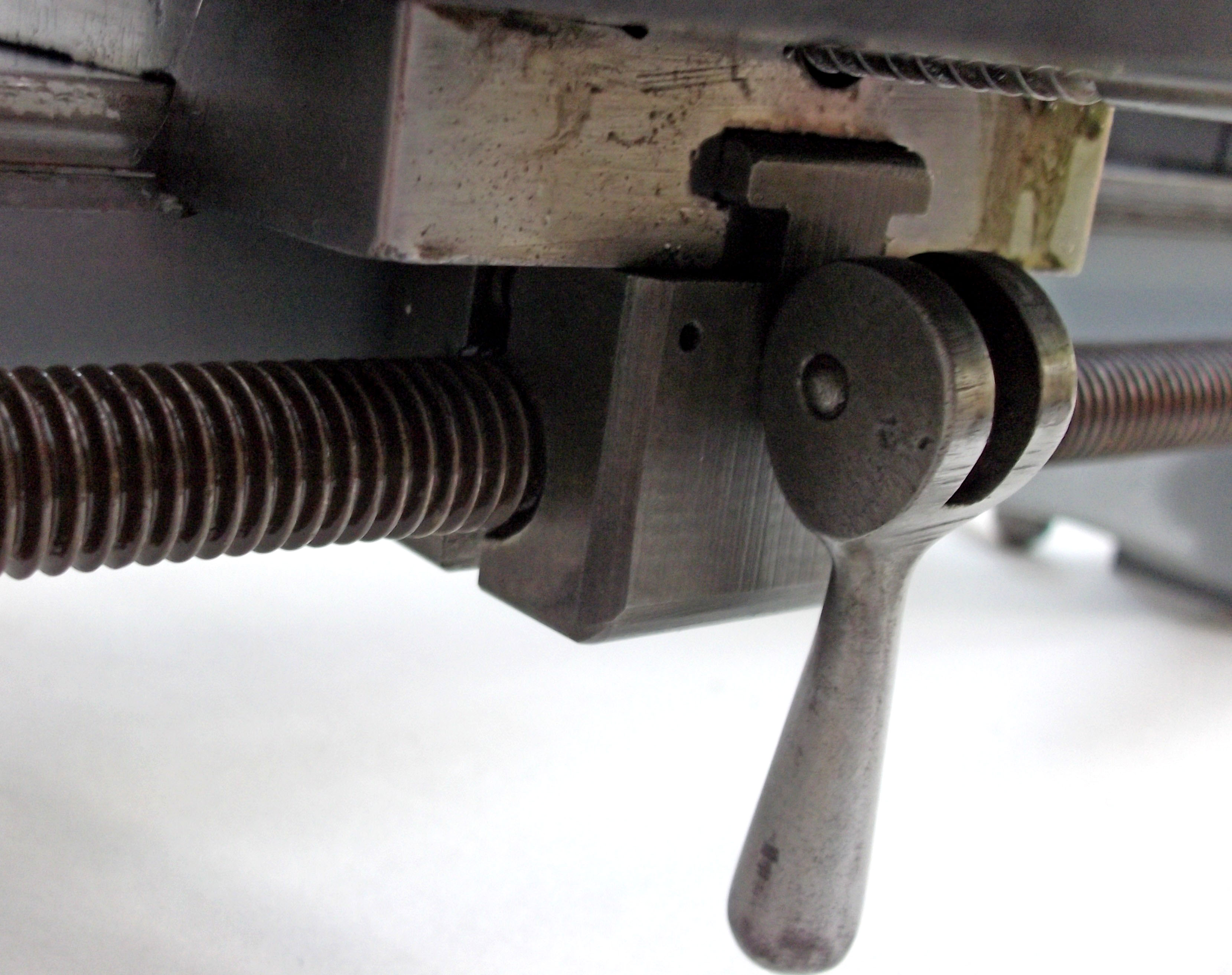

The 12 t.p.i. leadscrew is clamped to the cross-slide with a cam-locked pair of half-nuts running in the cross-slide's bottom T slot. It, and the tailstock screw, have right-hand threads giving what used to be known as a "cack-handed" action where turning the handle clockwise results in the unit moving backwards instead of forwards. All very well if it's the only lathe that you use, but potentially disastrous if other lathes are in the workshop.

With its square-form worm screw, the indexing assembly engages with the 40T pinion with near zero backlash. The worm runs in a U shaped casting that attaches it to the headstock and the index fingers have a leaf spring friction pad. The index pin is sprung loaded
