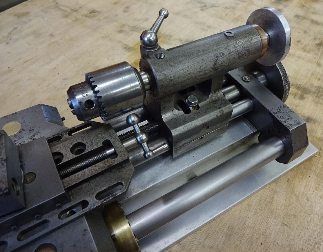

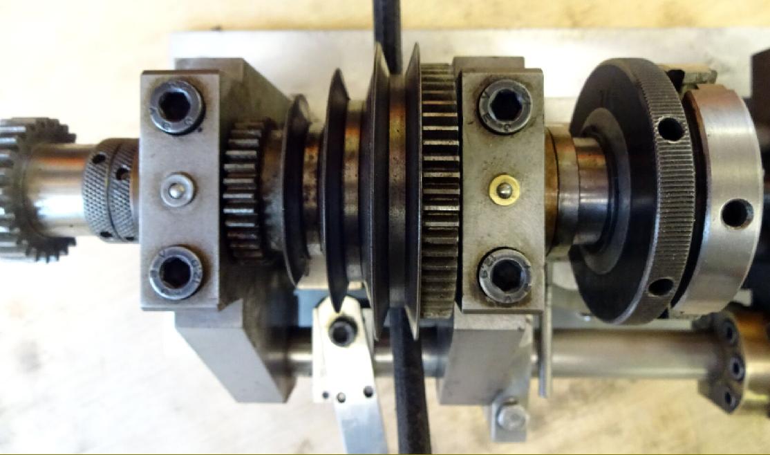

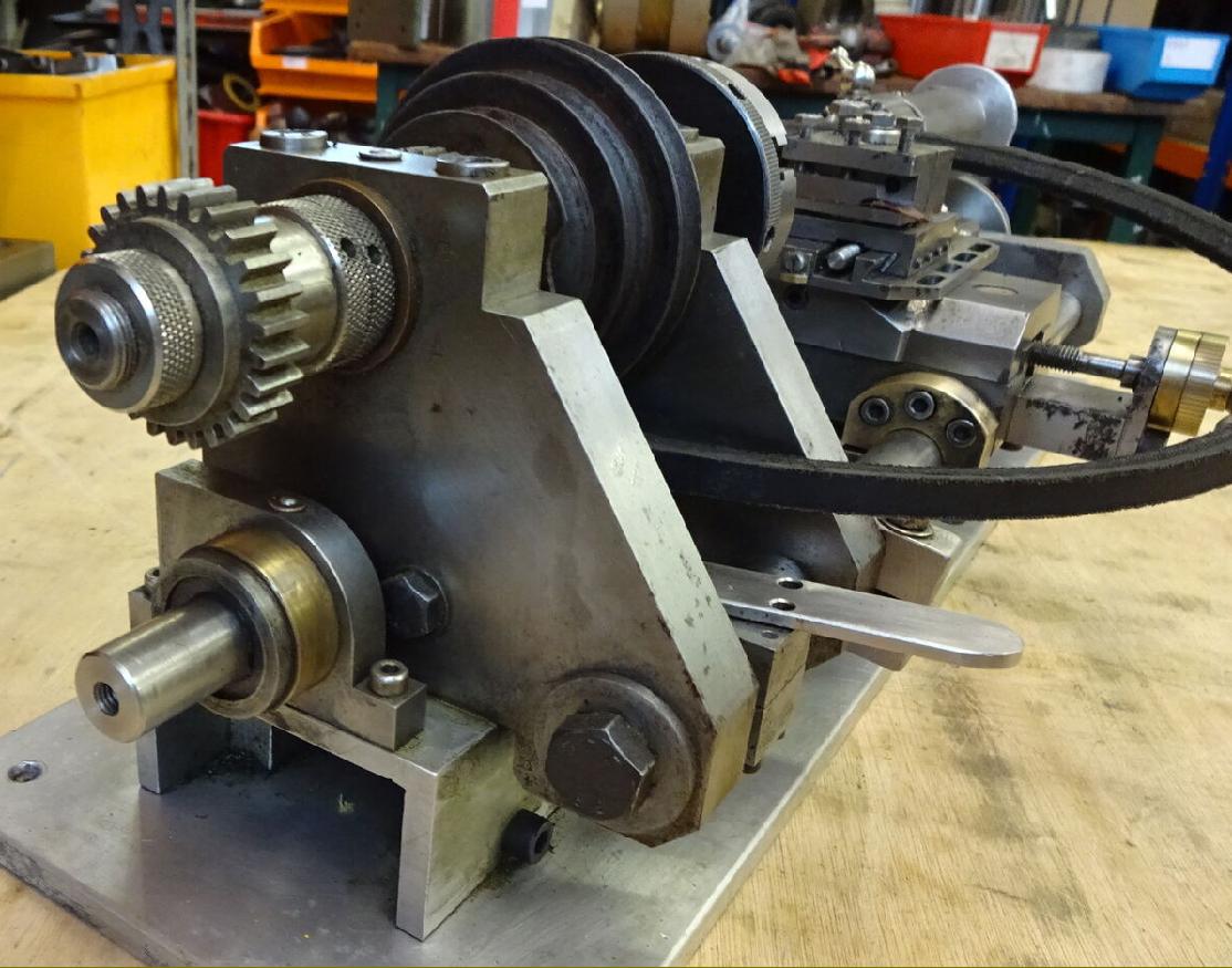

The second example of this backgeared and screwcutting lathe to be found - the first being in rather less good condition. With an odd mixture of design points, the lathe has a simple, three-bar bed; a smaller diameter rear pair (with the dog-clutch equipped leadscrew set between them) used to support the leadscrew and rear of the carriage while, at the front, a much larger diameter bar passed through a huge bronze bush that formed an "apron" for the carriage. While bar-bed lathes are relatively common, those that used three bars to support the tailstock and carriage are far fewer, with only two known to the writer - the French Siame and the Swedish Almkvist.
Apart from the cast-iron cross slide on one machine - which might be a cut-down part from a Boxford - the major parts of both examples appears to have been constructed from blocks of steel milled to the required profiles. Even the tailstock might have been so created - quite a job without access to specially-made profile milling cutters.

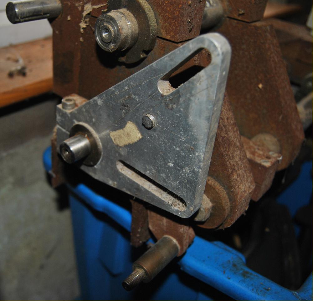

Unfortunately, on the first example of the lathe shown below, the rear-mounted backgear shaft is missing - though as this was carried by a pair of brackets bolted to the rear face of the headstock, should not be too difficult to reinstate.
Could this unknown lathe have been a "short-run" special by an established company (it certainly looks to have been well-made) or one of those "night-shift" jobs that were once so popular?
A second example: not so well preserved, but part way through careful restoration
Visible between the rear pair of bed rails is the leadscrew dog clutch
Is this a reversed, cut-down cross slide from a Boxford lathe?
