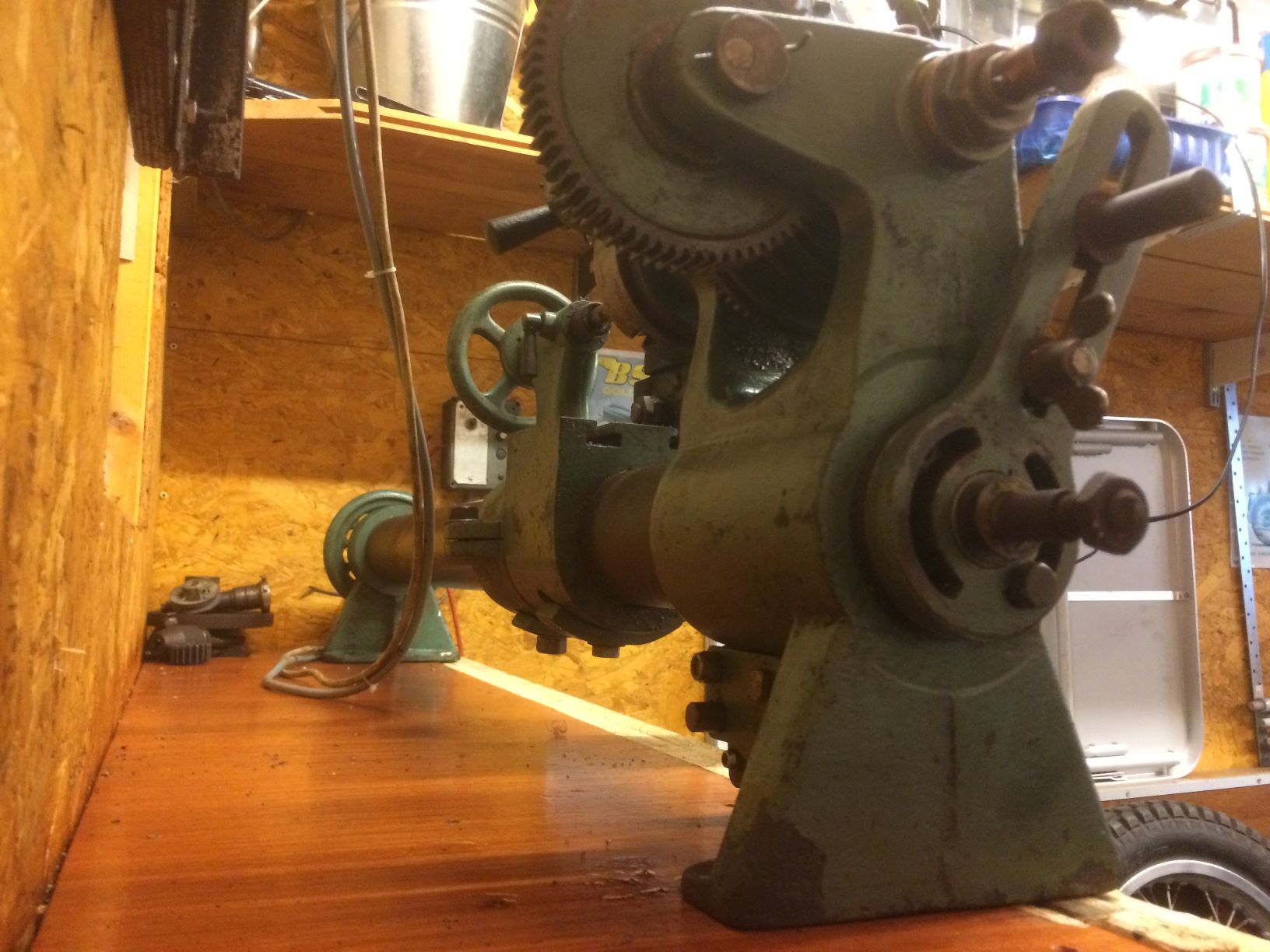

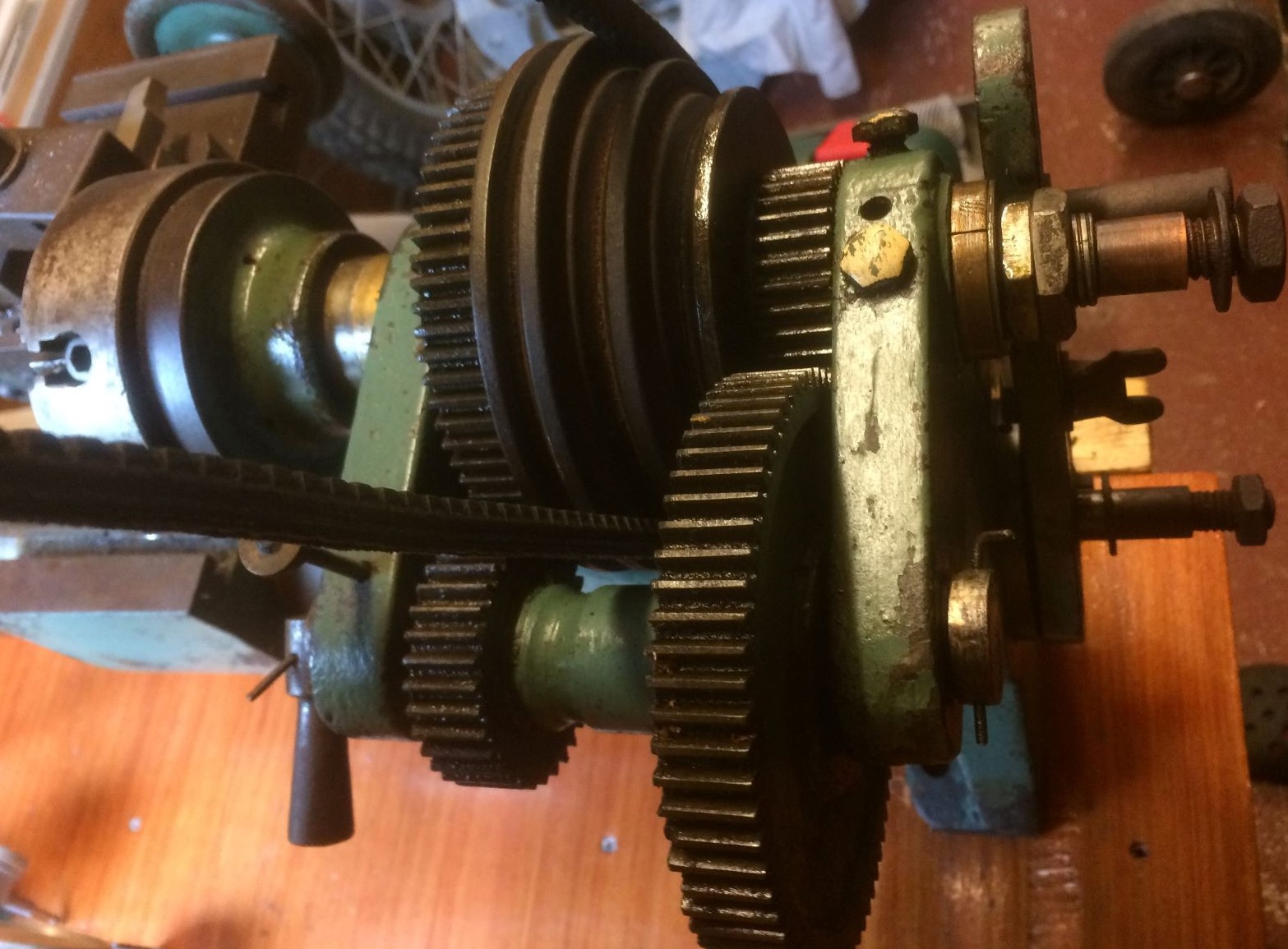

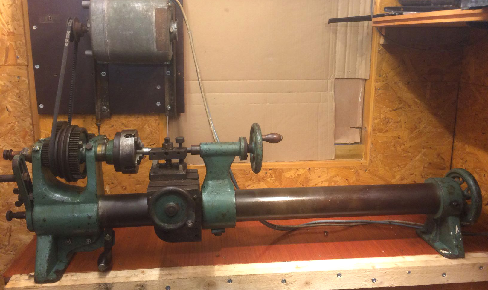

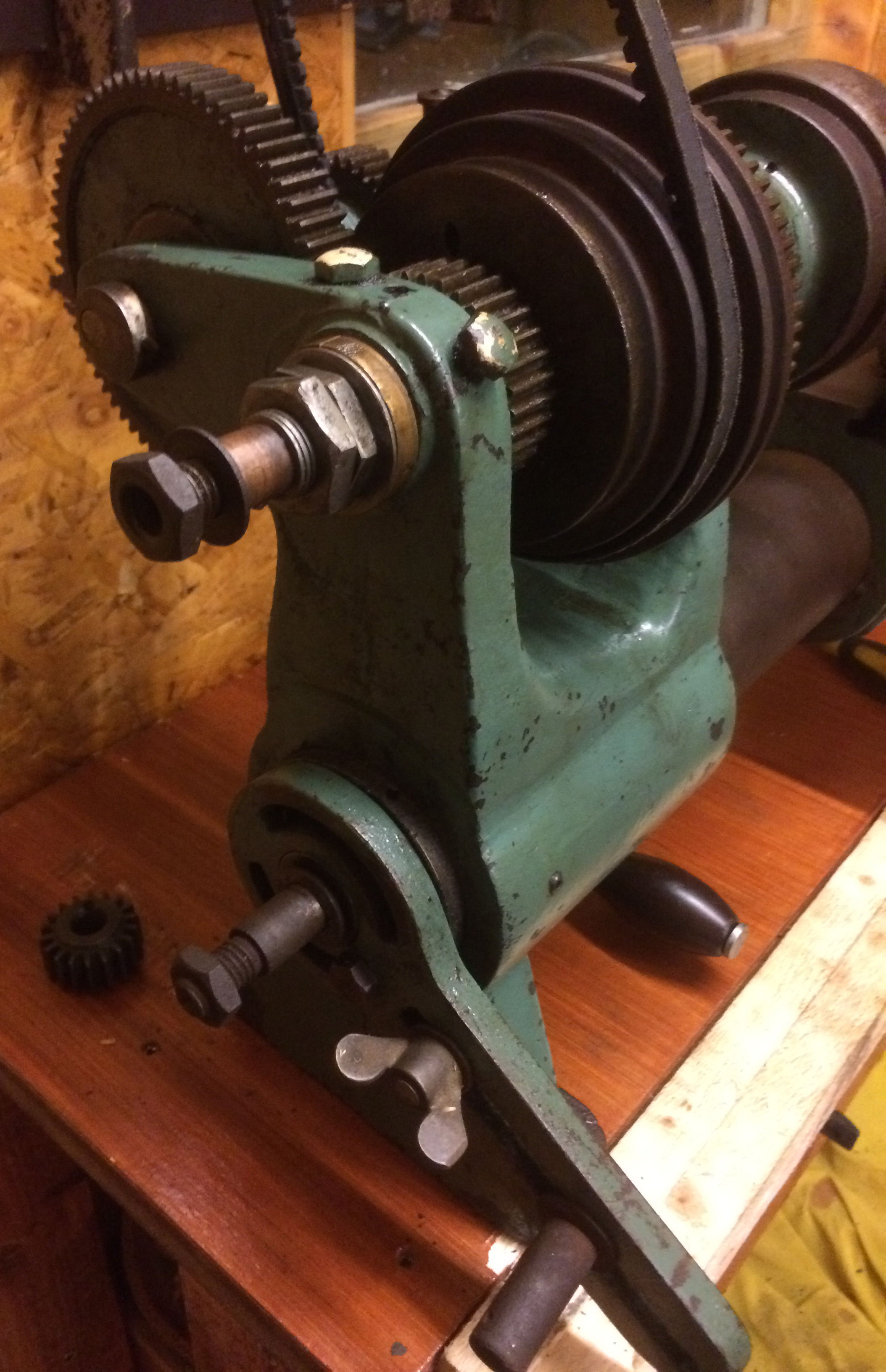

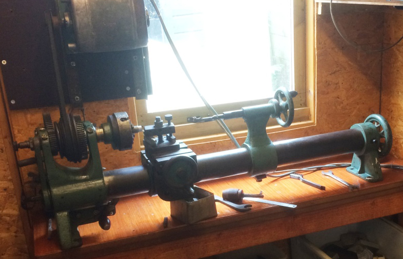

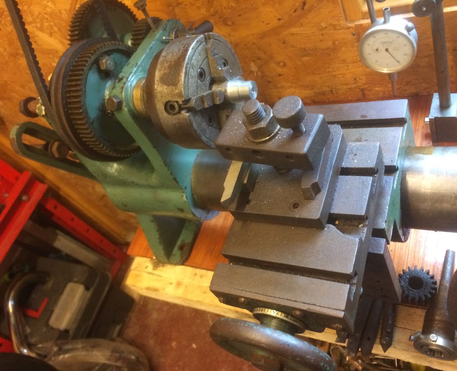

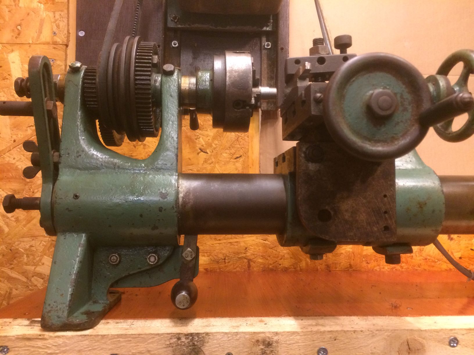

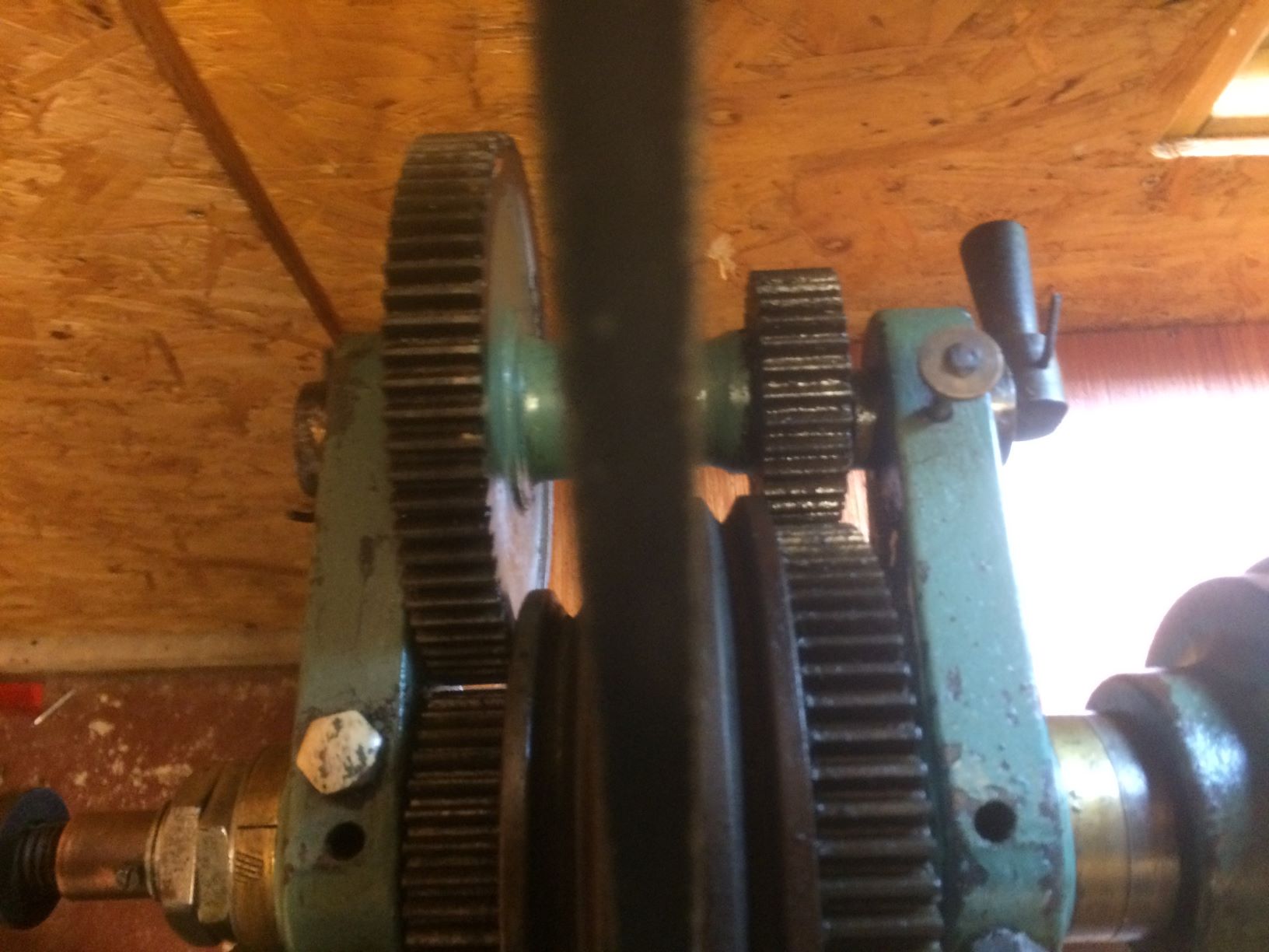

Looking very much like a Round Bed Drummond (as well as the Fogg home-built round-bed) and fitted with a speed-reducing backgear, this is suspected to be a lathe built from a set of castings available during the 1920s and 1930s. Both before and a little after those decades, several designs for the home construction of a lathe were published in various magazine including the English The Model Engineer. Several machines of this type turn up each year, though none carry a maker's name, and it's a testament to the original builders that many are both well-finished and still in useable condition.

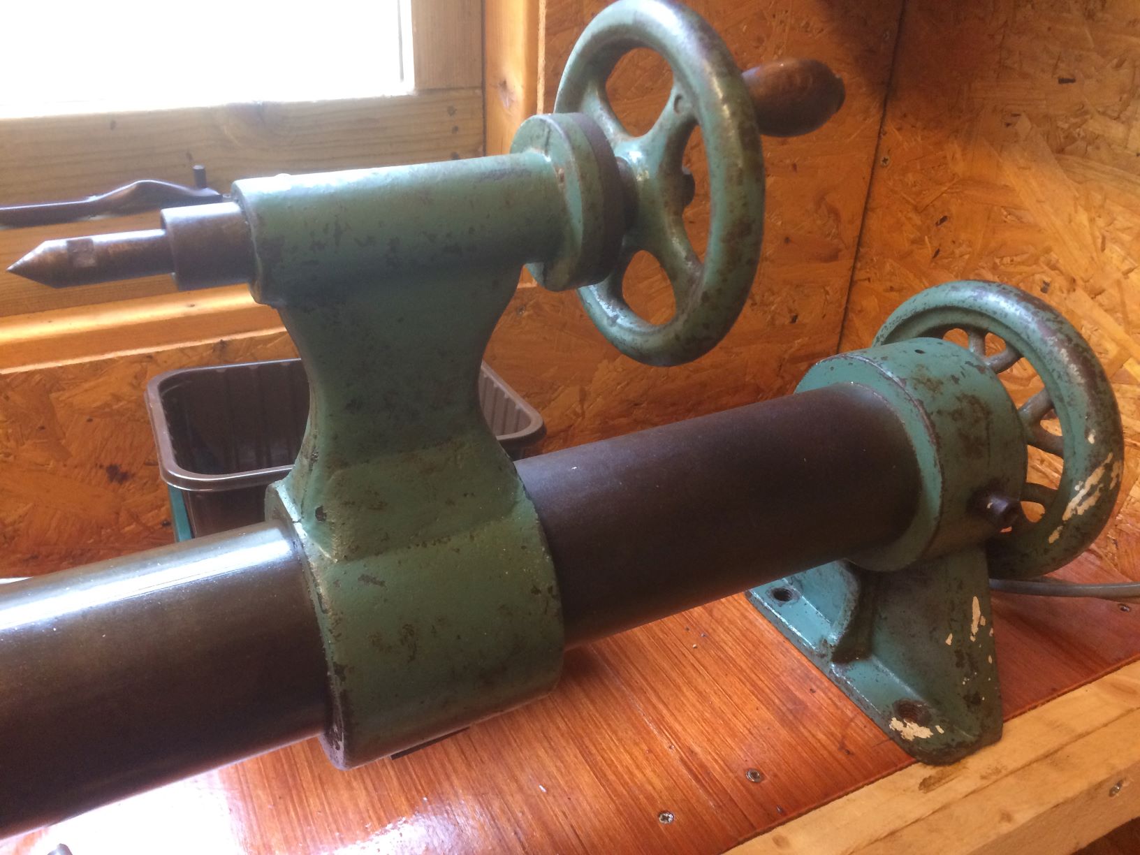

On the machine illustrated below, one puzzle is the 3-inch diameter, 31.75-inch long ground-finished bed - this surely being beyond the means of an amateur builder to grind. The most likely explanation is that this would have been supplied as a finished item.
With a centre height of around 4 inches - and taking up to 24 inches between centres, the lathe does have a tailstock and saddle looking very similar to the Drummond type, but with the T-slots in the saddle casting running (like the Fogg) from side-to-side not front-to-back. The tailstock spindle has a diameter of 7/8" with 2
3/8 inches of travel.
Unfortunately, the lathe has several small parts - but the owner reports that it turns with remarkable accuracy and is still a most useful machine.
Was it home-made, or factory-built? We shall never know - unless an advertisement extolling its virtues and glossing over the complexities of building it is discovered.
