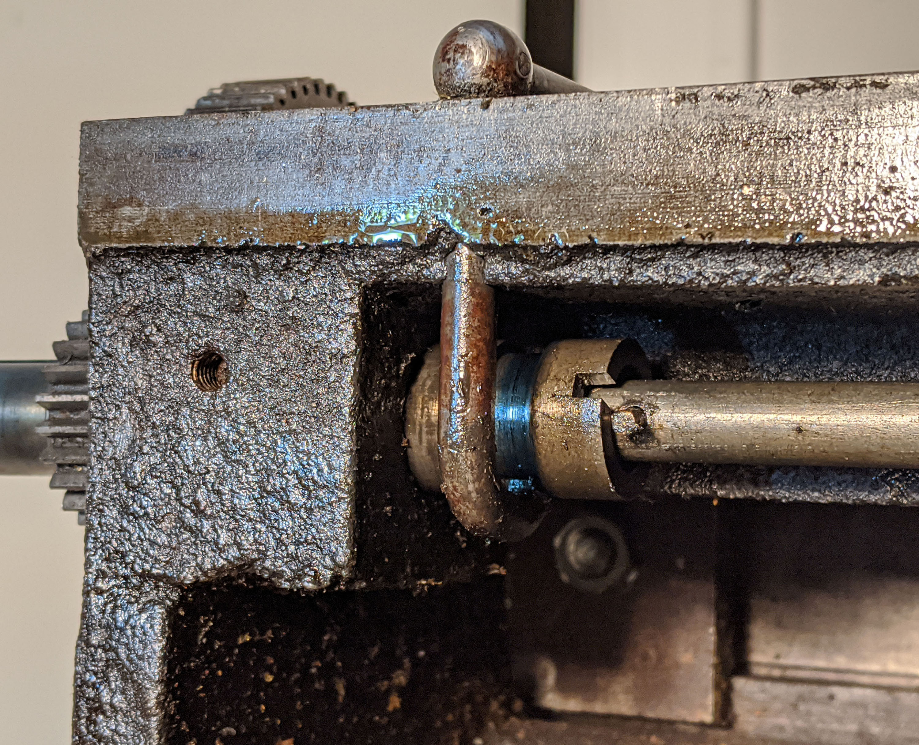

View beneath the bed shows the mechanism used by the lever used to select engagement of the leadscrew and power-feed shaft

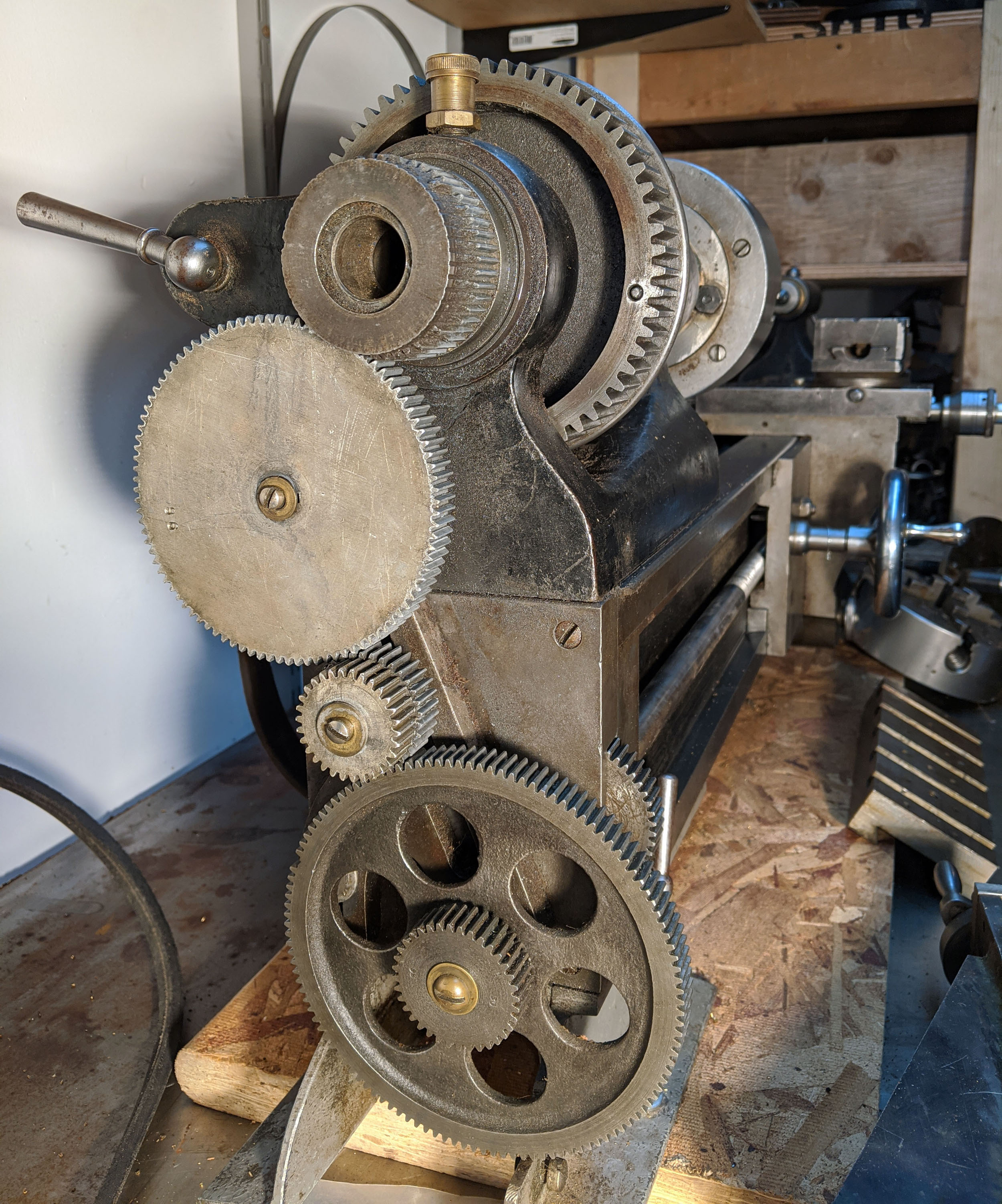

Inside face of the changewheel-carrying bracket
Outside face of the changewheel-carrying bracket
