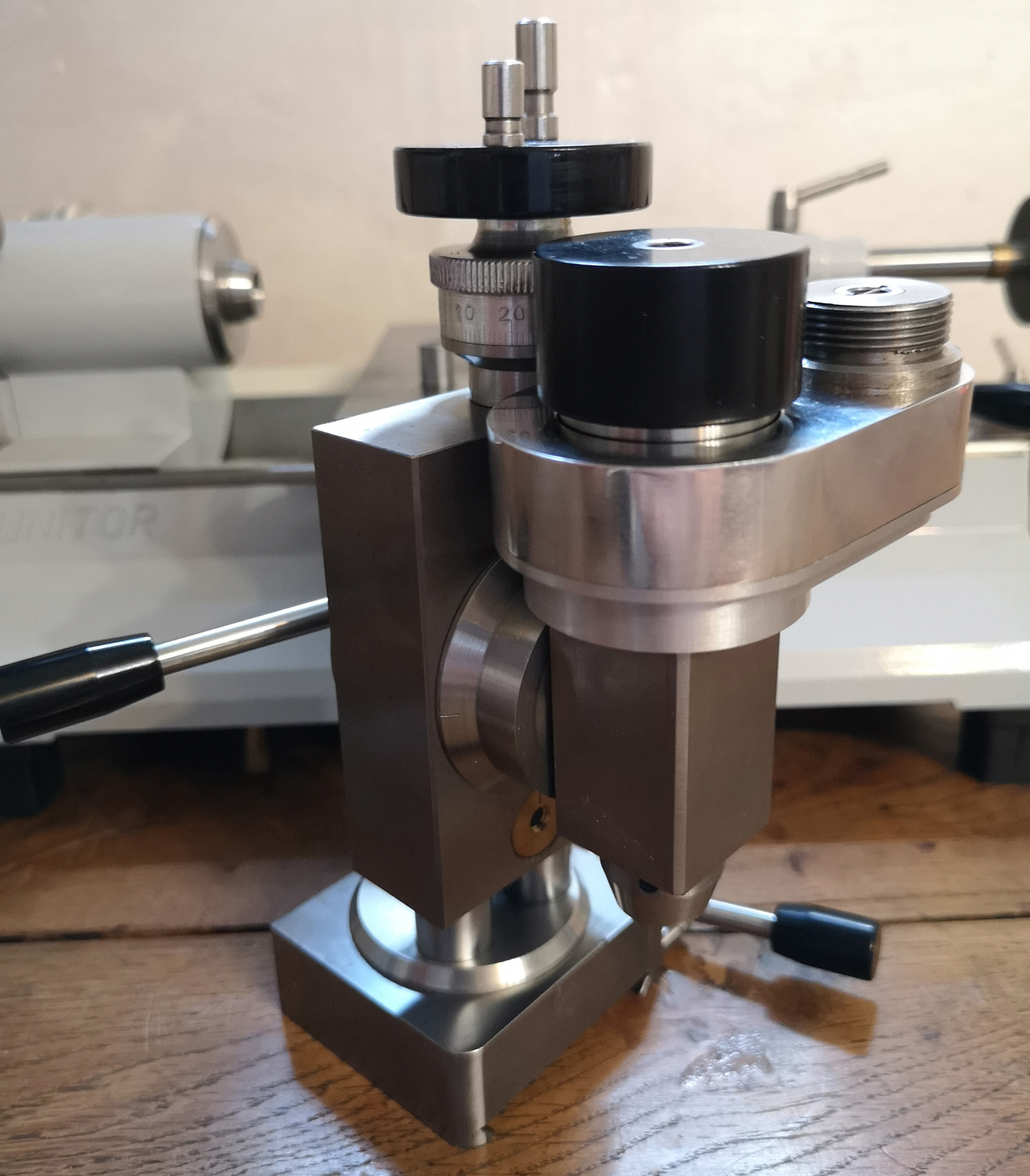

The lathe is available in two versions, Standard and Super - the latter with a milling slide and high-speed milling and grinding head as part of its standard specification. Ingeniously, instead of being driven by a traditional "overhead" with a round belt, on the Unitor the drive to the high-speed head is by a flexible cable connected to a 2-step pulley mounted on a steel plate, bolted to the outside face of the headstock, and shared by the flange-mounted DC drive motor.

High-speed milling and grinding attachment - note the ingenious drive system used
