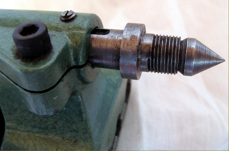

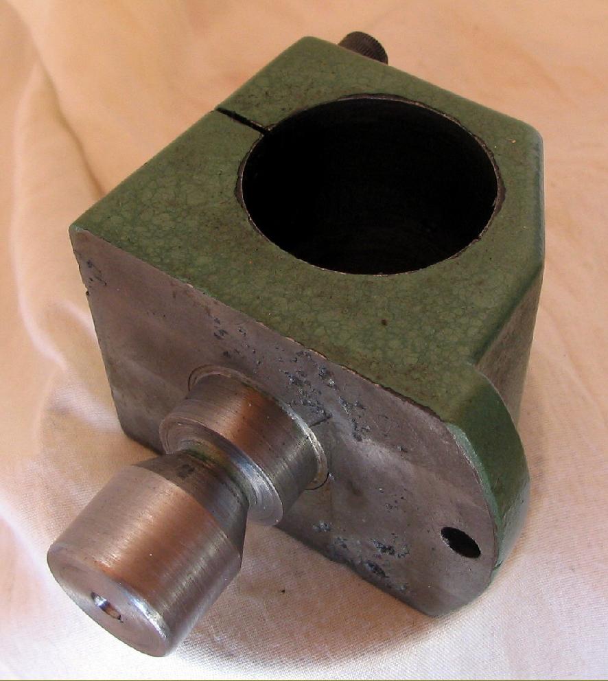

Of all the parts the tailstock proved to be the most difficult and, in hindsight, I wish I had never bothered to copy its curvaceous lines - flat sides would have made it so much easier to jig and machine the three critically parallel holes - plus a 3rd. for the barrel-advance screw. As a result the job was slightly out, and I had to make a small adjustment to the height using two grub screws to bear against the bed bars.
