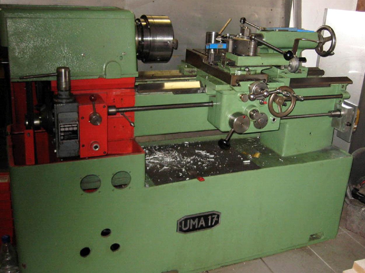

Shown below are two UMA lathes, one (painted grey) is a typical UMA lathe from the 1950s, a Model 15 and, at the bottom of the page in Green, a UMA 17, also from the same era. The Model 15 had a 185 mm swing, a generously dimensioned bed and a control system that made it perfectly suited for the series manufacture of small parts. It could also be pressed into use as a general workshop lathe, though screwcutting (it lacked a leadscrew) was not fitted - exactly like the heavier German Magdeburg production lathe.

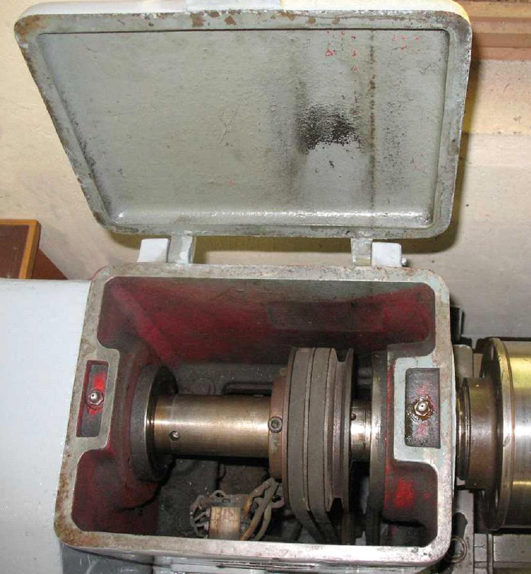

Inside the headstock: as the drive mechanism was below, inside the stand, this was a simple affair

A UMA 17 lathe from the 1950s
