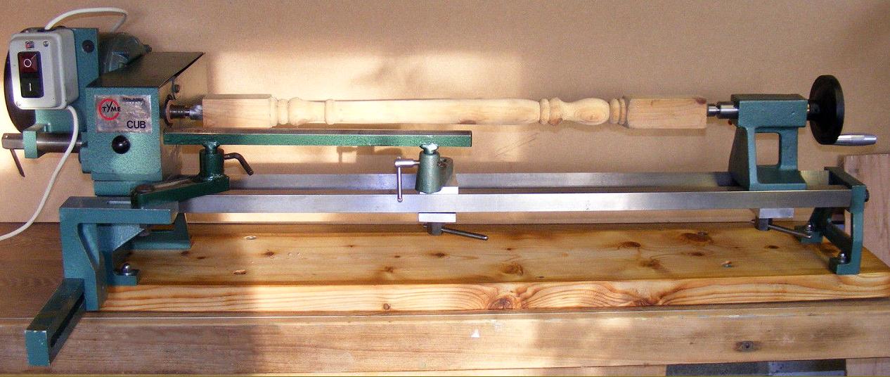

Tyne "Cub" woodturning lathe. This example has the block beneath the headstock that allows the latter to be swung to face forwards for bowl turning

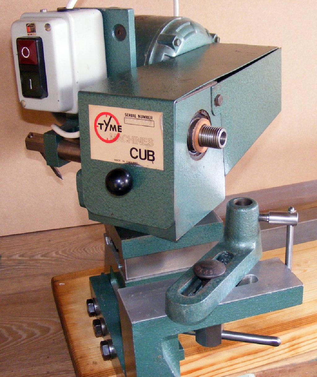

Cub Poly-V drive system
