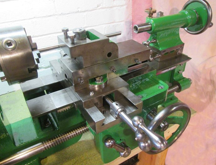

Arranged so that the cross slide was situated at its extreme left-hand end, the saddle was of considerable depth front to back and fitted with T-slots in both right-hand wings. The left-hand side  of the saddle had no wings, just a plain face, with the top of the casting protruding well forward - this arrangement allowing the cross slide sufficient travel to turn the very largest diameters that the bed gap was capable of accommodating. Single-sided, but strongly constructed, the apron held reduction gearing between the very large-diameter handwheel and the bed rack - an improvement on the direct connect and crank-handle fittings that would have been commonly found twenty years earlier on this class of machine.
Equipped with a proper compound slide rest assembly, the cross slide had is ways "sunk" into the saddle - another design quirk found on some early lathes (and even much later ones such as the 17-inch Harrison)  that allowed swarf to accumulate with unaffected ease in the gap so formed.
Although the original changewheel studs are missing, the retaining nut on the end of the leadscrew is present, this resembling those knurled-edge, screw-on types found on early Drummond small lathes. Held to the bed by just two bolts each, at a first glance the leadscrew hanger bearings appear to be insufficiently rigid - however, the design was not as flexible as it looks for each was also located by diagonally set dowel pins.
Of conventional design, the set-over tailstock had a barrel that ran right through the casing, its end section threaded and passing through a large-diameter handwheel secured by two semi-circular plated held in a turned groove (this design also being used on the Myford ML7). The barrel locking arrangement was by a proper "split barrel" arrangement - a far better solution than the crude "close-down" slot cut in the casting that might have been expected. If you have a Turnell & Odell lathe, the writer would be interested to hear from you..
